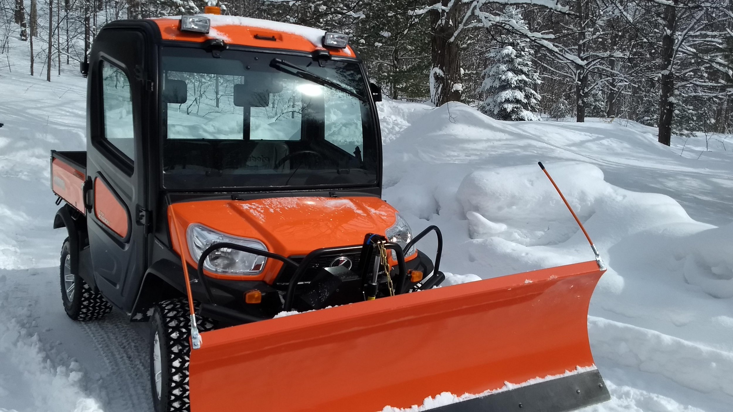

Have you considered the Kubota RTV-X 1100C with the front PTO K-Connect blower/plow system? We don't get QUITE as much snow here in northern Michigan as you do there, but 200" or so of lake effect snow isn't at all unusual. I have an RTV-X 1100C, but I couldn't bring myself to spring for the K-Connect system (it's expensive!) when I bought my machine. I just have the Kubota-branded plow and although it's a great plow, when you get to the end of winter you usually end up with the banks pretty high and our little 900' long private road getting narrower and narrower. I think I'm going to buy the K-Connect system and get it installed over the summer so I'm ready for next year. I know this- on a 15*F morning with the wind howling and the snow coming sideways (like today), it's awfully nice to be dealing with the snow from the comfort of that heated cab!
