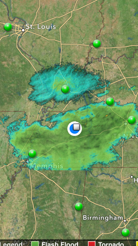

Everybody must be inside today! So many replies so quick.
Here is what I have today.
