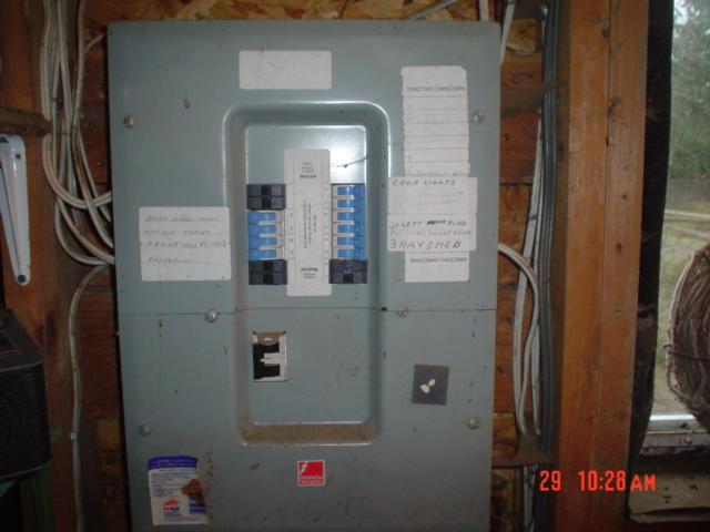

/ How far is too far?? #28
RxRatedZ71,
I used the Wire Size Calculator that Tom gave the link to.
Load Calculation
Overhead lights 15 A
Refrigerator circuit 15 A
Space heater circuit 15 A
Circuit for other outlet 15 A.
Total: 60 A at 120V
Solution
You could run a 240 V line (3 conductors plus ground) to your barn from a 30 A 240V breaker in your house panel. The 240V line will actually provide you two 120V lines at 30 A each for a total of 60 A at 120V which is what you need. Put the refrigerator circuit and space heater circuits on opposite 120V legs of the 240V wire to balance your load and to minimize voltage drop. Using the online wire calculator:
120V, 30A, copper, single phase, 265'
Wire Size
You need a #2 size copper line between the house and your barn and you will be fine. If you go with a smaller wire, you will have voltage drop problems at the barn which will cause problems and could damage your equipment (especially the compressor used by the refrigerator). This design does not require an extra meter as you requested. However, doing it this way will have an up-front cost of paying for the large #2 wire.
If you were willing to pay for the extra power company meter at the barn, then you could run a much smaller wire (less cost) to the barn because you would be running a high voltage line which would be stepped down to 240V/120V using a transformer close to the barn.
Note: I have an electrical engineering degree but am not a licensed electrician so get a professional opinion before proceeding.
Good luck with your project,
Obed

Rx. I have about the same uses as you are going to use in your new barn as I do now, and the same distances you are dealing with.. This is what I did and it works fine. Starting at my MDP "main panel" Feed breaker size 70amp. #2 alum. SER.. wire from the breaker to a pvc junction box in the basement where the wire is to go outside. Pipe out the back of the box to an 1-1/2 pvc lb on the outside of the building.. 1 1/2 pvc conduit.. "electrical conduit" to the barn and up into your main breaker in your new barn panel use #2 urd 4 wire in the conduit.
I also ran a black and white #10 copper to the barn for my block heater.. That way a half hour before I go out to plow snow I can turn it and an outside light on before I go out.
hr3 after some reviewing of Cu vs. Al prices the route you took would be my preferred solution in this case. The #10 copper solution for a light and block heater was awesome too.
Looked like 4/4 copper wire only today would run up to $2000. From what I here this would still be better than adding a meter base over time as long as one NEVER plans like heavy arc welding, etc. There are not good cheap options. No power would really limit the use of the nice new building.
