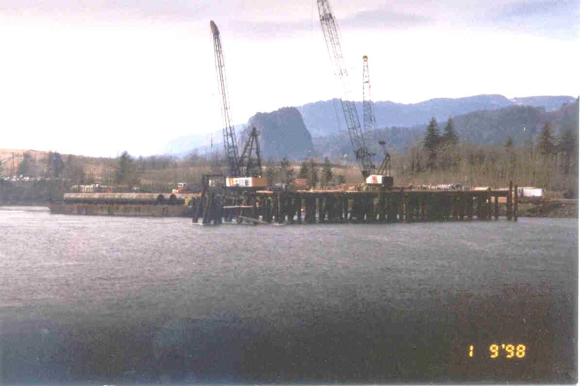

I built structures like this majority of my life. But off engineered stamped drawings. Without an engineered stamped drawing to work from, I think you're setting your self up for a law suit.

You can go as far out as you want, you just need big beams and more foundation. 10 people at 250lbs each, is only 2500 lbs.
your best bet is to get a engineer. your only limit will be your wallet
