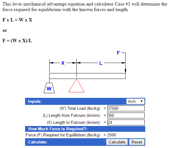

Think about this.... 10 fat boys (250 pounders = 2500# total) standing on the end of a 30' cantilevered pier can lift thirty seven thousand five hundred pounds only 24" behind a fulcrum.
Your gonna need a LOT of concreted to make it work or a longer lever behind the main pier.
From this on-line calculator...
Lever Mechanical Advantage Equation and Calculator - Case #1 | Engineers Edge | www.engineersedge.com

Thanks for the replies. The pond has a plastic liner and is fed by a well so the level is constant. It does does not catch any run off. Since it has a plastic liner the soil around it is dry. Anchoring or putting legs in the pond is not feasible without damaging the plastic liner.
58,000 lb of concrete is about $1500. Not a deal breaker if I need that much.
I definitely plan to over design it.
30' out puts it over about 12' deep water.
