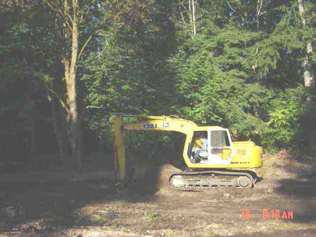

Our neighbor to the north has a spring in the back of their property. It drains south onto my two properties. I rented an excavator, and a crane operator friend of mine dug us a pond. It is cool to see the ducks swimming around in the pond. :thumbsup:

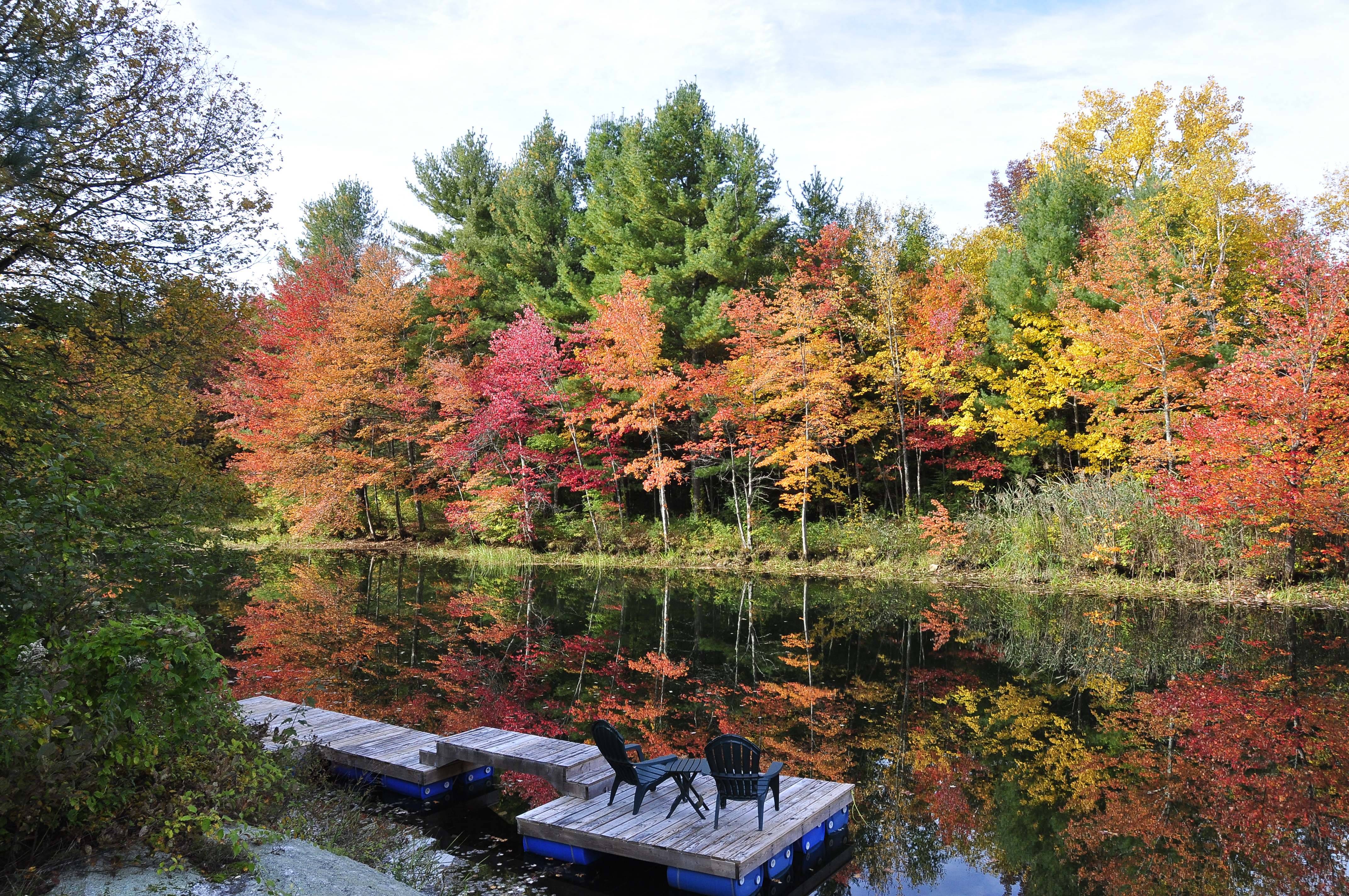

Pond/lake view:
