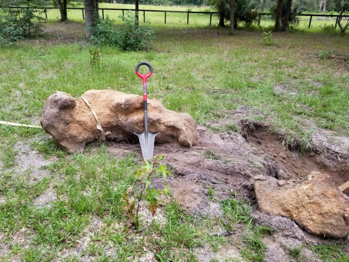

I tried to pull a big rock out of my yard with my Kubota L3710 and got nowhere. Today it occurred to me that I should think about getting a come-along.
So how hard can a 37-horse tractor pull? I don't really know. I can get a come-along that supposedly pulls with two tons of force.
I also have a Dodge with a 5.9 Cummins. They seem to do well against farm tractors, at least on Youtube.

Oh, it's mired all right.
Sometimes I wonder if it's the size of a house, and I'm trying to pull it out by one tiny corner.

Check this out.

There are some fully-exposed rocks in my yard way bigger than that. One is like a pool table.
