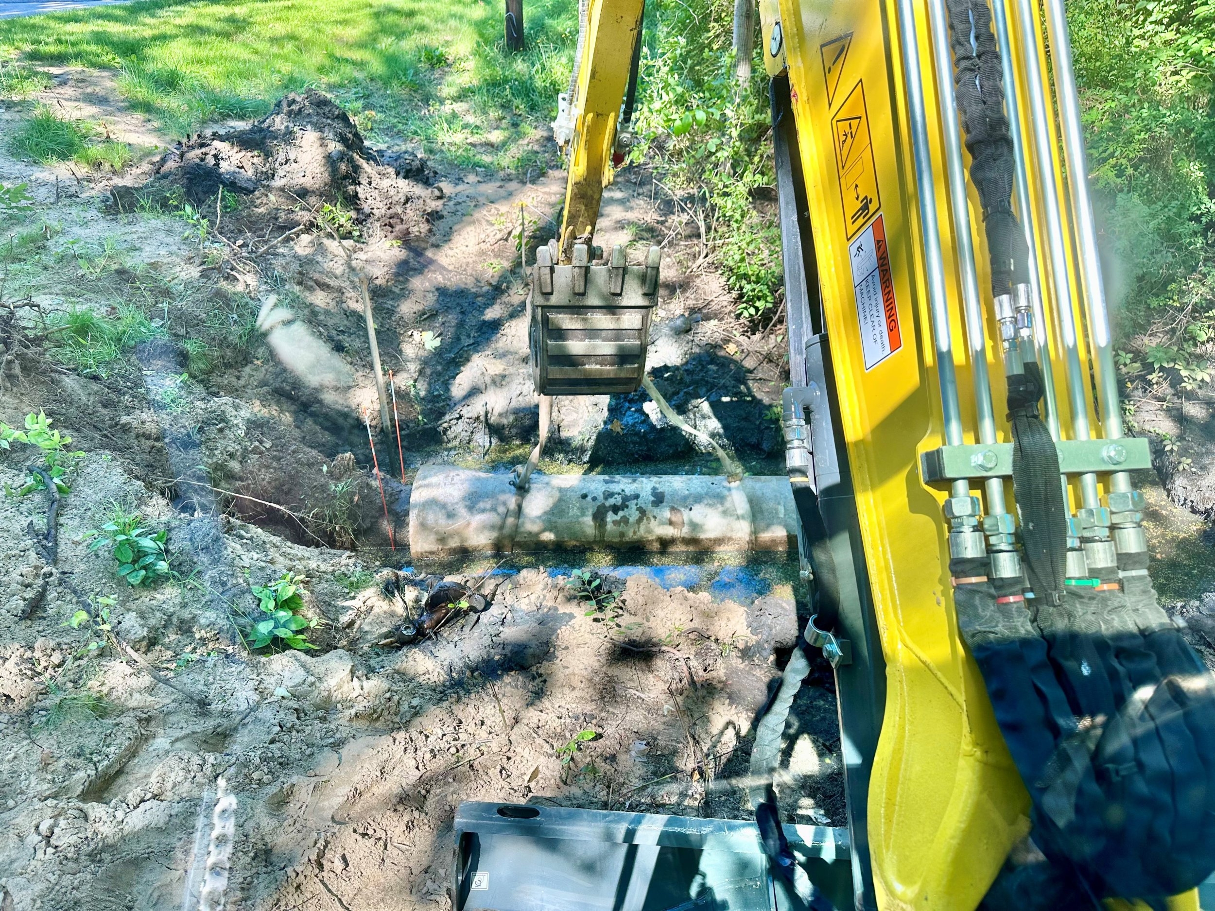

I rented this mini X this past summer and it was a breeze to operate. I loved every minute I had to use it, dug out my ditch, set in culverts and dug out 3 big stumps in the back with it. I was sad when they picked it up. :cry: I had no previous experience with a mini x, I would say it may be doable in a day if you stay on it, once you figure out a method with the stumps it should go pretty quickly.

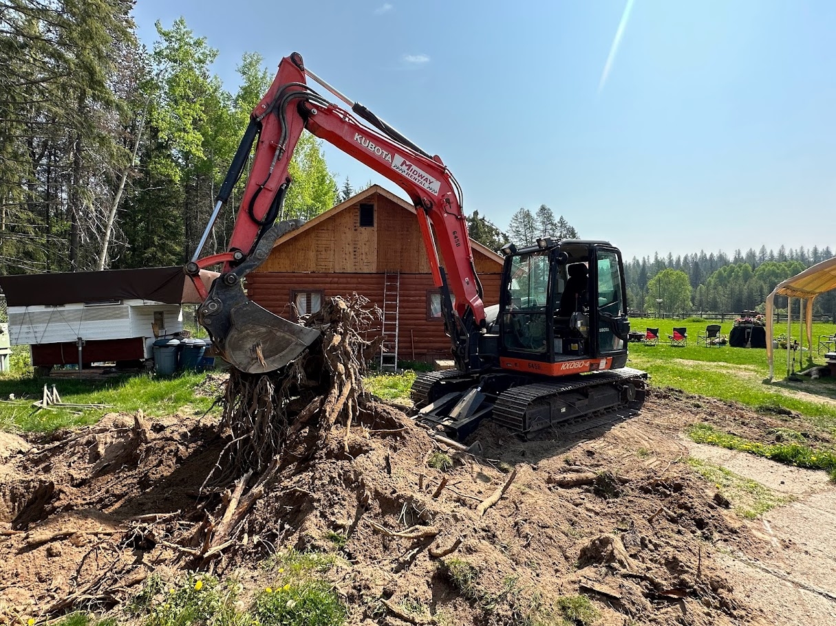

In my experience a new operator (who would have experience on loaders and other farm related equipment but no mini ex. experience) on my equipment would be expected to pull the 10 12" stumps in a day. I would budget 30 minutes / stump for 12" stumps on lighter soils depending on how green / smart the guy would be.
On 24" stumps or hard clay/rocky soil types 10 stumps of this size with a mini ex., new operator, 24" stump on hard ground would be a very very big day and unrealistic to expect an inexperienced hired man to do.
after 6 decades I could budget popping out of my softer ground 10 24" stumps in a day but thats a big day and I think I am pretty darn good with my excavators.
a lot will depend on what size of mini ex you be talking about, soil type, stump size, operator smarts and distance between stumps and working space around the stumps. I'm pretty good at identifying / breaking horizontal roots. Some I have seen really suck at it.
a 2,000# Cat mini ex (like the 300.9 series) versus my 12,000# 305 mini makes a really big difference.

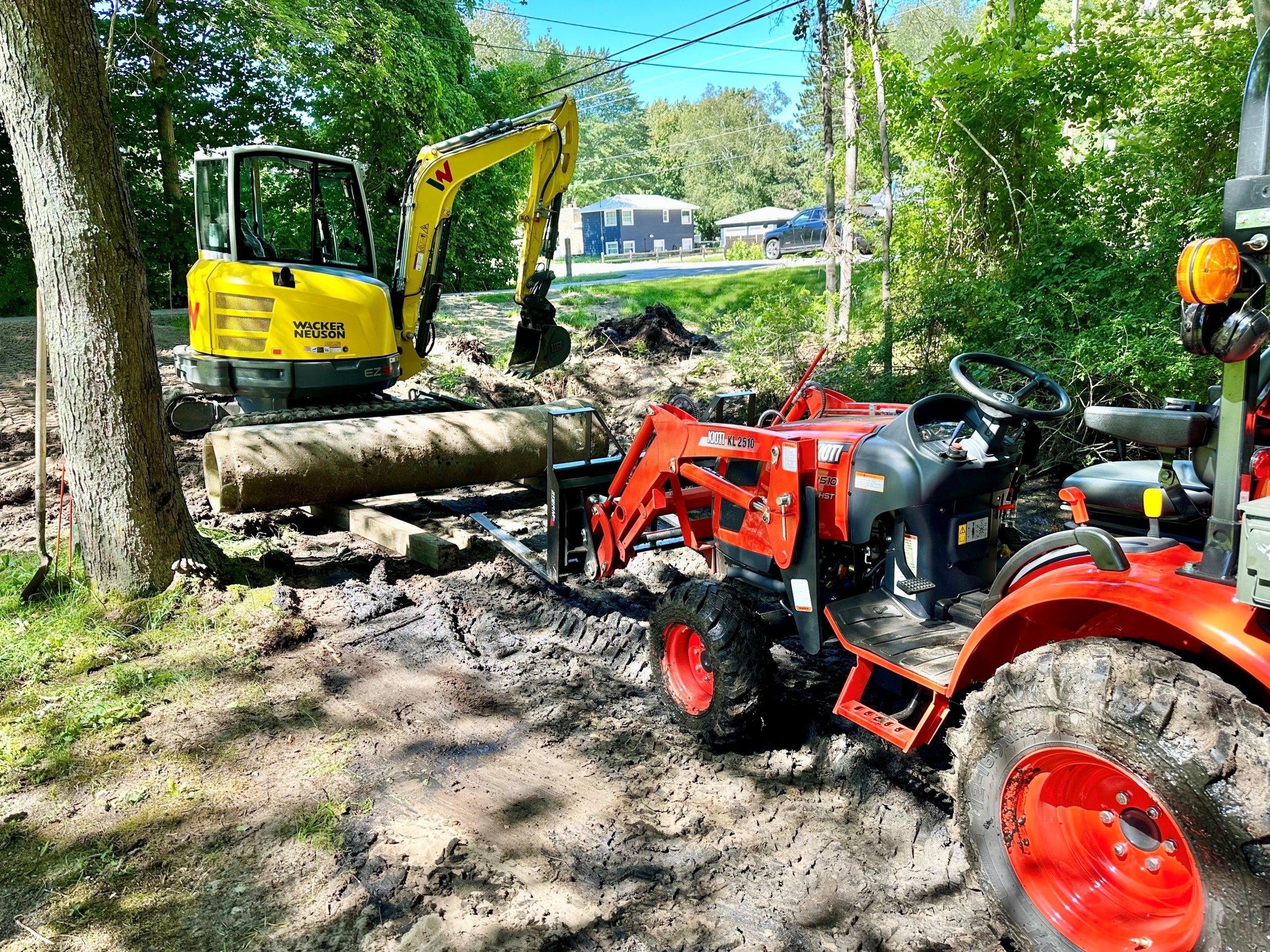

Pretty easy to operate. I rented one for a weekend expecting it to take much longer than it did. Dug out 112' length x 4' deep trenches for a barn foundation in a few hours (all sand), then yanked out some small trees, and returned it for only a 4 hour rental.
