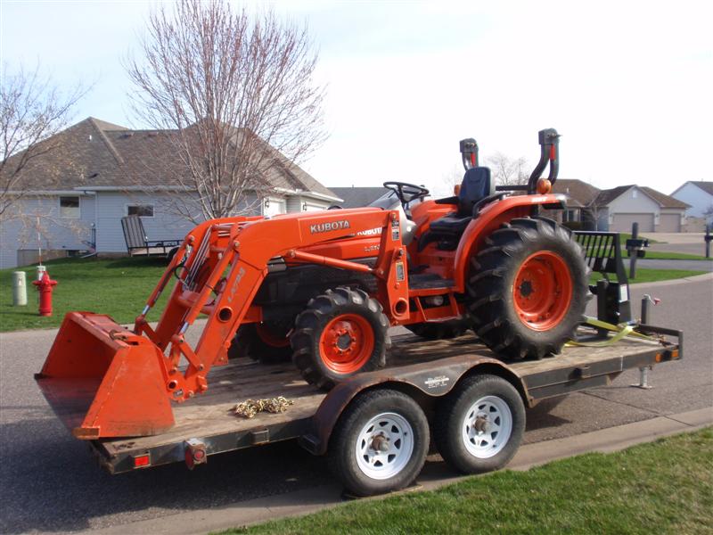

I have an L3130 with loader and no bushhog. It barely fits on my 16'. I wish I had a 20'. You are going to be hanging over even on a 20' with that setup. The other catch is if you have filled rear tires or not. That adds over 1k lbs to it. You will find that to tow that setup regularly, you will be overweight on a 7k trailer, and will need a 10k or bigger to stay under the GVWR of the trailer. Especially with filled rears. And if you are using a loader filed rears are a must, IMHO. Mine clocks in around 8000-8500, including the trailer (10k-16' lowboy dual axle), loader, filled rears and a skidding winch on the 3pt.
Also watch the hitch as with a regular weight carrying hitch setup, you will be over the rating on the receiver, if it is the stock Ford one. Double check that as they are rated 5k weight carrying, but a lot more (mine is like 11-12k) with a weight distributing hitch setup. I use a WD setup, but you could also buy a higher rated receiver instead.
To give you an idea what I mean on the length see below. There is nothing on the hitch (edit- I meant on the 3pt) but a set of forks is sitting at the front of the trailer (right side in photo):

It loooks like I will be loading it like dstig1 has his. With the back being a dovetail the loader should be able to sit flat on it.

You could always put the BH in the bed of the truck, or on another vehicle for the trip home. No way it will fit on the 3 pt if you back it on like I do in the pic. You can make do if it is just one trip home, as long as everything is safely secured and within GVWR, GCWR etc. If you are doing it all the time, then yeah you will need something much bigger.
The other thing to watch is balance. I can put mine in one spot only and cannot adjust to tweak the tongue weight at all. A longer trailer allows you room to do that.
I really think you will need to detach the BH for the trip home, unless you rent/borrow a much bigger trailer.
