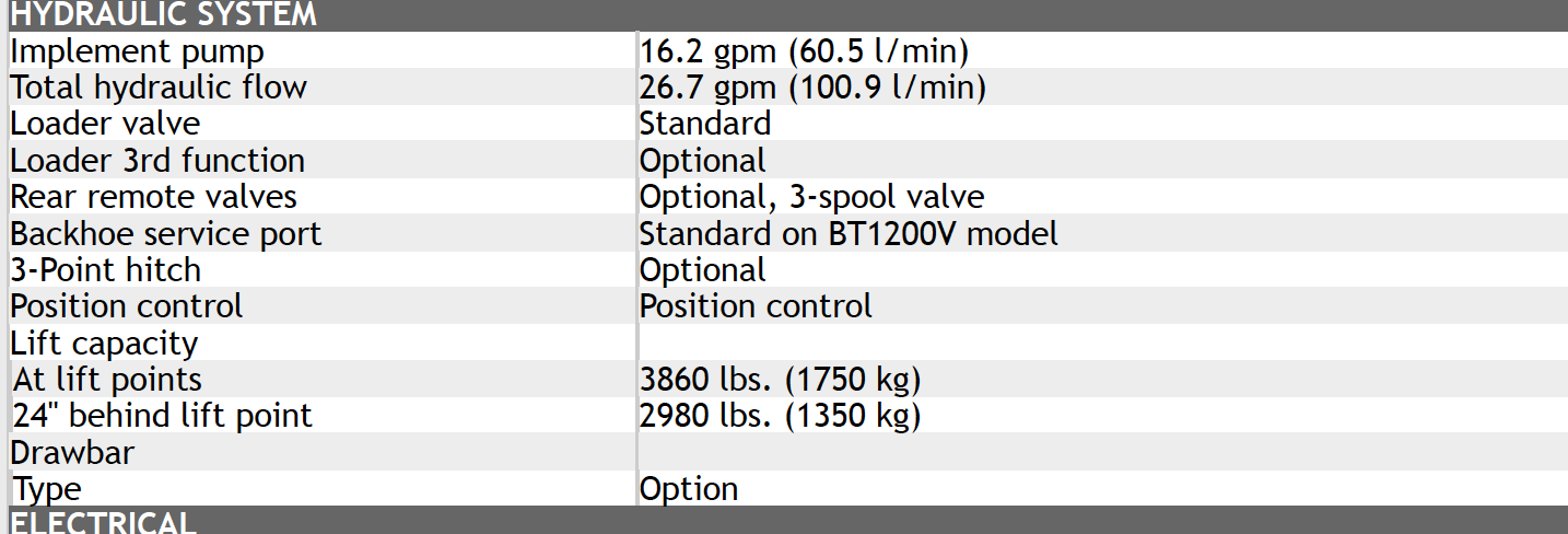

The one hydraulic-taxing implement I hope to get someday is a FEL-mounted auger. The potential to better control of hole placement and the ability to apply downward pressure is applealing versus that of using a PTO mounted post hole digger.
Digga, Premier Attachments, Danuser, BellTec, etc. all have models that will spin with relatively low gpm hydraulics, but they obviously produce lower torque to the auger, thus slower/ weaker auger cutting performance. The numerous variables such as soil composition, hole size and duration to drill will determine whether such performance is acceptable to the user. Short of hands-on experiance, I won't know if the juice is worth the squeeze.
My Kioti dealer told me that of the 17.9 gpm from the RX6620, about 8 gpm go to the steering circuit, with the balance (9.9 gpm) available to the rest of the hydraulic system. I hope that flow rate can produce acceptable results.
GPM is speed
PSI is torque.
So less GPM is just gonna make it run slower.
Most people I know augering with a skid loader are doing so at or near idle anyway. So I think even a big skid loader auger would be fine on a 10gpm tractor

Good stuff. I hadn't considered torque, PSI. My 773 Bobcat puts out 16 gpm at 3000 psi. It has a 70" bucket but it struggles with the 72" brush hog in thick material if I'm moving too fast. This machine is not the hi-flo model which puts out 27 gpm. I see most tractors in the 40-50hp range well under 16gpm but I don't know what the PSI is. Thanks for your replies.

I saw gpm from 7.5 to 16. Just wondering if there was a rule of thumb. Thanks
The implements that require the most flow are front-mounted bush hogs, snowblowers and the like. Most Bobcat-like loaders have enough hydraulic flow to run these implements. Most tractors do not. Look into what you might want to have down the road and see how much flow they need.

It's really a good idea to know what hydraulic attachments you might expect to operate. It's important to know the flow rating at a given pressure: Is it rated 9.8 gpm at 3000 psi or at 2500 psi or ...? If your attachment needs 9.8 gpm at 3000 psi but your tractor is only capable of 9.8 gpm at 2500 psi then your attachment may not do the work as intended.
As an example: For a hydraulic log splitter a high flow rate with low pressure will make the cylinder extend and retract fast without a load but as soon as you put a log in there it will slow way down and may not even split harder woods. With higher flow at working pressure the cylinder will extend and retract faster with or without a load (so you can split more wood!)
