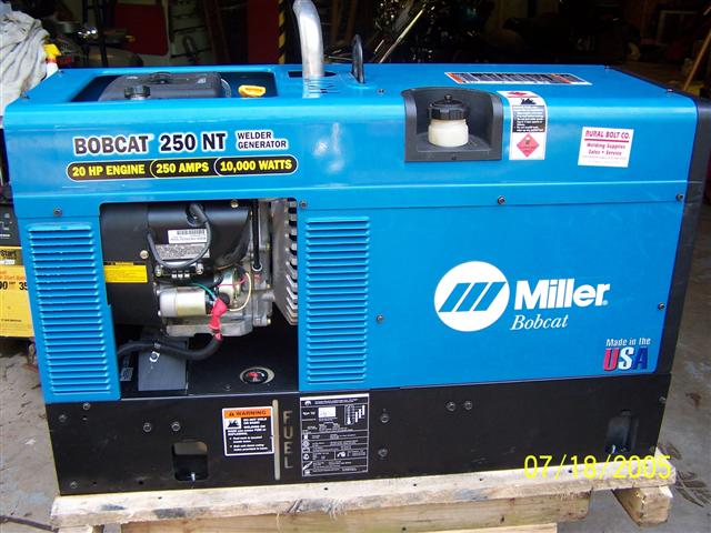

My generator is also a welder. Miller Bobcat 10,000 watt and will run my whole house.
