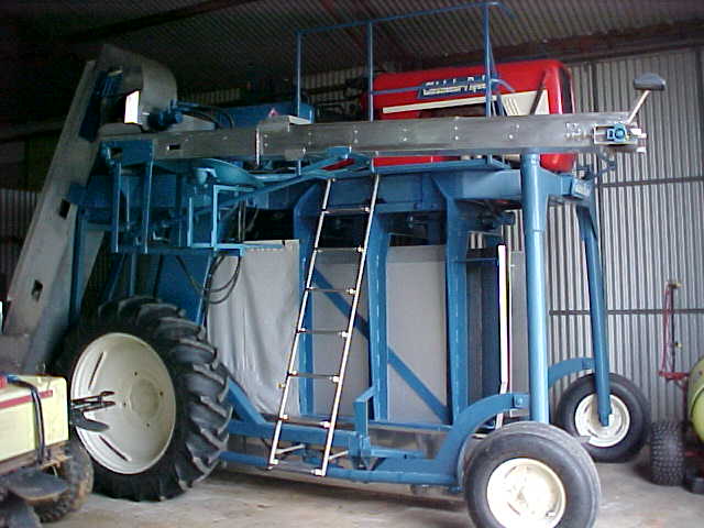

I object to my Chisholm Ryder being called a dinosaur :) , it's American know-how at its finest! However I have fitted it with a Nairn head (copy of Mecca) and their mini-bows and I don't believe it gives too much away to Gregoire or Korvan. Or Pellenc. Or Braud (New Holland).
If I had 250K + to spare I'd be very tempted by the Korvan - everything on Gregs and Pellenc are run like the clappers (don't know if you have that expression there - it means "fast") and while money is tight I wouldn't want to be paying the maintenance on them.

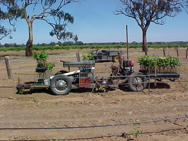

For now, some pics from my hard drive.

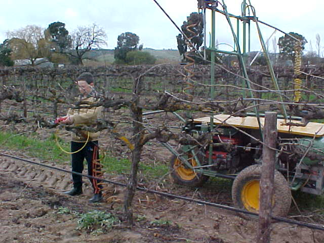

MVC-009S.JPG My old pnuematic pruning buggy
Copy of MVC-756F.JPGHome-made buggy for planting vines,training vines, tying up drip hose, etc. Has two seats low on RHS that slide out allowing operators to place a leg each side of a vine while woking on it.

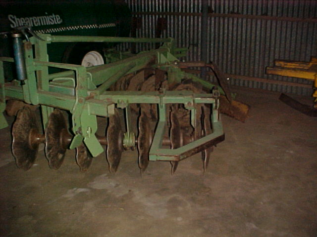

MVC-706F.JPG My disc

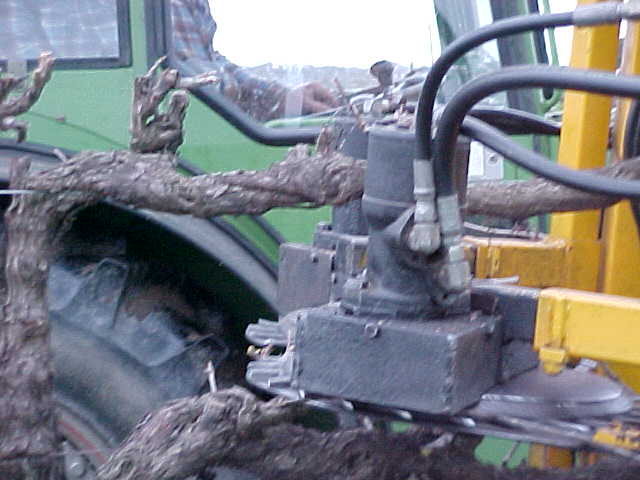

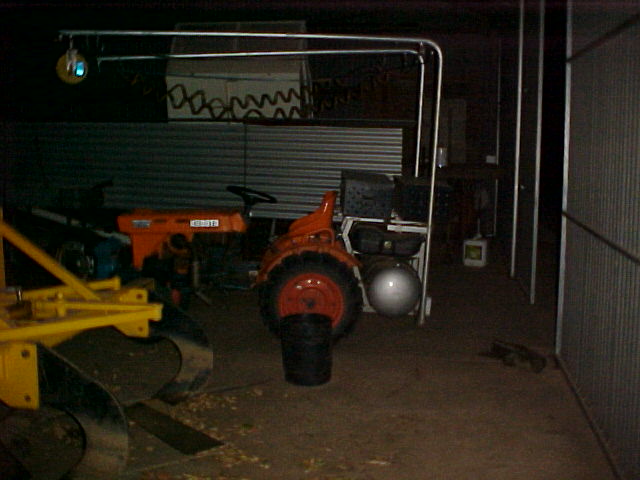

MVC-876F.JPG My home-made (apart from the orange bit)pnuematic pruner

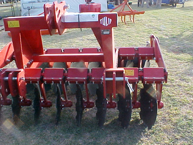

MVC-718F.JPG A disc I photographed at a field days, each disc mounted individually (lots of bearings) allowing parrallel gangs, shorter length and a crumble roller. Anybody know who makes these - European I think.

Thanks for the pics. I have never seen a disc like you posted with individual bearings. It is interesting and I will see if I hear anything about it at our grape conference in a few weeks.

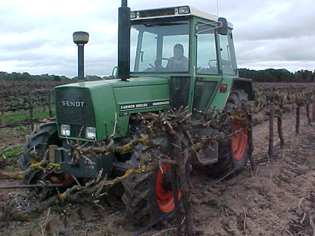

Is it just an illusion or is that Fendt a full size tractor?
Yes it is a full size (305LSA), as is my Deutz, both are about 6' wide and work fine in 10' rows but it can be difficult to get to the rear of the tractor in the row.

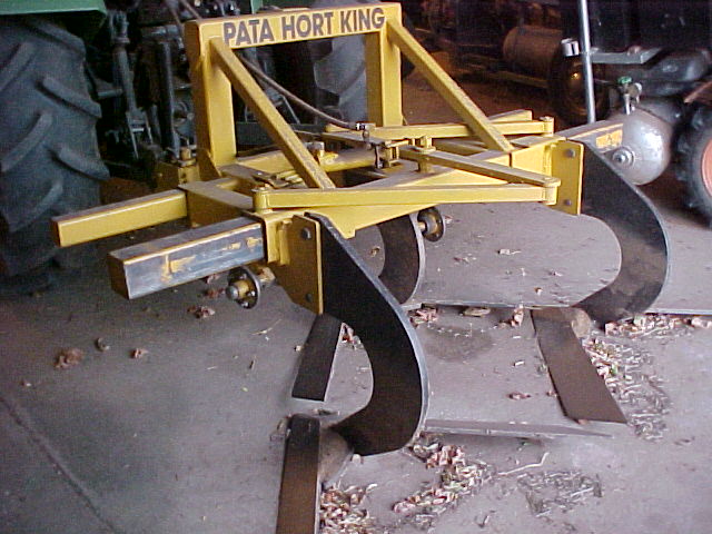

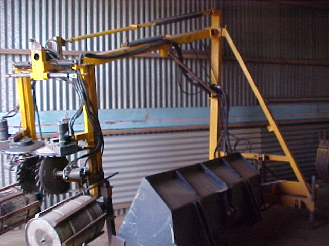

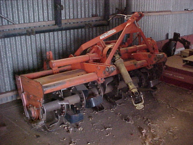

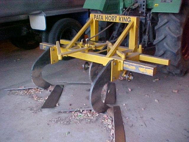

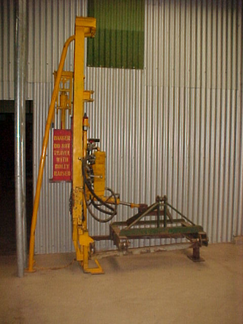

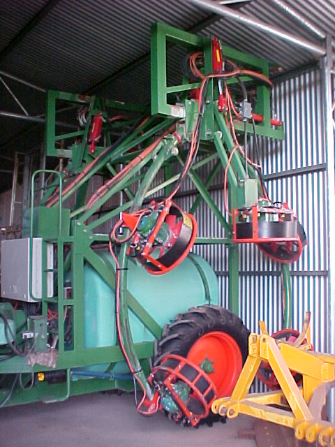

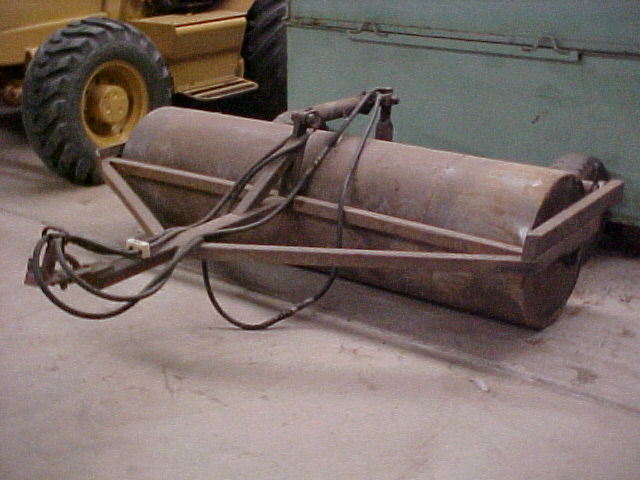

Some more photos I took late yesterday, harvest has been keeping me busy, finally sold the remaining 34 tonnes of Chardonnay at $120 per tonne and have just started on the reds.
MVC-031F.JPGBlade Plough, the hydraulic widening runs on UHMWPE slides and was added by me last summer. Previously manually clamped to just the rear 4 x 4" RHS and regularly broke the clamping bolts.

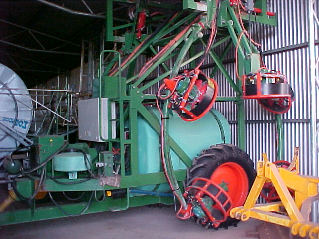

MVC-029F.JPGGreentech two row sprayer, made in Adelaide, South Australia uses a 60KVA three phase alternator running 10 x 2.2kW fan motors. I've made the front bearing and seal of each motor greasable or they'll get spray inside in about 40 - 50 hrs of use.
MVC-022F.JPGPellenc Pre-Pruner, my brother added the rotating drums below the cutters last year in an attempt to throw the prunings out from under the row. Not entirely successful, needs more work.

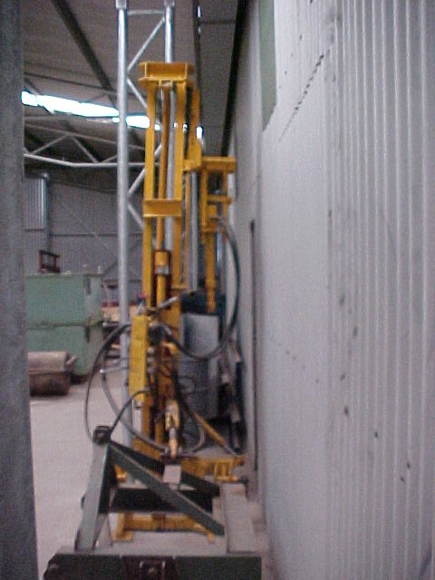

MVC-027F.JPGMonroe Hydraulic post auger and knocker, the auger motor swings in under the dolly for when a pilot hole is required, I have about 4 auger sizes to fit, usually choose one a bit smaller than the post so the post will be driven in and be tight. Only require a pilot hole for 5" + posts or in very heavy soil.
MVC-017F.JPGHoward Rotary Hoe

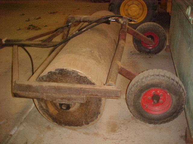

MVC-024F.JPGRoller for towing behind hoe to compact the soil to help prevent spring frosts. I widened the roller to 80" a few years ago and made a new, stronger frame to accept the strain of an also added hydraulic cylinder and raising wheels.

I like that auger/pounder you have there. I am going to look into it more as I am curious about if they sell here in the US.

As for pulling the trimmings away from your mechanical trimmer have you thought of using a finger reel? The trimmers here have finger wheels (one on each side) that are powered hydraulically. They spin and the fingers (can't recall the length of the fingers) do a good job grabbing the trimmings and pulling them away from the vine and towards the center of the row. They even use this system on the flail choppers to pull the trimmings into the chopper and away from the base of the vine. It won't get 100% but it does a good job.
Here is something like I am trying to describe and I would think could be converted to your trimmer rather easily.
http://www.hoopermachinery.co.nz/images/ss1.jpg
Side-shoot Remover
