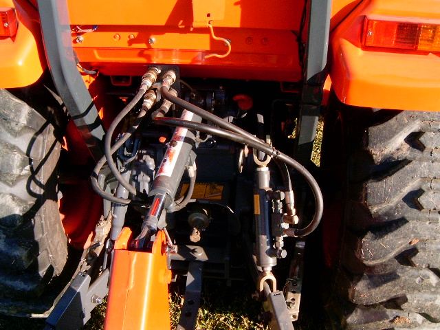

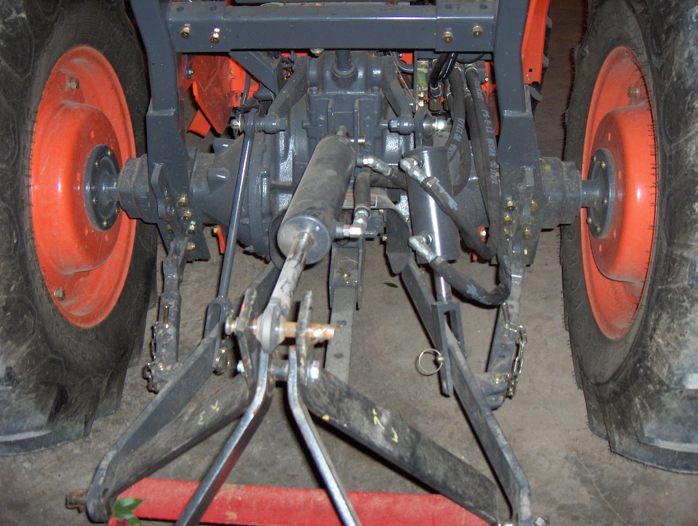

I was just thinking about my "TnT" set up on both of my tractors. I would be lost without them. A lot of you talk about how much you use your hydraulic top link, but not all that many mention the hydraulic side links. I tend to use the side link more than the top link. In fact if I could only have one, it would be the side link.
So my questions are, just how much do you actually use your "TnT" and what size tractors do you have? I have a Mahindra 7520 (75hp) and 3215HST(32hp) with "TnT" sets that I made for both of them. I use both the top and side hydraulics on a regular basis.

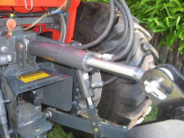

I have Top and Tilt on my Kioti DK 35.
After having it for years I wouldn't want to be without it.
I use the top link all the time. I don't use the tilt very often, but I do like having the feature when I need it.
