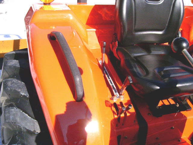

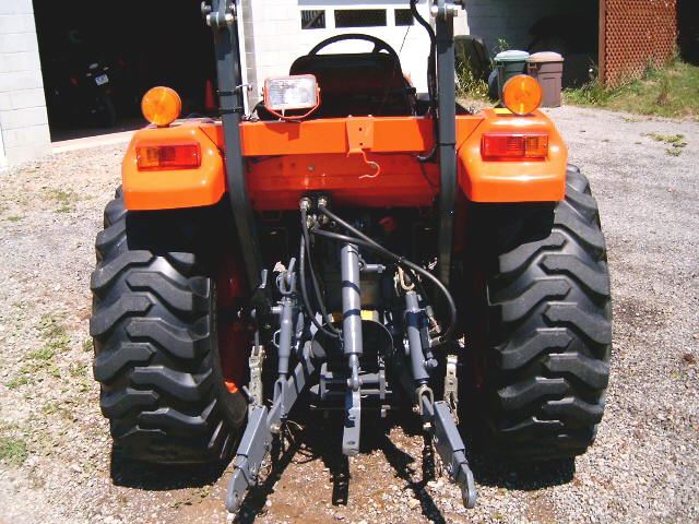

Reggie,
I am running factory rear remote valves.
My dealer included the first set of remotes with the tractor. I later added a second set.
The remote valves mount on the top of the transmission under the seat panel.
The control levers are the small levers on the right side just in front of the position control and draft control levers.
The top link and tilt cylinders are from CCM with check valves.

Vince,
Thanks for responding. I am still a little confused - - new to setting up hydraulic systems and have only done this once for a stump grinder. I have the same set up that I see on your tractor. I have a backhoe so the four hydraulic fittings are in the back and the two small control levers are there. I thought the control levers just determined which hydraulic coupling was pressure and return on the two sets of fittings in the rear. This then requires a second valve to extend/retract each cylinder - - two valves for your set up. Are these the remote valves you added on the top of the transmission under the seat panel? I couldn't see them in the picture.
Also - - what are the sizes of the cylinders you used for top and side. I have to admit that I would like to shamelessly steal your design :). You said that the cylinders were "with check valves" - not sure I understand this either.
Thanks for the help,
Reggie

Vince,
Reggie
It sounds like you already have all the same remotes installed that I have and that is all that you need . All you need is the cylinders and hoses and plug them in.
You can extend and retract the cylinders with the remote valves you already have.
Example-I plug my top link into the 2 quick couplers on the far left (the hydraulic fittings on the back of my tractor). If I push one of the small control levers forward my top link will extend, pull it back and my top link will retract. No extra valves are needed.
My tilt cylinder plugs into the other 2 quick couplers and works the same way.
I can't remember the size of my cylinders, I will check tomorrow.

Vince, with your 3pt set up like it is in the picture, does your tilt cylinder tilt your blade down to the left and right? From the pic, it looks like it only will only tilt the right side down. :confused: Can you please confirm this.
