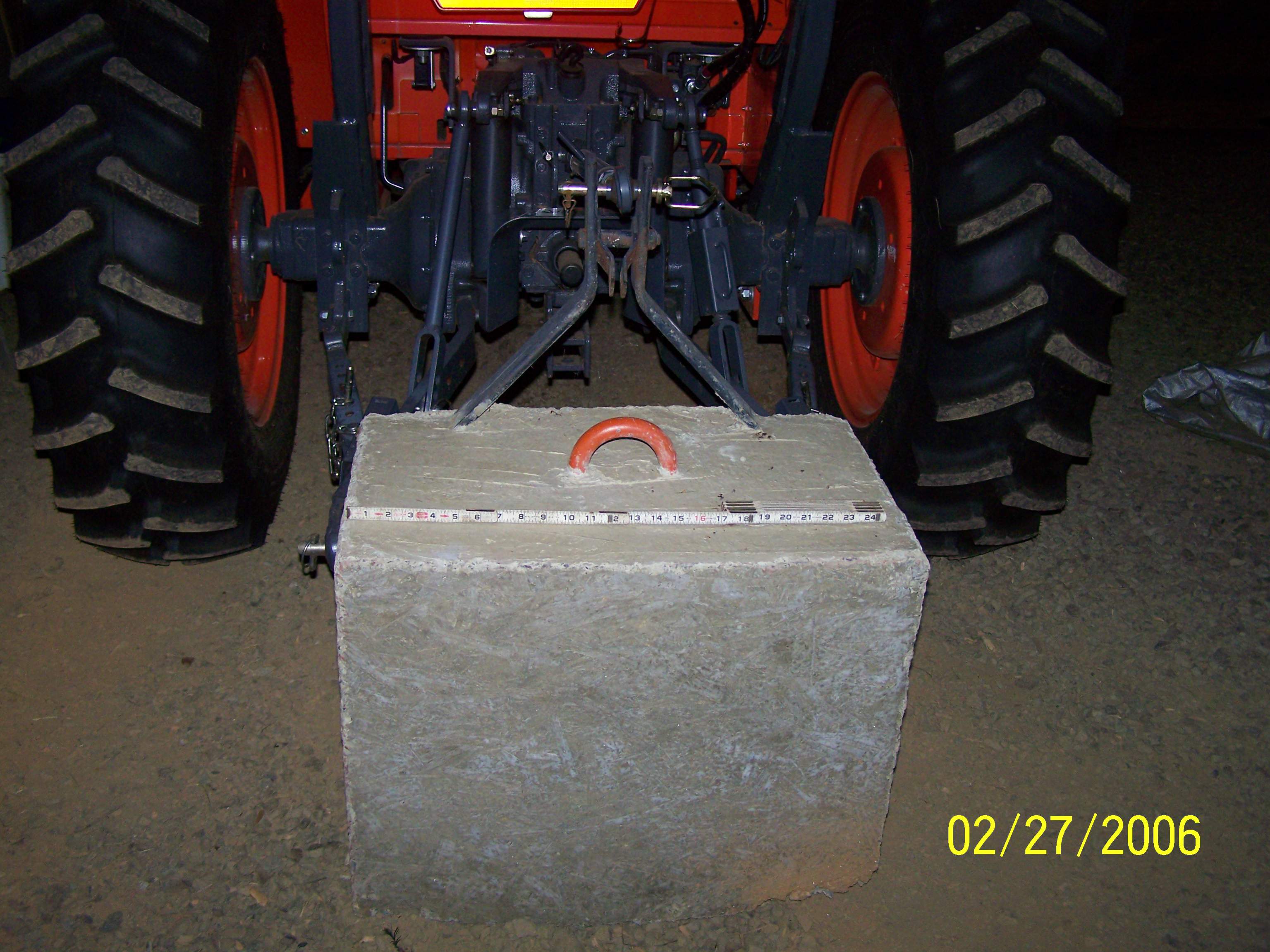

New, compact counterweight w/2 in sq reciever about 800 lbs (cost was less than $20 BTW) + Wheel weights 360 lbs (cost $378) + loaded tires 480 lbs. Total 1640 lbs.

Please tell me more about how your counterweight is made and out of what. That looks very interesting.

k0ua, the 3pt attachment is off of a junked Bush Hog cutter, The 2 big chunks of iron on the bottom were given to me. I think they were part of a counterweight on a electric fork truck. Between the 3/8- 3X3 angle are two pcs. of 2 X 3.5 in. steel that I had lying around. I welded the reciever to them. The 5/8 rod was just overkill in case I need to lift a lot on the reciever. I thought about more bracing, but figured I'd see how it goes. When I get around to it, I'm going to add a basket to carry chains.
I liked some of the ideas expressed on the forum by you and others, who had attached tool holders or hitches on their counterweights. I felt that with this design I could easily weld on whatever I need in the future. If the addition was temporary I could attach it to a 2X2 sq. tube and slide it in the reciever. I guess it's a design in progress.:scratchchin:
You got any good ideas on improvements? I'd like to here them if you do.:listen:
Best, Bill
Best, Bill
Well you already mentioned the chain basket, I would definitely do that, and maybe something to hold your chainsaw.. I make great use of the 2 inch PVC pipes I put in my barrel for handle tools. The first thing I noticed that I liked about your design was you weight is down low keeping the center of gravity of the tractor low.
James K0UA
Yeah, I liked that design also, several inches below the pins. Even if you lift the 3ph all the way up it might still be below the axle. Nicely done.

very nice design. keeps the mass down low.

BTW - I really like Notforhire's ballast implement. V-E-R-Y low CG should help stability on side hills and the receiver hitch makes it even more useful.
