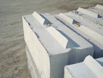

I would set 1-2 "mafia blocks" (2'x2'x4' or 2'x2'x6' concrete block that the cement places make from what's left in the truck when it comes back), then get a couple of the caps that they make to go on top (otherwise, the top has a ridge to help when stacking them) and fill behind it with gravel.

Mafia Blocks:

That is one of my ideas also. So I called the 2 closest ready mix plants and neither of them deliver or set them and one of them kinda chuckled at the idea of setting them. So I thought I would build my own, which lead to the idea of making it out of lumber or timbers or blocks. And all that brought me here with the question thinking maybe someone has built one and has some tips or tricks for building & maintenance success without spending all my pocket money.
I think I'll call some ready-mix plants further away in the big town.

You might try a place that sells cement septic tanks as they are usually equipped to do that. If not, I would find a local excavation contractor and have them deliver/set them. At 3000# for a 6' one, they aren't light, but they shouldn't be a huge deal.

At 3000# for a 6' one, they aren't light, but they shouldn't be a huge deal. Aaron Z
They advertise them around here... delivery with a minimum purchase. But I wanted to move them myself and the lightest they have are 2,000 lbs. My poor CK27 can't lift that much.
I'm amazed the OP found resistance at the supplier. What else are they going to do with them except make retaining walls? :confused:

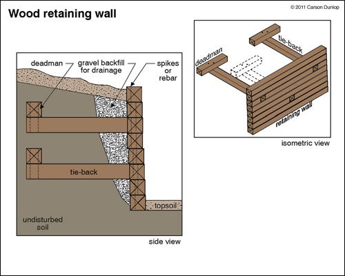

If you are trying to make it easy and to look good, get suitable treated pine lumber (ground contract grade) to hold the dirt in place for the slope and hide the slope. Plant shrubs on the side of it or put a flower box on the side depending on your landscaping and it will look good. To me much better than stacked concrete blocks
You need to have a top material that will hold up to rain washing it, and wheel climbing the grade.

The diagram that WVBill showed is the way to do it. The deadman anchors and drainage gravel together dramatically reduce the likelihood that the vertical face will start to shift outward due to frost or ground compression pressure on the ramp side. Ground contact treated wood will last a long time and IMO looks pretty good, too. Even if you built a rock or concrete wall/berm, it would be a good idea to back it with both drainage gravel and the deadmans.
I saw some interesting wall blocks being installed at a road project near my home. The blocks were sort of L-shaped with one leg of the L being the deadman and the other the face, and they interlocked with tongue and groove mating surfaces. These were concrete, of course, but the face side was a textured concrete that actually looked a lot like rock...all in all very esthically pleasing. Budget quickly becomes an issue when you start to deal with commercially-available retaining wall materials. Not only are these new-price expensive, but many are beyond the ability of a homeowner to install...so contractor costs come into play.
Wood is a lot more amenable to DIY and give considerable flexibility in design, too.
