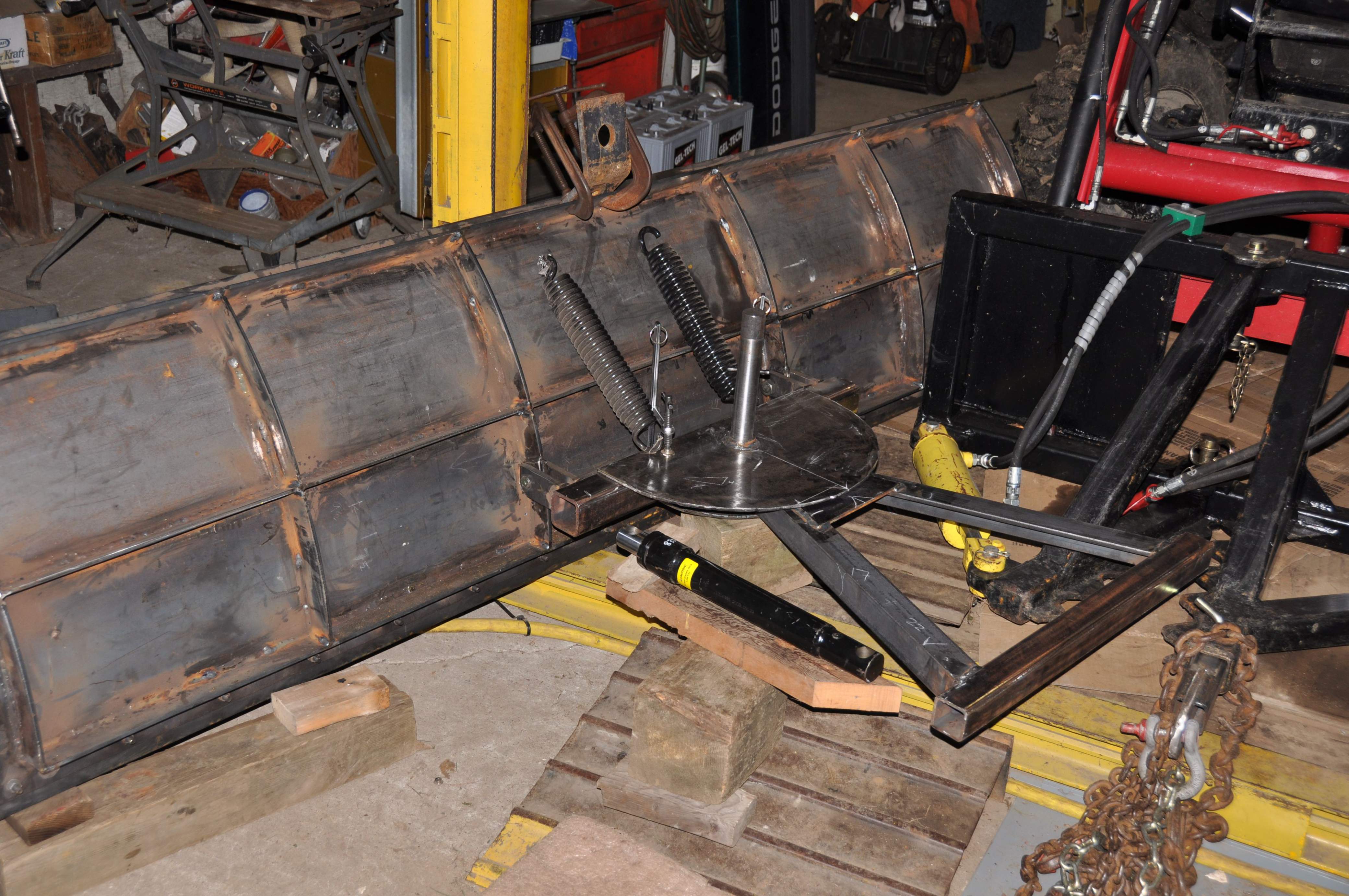

look at my snowplow build Pictures on page 2 now "Snow Plow started" . (Sorry, do not know how to link.)
This design could be easily mounted to a skid steer QA plate. It would extend about 30" beyond the front of the QA plate. The AFrame could be pinned if you do not want to use hydraulics to to angle the blade.
I will take more pictures showing my progress tomorrow.
I picked up 2 western snowplow angle cylinders and some skid shoes at the Princess Auto parts on sale a while ago. I still need to get a crossover relief valve and a lift cylinder. The blade I had rolled at a local shop and most of the rest of the steel from the scrap pile.
Cam
Why would you need a lift cylinder?

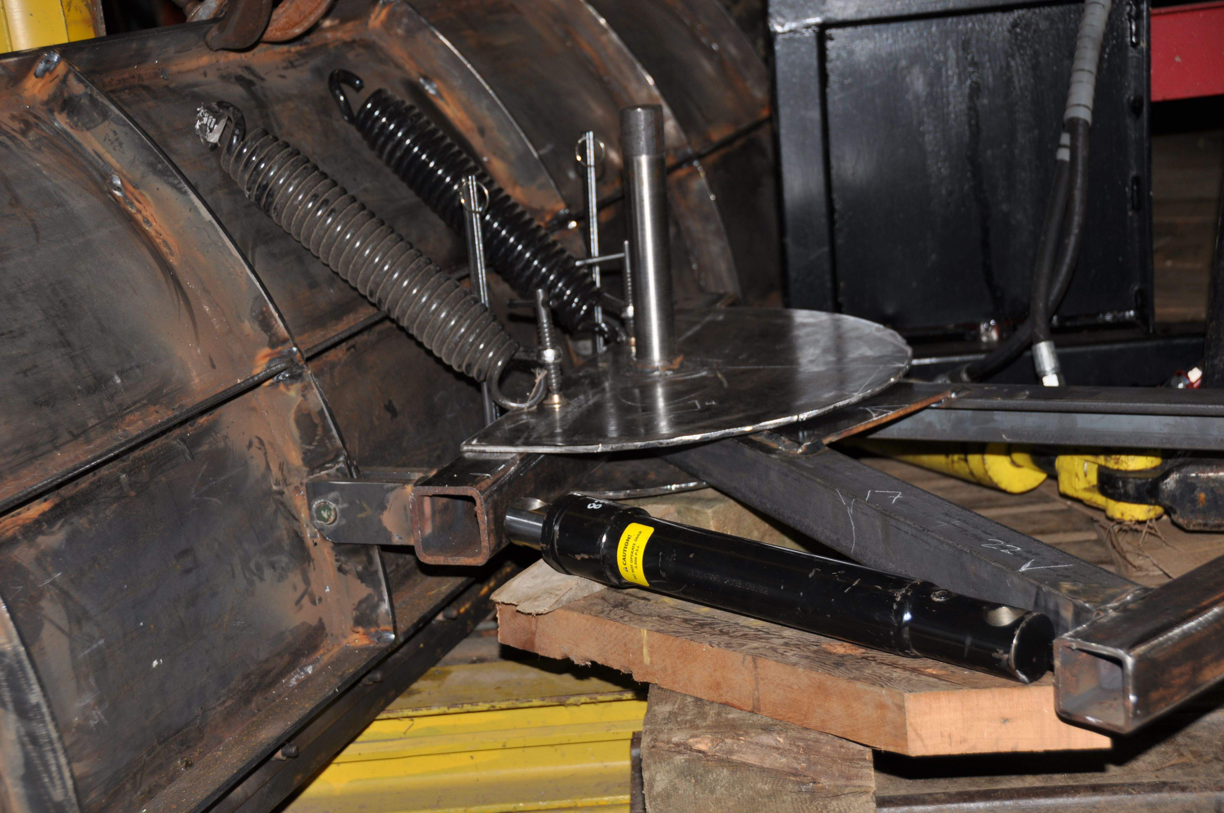

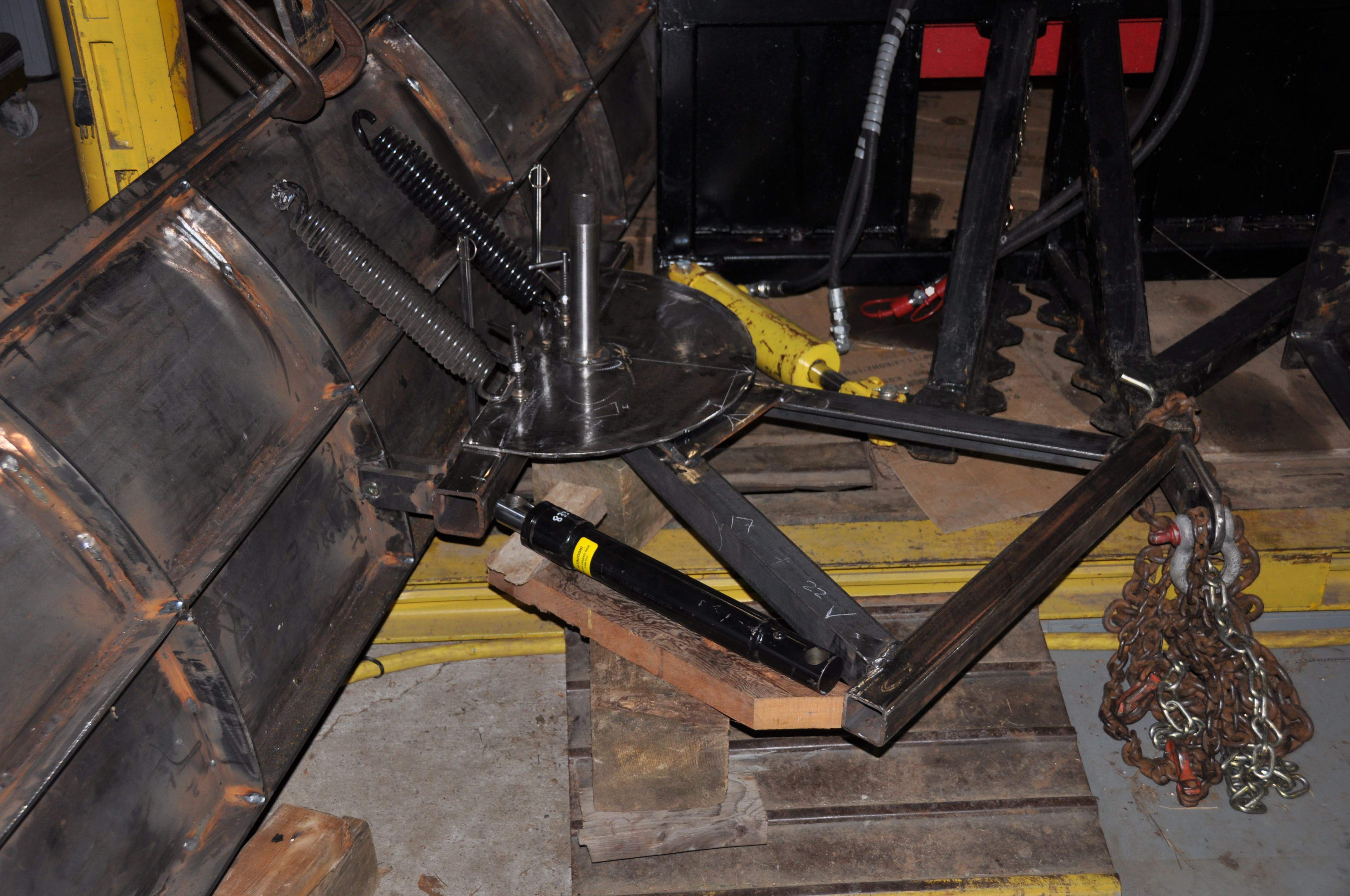

I am indeed frame mounting my snowplow on my tractor, hence the need for a lifting method. My old frame mounted plow on the small tractor was just bolted at about 25 degrees. I never did unbolt it to change the angle, just never seemed worth the time when there was snow to be moved. IF I had a lot of snow, I would have to plow down hill making 2 or 3 passes to make up for the lack of horsepower.
Here are several pictures of my plow as it sits today. The A-frame could easily be mounted on a SSQA plate. The A-frame could also be bolted at 25 degrees right or left or strait instead of the hydraulic angle. I have more money now than 25 years ago so I am going with the hydraulics.
I have invested about $300 in steel so far in this project. This was mostly the blade supplied and rolled by a local shop.
Cam
