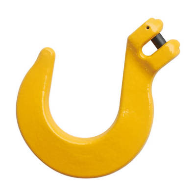

It sounds like I need a hook on the end of the pole, and after that, I can attach straps or ropes or chains or whatever.
For lifting with chains a common grab hook works good. For lifting with straps (without damaging them) the setup is different. I use a large foundry hook on the lift. Then attach the straps to the hook using large D-ring shackles. Harbor Freight has excellent shackles for less money than other places. The foundry hook is going to be pricey.

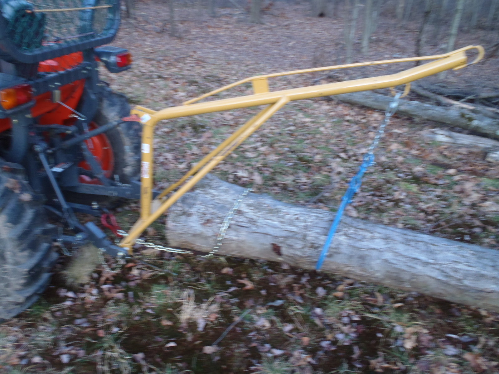

CalG has got the right idea. I have had a boom pole for over 10 years and it gets a lot of use on the L3240, which has plenty of weight with the FEL attached to lift heavy loads. I attach a grab link to one of the 2 loops on the BP. This allows me to adjust the length of chain quickly. 2 rope tag lines, going from the chain near the load & back to the left & right 3 point pins help reduce swinging.
Remember, a boom pole is really meant for lifting, not pulling. If the load is heavy or runs any risk of snagging, I also hitch a chain directly between the load and the transmission mounted draw bar - not the 3pt draw bar. This isolates the 2 components of the load. All the lifting load goes through the boom pole, but all the pulling load goes through the transmission mounted drawer, below the rear axle. This is done to reduce the risk of the tractor back flipping if the load gets hung up on a rock or stump.
I also use an 18' long 5/8" polyester rope to move slash - brush. One end of the rope has an eye splice. When I drop a tree, I lay the rope out on the ground. As I limb the tree I lay the butt end of the branches over the rope, with about 2 feet overhanging. Then I run the end of the rope through the eye, cinch it and tie the end off on the loop on the BP with the hitch lowered on top of the pile. Lift the hitch & the rope closes like a noose around the limbs & lifts the butt ends off the ground and then I can drag that pile through any kind of terrain to my CBP (Central Brush Pile) for disposal. A poor man's grapple, of sorts.

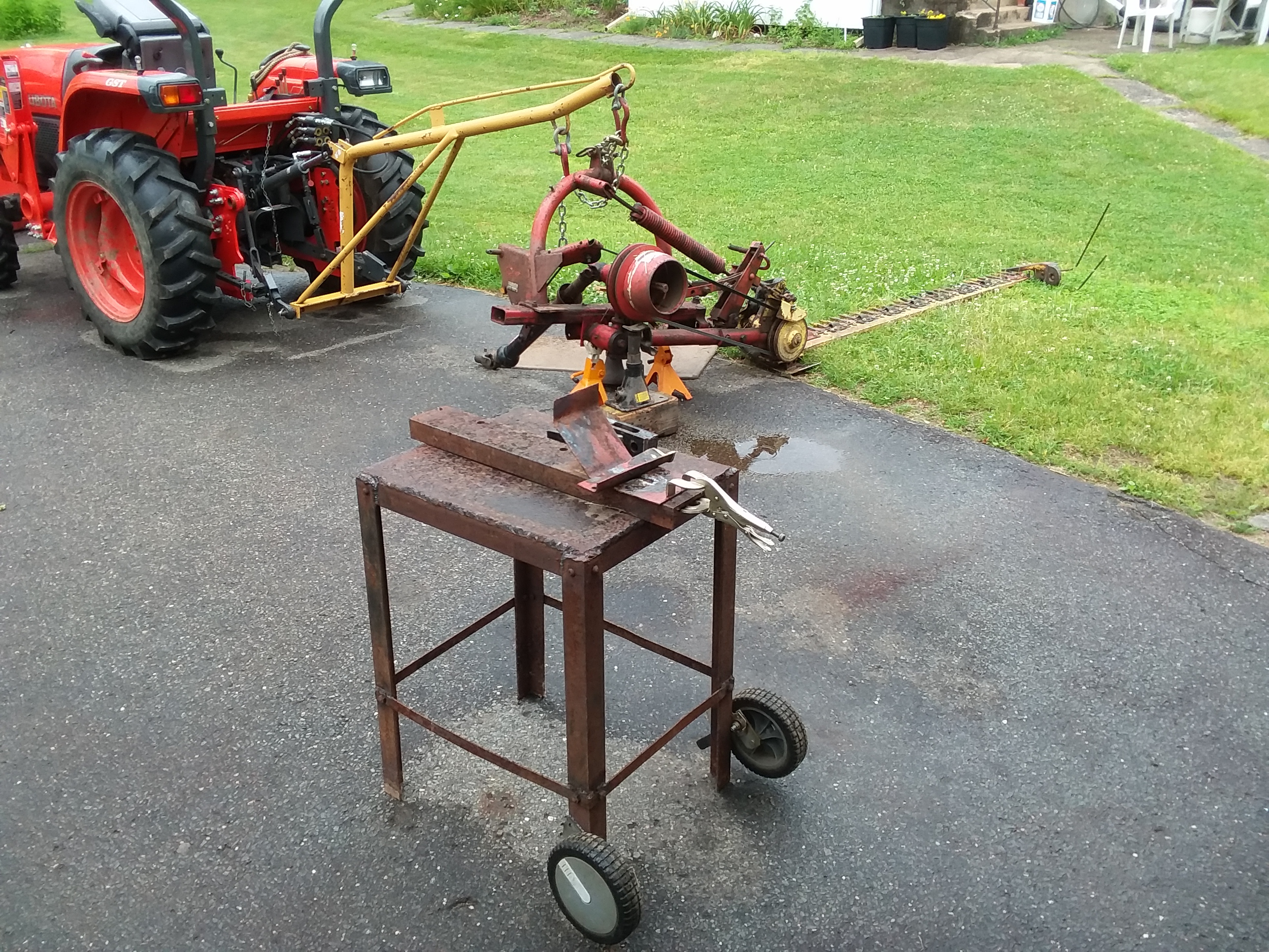

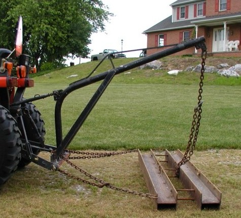

I made a boom pole for the old Ford (doesn't have FEL). I kept it and about the only time I used it was for the I-beam drag with the first Kubota. A few years ago I revamped the drag and haven't used the BP since.
