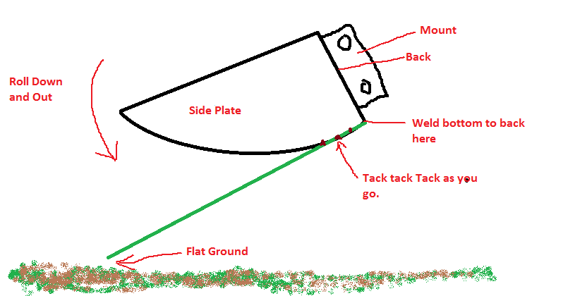

I'll describe a method that worked for me, but it really wasnt building a bucket from scratch, it was making a 12" out of a 24" bucket.
After we cut the sideplates out, the bottom springed out somewhat straight. So we were faced with the dilema of how to get the curve back in just like you are facing with building a new bucket.
So...why not use the backhoe hydraulics?
If you make the mount/back of the bucet, and go ahead and weld the side plates to that, and weld the bottom plate to the back of the bucket, then you can use the backhoe to "roll" the bottom into place a little at a time and start tacking it as you go.
Its very similar to the way Sfrankland did it on the table, but using the backhoes hydraulics to help for it into shape. It was a bit heavier steel though on the Ford 4500 Bucket. Once its rolled into place and tacked, you can either weld solid in place, or take back off and weld. Taking back off is what we did, so the bucket can be rolled around and positioned for better welding.
Here is kinda a pic to help describe

That is a method I have also seen recommended somewhere else.... IIRC the guy was working on an excavator bucket that was pretty large and some thick steel. When I built my 9" bucket adjustable clamps were all I needed.
