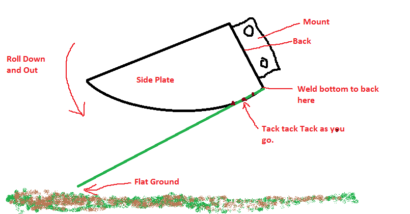

So I read this post today and it got me thinking about building a ditching bucket for my backhoe. I had some scrap plate laying around and started cutting out the parts for my bucket. When I got to the point where I needed to bend the bottom of the bucket I tacked the sides to my welding table so the front edge was flush with the edge of the table. Then I used a ratchet strap to bend it around the sides. I would max out the strap make a few tacks and then reset the strap. Worked out perfect. Will start a build thread tomorrow when I get the camera charged up again.
Should add that the bucket is 24" wide and the bottom is 1/8" plate.
Heavy tacks holding it to the table.
And the ratchet strap doing its job. For the last few inches I had to cut a hole in the plate to prevent the hook from sliding off.

When I made my snow plow blade I took the 1/8" X 60" X 16" 'plate' to a fab shop.
They made small bends every inch to form the blade shape that I wanted.
The press brake was about 8" long and could easily handle 1/4" stock full width.
The charge was a mere $25.00 !
And they did that as I watched saving me an additional trip to pick it up.
I know of 2 shops that do this sort of service within 20 miles either way. Both also stock all sorts of metals but neither have laser or other fancy cutting options, just massive sheers.
This to say that to form a bucket skin would be a piece of cake for most fab shops.
   / How to make the curve on a backhoe bucket? #14
When we made our last bucket, I used what was on hand. I planned to bend a short piece of 1/4" just as SFrankland described but it was just too short and I could not get it to make a smooth arc. I even welded some "leverage bars" to it but the end wouldn't come out smooth. I ended up cutting evenly spaced perpendicular lines about 1/8" deep and it actually made a nicer arc. Basically the same principle Piloon described ( multiple short, flat bends). I filled the cuts with weld beads and did some light grinding and it turned out nice.....almost like it's hard faced in fact.
