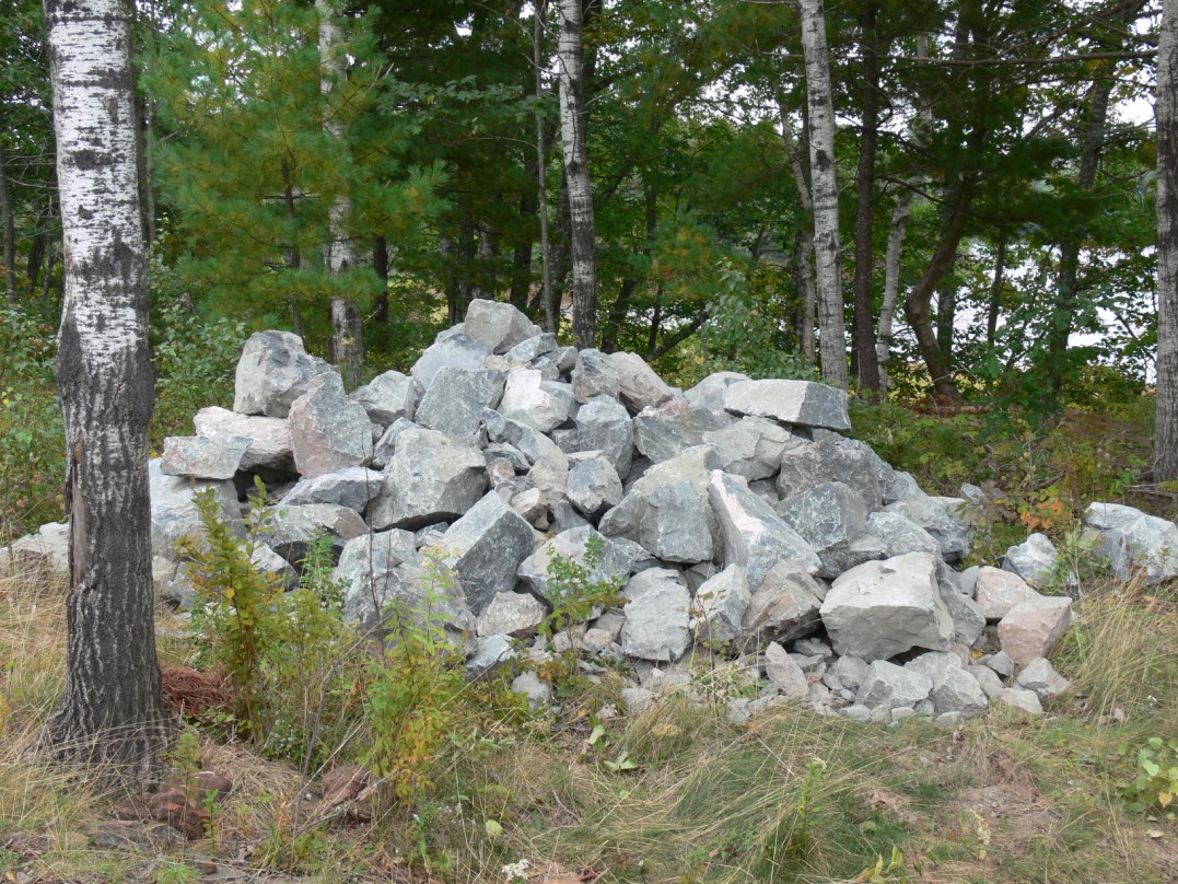

Along these same lines, I have a nice pile of granite rocks I plan to make into corners for flower beds. They were delivered in a large dual-axle dump truck. I asked them not to get me really big ones as now I have to pick them up and place them in the garden locations. Now I just have to figure out how to best pick them up! I am guessing I'll have to use a big bar to pry them one by one into my FEL, as I don't have a grapple??
