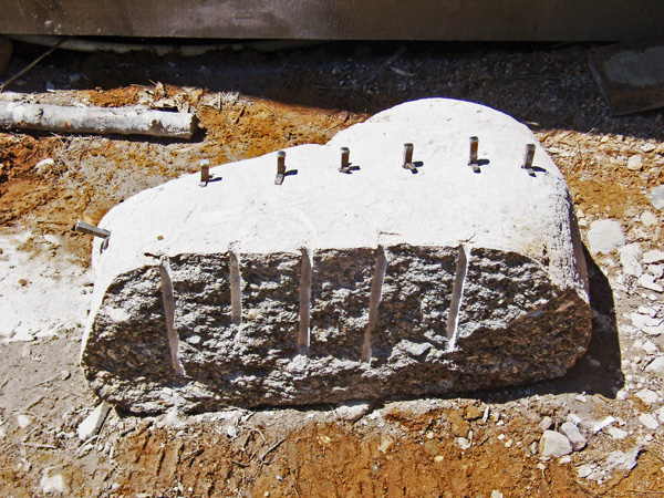

Dexpan is another product.:D
I prefer the feathers and wedges. That satisfying clunk when the rock splits instead of the Twang before it splits.:D

Even if you had to split a large boulder, when the boulder is set on the ground, no one knows that it has a flat bottom. Take one large boulder, split , and sell as two.
Same size diameter at base
Someone makes a products that you bore several holes into the stone/boulder, and add some compound, and let it sit, and the chemical action causes the material to expand, and the stone/boulder is split.
JJ,
This is an old thread where I used TBN advice to split rocks:
Bustin' Up Boulders
It's got lots of photos and even a crummy video. Egon even commented in that old thread.:)

Good demo, Thanks to Rob for the pictures and video. I knew the stuff existed, but have never seen it work or had occasion to use it. Someone mentioned the diamond saw, and cutting slits, and chipping the rest. How well did the diamond cut into the stone or was it cement? Rob, I supposed you could have used a shop vacuum to suck out the dust. , since you had the generator.
I believe it was Hannibal , when crossing the Alps, a huge rock was in the way, and some of his engineers came up with the idea of building a fire around the boulder, and after getting it very hot, they poured water on it and it split in several pieces, removed it, and made their way through the pass.
