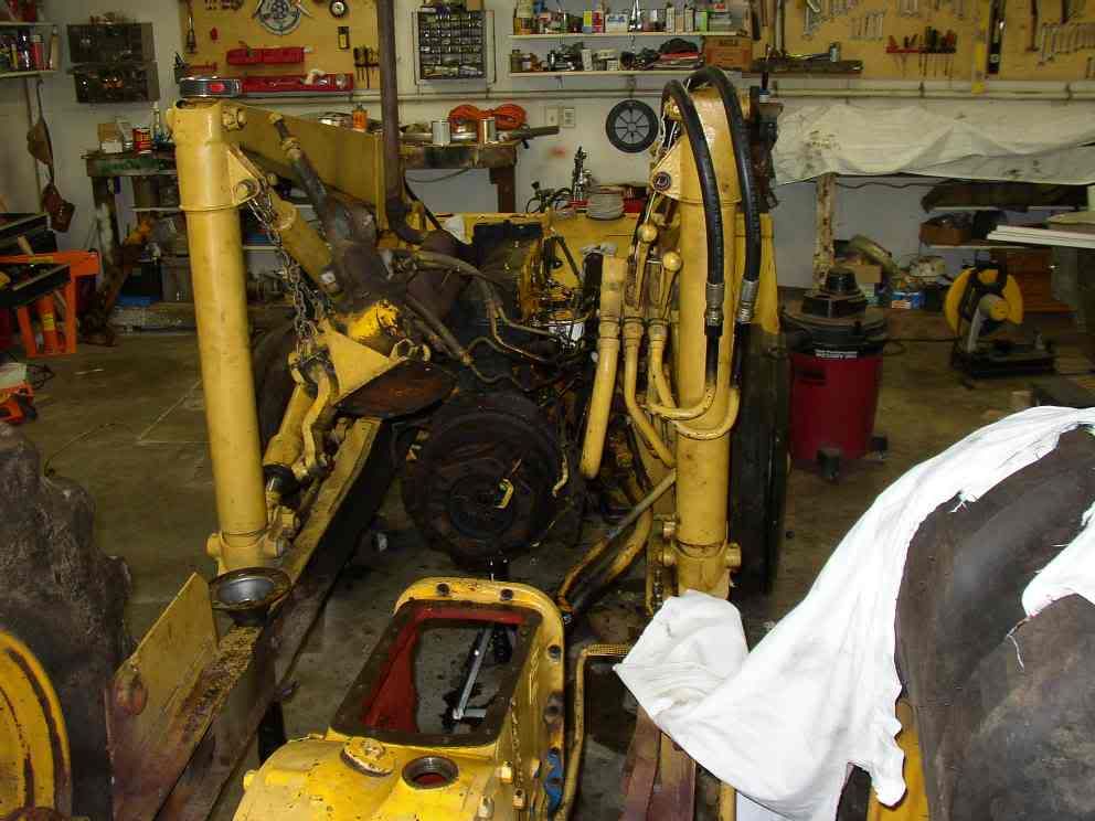

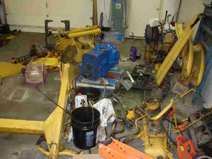

Last month I finished painting my 1964 MF-135 diesel. First tractor restoration project I've attempted.
To keep cost down I used a $40 HVLP spray gun from Harbor Freight and $35/gallon Valspar tractor paint from Tractor Supply. I thinned the paint with VM&P naptha per the instructions on the paint can. The engine, tranny and rear end are MF silver and the sheet metal is MF red. Three coats.
Of course, it's important to get the tractor really clean before spraying. Detailing that tractor probably took upwards of 100 hours since it was filthy. I power washed the entire tractor about 5 times (not including the radiator which was cleaned by hand). Then I detailed the tractor using Simple Green, Dawn dish washing liquid and mineral spirits. Lotsa nooks and crannies in the engine had to be cleaned (tediously) by hand.
To do the job right you should strip all the sheet metal off the tractor. In the case of the 135 the fuel tank had to be removed to clean the top of the engine. I also removed all the gauges, the steering wheel and the instrument panel that carries the gauges. I replaced all the gauges except the fuel gauge/sender unit and rewired the tractor. I set up a temporary spray hood on one of my workbenches for painting the parts that I had removed from the tractor.
When I get the tractor reassembled I'll post a few photos. In general I think the paint job turned out OK, considering my limited ability with a spray gun. You can spend a lot more than I did ($500 spray guns, $100/gal super paint), but I'm a novice at this so I started small and cheap.

Harvey7 said:
John Bud
I'm amazed how guys like you can strip a tractor down into hundreds of pieces and get it all back together, by the way it looks great.
Harvey
Well, there were a few points where my head kept on saying, "What the He#$ have you gotten into?" But, being more stupid and stubborn than realistic, I went ahead.
On old iron, 44 years old in that one's case, there have been many *ahem* shall we say, "customizatons". You look in the parts book for the break down, find that what you took off ain't what Ford put on. That's hard. What's worse is finding broken things that need fixing. I just picked a sub-assembly to do every week or two and pretty soon it was done.
As for extra parts. Well, there is a 5 gal bucket full of gears, shafts and countershafts from the transmission. I replaced the instrument cluster and back sheet metal so there are some left overs there. I had to design and bend up from scratch the PS hard lines and have soft lines made to fit. Many rev's of tube that got bent at the wrong angle. Had to figure out the boomarang shaped pivots for the hand throttle and foot throttle from pictures and then cut them out of sheet stock & grind to fit. So, there's some extras there too. Then there's the trans case that was too cracked to save - had to replace. Ditto for the differential housing. So, there are a few extras laying about.
It is weird, but I have a feel for bolts and can tell you pretty much what each one is for and where it goes. But, when you are holding a part that needs a half dozen bolts and you don't even remember taking it off ! That's why I bought over $300 in bolts and nuts (grade 5 and 8). Many of the take off bolts were a total mish-mash of what ever some clown had handy. Allen head's next to grade 8 next to who knows what. Age and rust also take there toll. I'd guess that over 1/2 of the nuts and bolts on that machine are new. Easier to get a true torque reading on a new bolt. Also, went thru a lot of locktite 242 and a jar of neverseize. I firmly feel that every bolt/nut either has locktite or neverseize.
