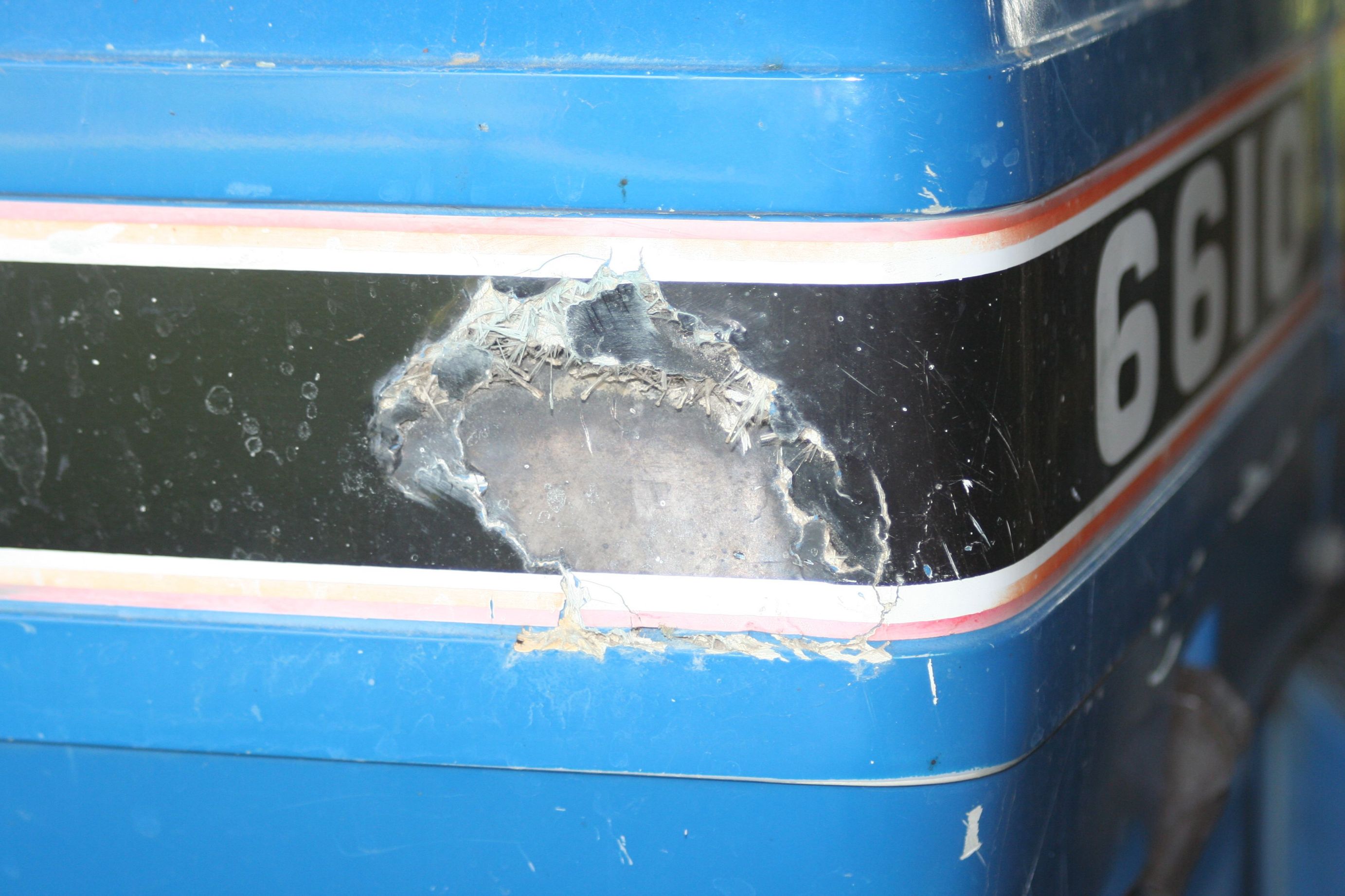

The tractor is in decent shape, there's a place where the fiberglass front hood is busted, and a crease in the top cover over the engine, and normal wear spots in the tractor like where you put your hand behind the gas cap to get off the tractor. I just like to take care of my stuff, I certainly worked hard enough to be able to afford it, so I want it to reflect my "work ethic" and taking care of my stuff. Thanks!
Those small parts.. if they bother you, can be addressed seperately of the entire unit.
For someone learning painting. have 3 pieces of sheetmetal hanging on a line is a whole lot easier than prepping an entire tractor for painting.
1, that fiberglass nose can be removed and repaired.. or replaced... Fiberglass is EZ to fix... even if it needs a wire frame inside to prop the resin cloth on till it cures.. then sand smooth and contour the fb.. use glaze putty or other filler to get minor surface imperfections. then sand entire nose piece to uniformity... Prime it.. follow directions on whatever paint you use... some require wetsanding.. or scuffing afterwards.. or some have windoes of recoat time.
Then paint it.
same with that dash .. it is seperate of the 2 hood front sections.. though much more labor intensive to remove.. however.. with a roll of tape and a few big sheets of mask paper.. you CAN pain it in place if you take your time.. just prep, prime, paint.
Either of the hood sections are EZ to remove...
If the crease is repairable do so.. IE.. lay the crease down on a wood plant and work it with a dent hammer fromthe other side and a rubbing block if needed... Use a glaze or filler putty if needed to finish off imperfections.. sand, prime, paint..
Douing small tasks like a hood panel or a front nose won't be nearly as bad as the entire job.
Might be a fun learning experience.. and at worst.. you have 3 parts that have marginal paint... which.. sounds like they are no worse off than before... etc.
Even if ya don't paint he hood and dash... do go ahead and fix the nose.. that will be the easiest part.. Even if yuo rattle can prime and paint it afterwards.. it will dress up the entire machine by not having a crushed piece on it.

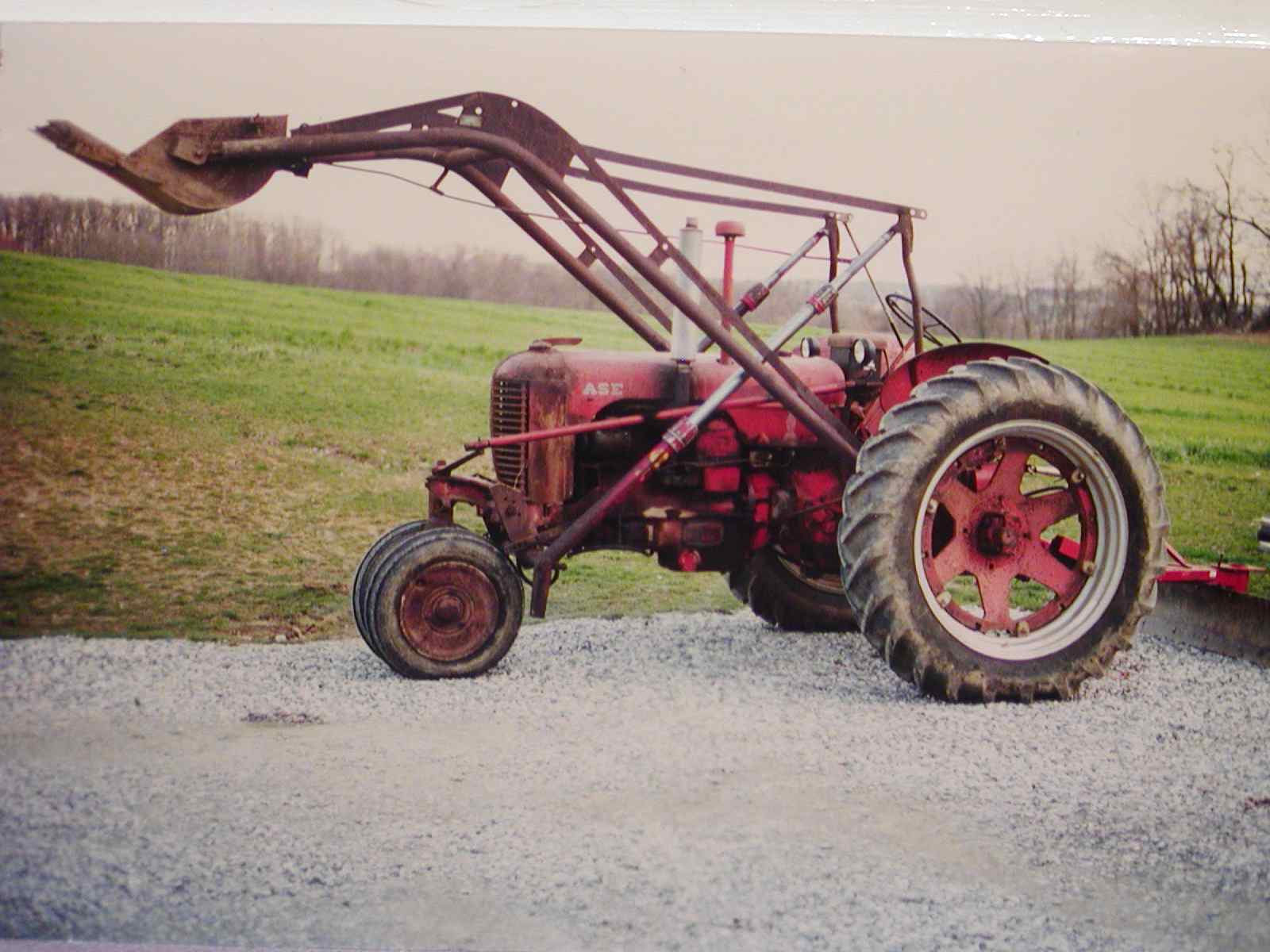

While not 'rare'.. the Allis model 'G' are not super common either.
They are a good cultivating tractor with a 62 ci engine.. similar in hp range as a cub.. or massey harris pony.
I see about 3 for sale per year.
There was a guy that lived north of me that restored them and repowered them with isuzu diesel engines for years.. but he got out of the business. Had I had more $$.. I could have picked up quite a few of his unrestored carcasses when he started to sell out.
It's a neat little tractor.. still 6v.. etc. Starts easy.. sips fuel. I use mine solely for parade / show work. She stay washed and waxed and garaged. I drive her about 1x per month down around our neighborhood to keep her limbered up and to get her up to temperature for a while to prevent moisture from settling in the oil sumps.. etc..

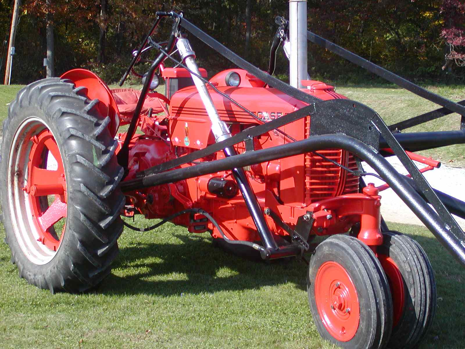

I will say that I did take lotsa time with my best job.. the Allis G Complete disassembly is easy on a small machine.. though i did have to buff out and re shoot the rear hood cowling due to an imperfection.. Might not have done so .. except the rest of the tractor had turned out so good.. i couldn't leave that 'wart' on there.
That's the main reason i havn't repainte dmy 7610s. OEM paint is still holding.. and even the few areas it is worn a bit.. it's still intact and primer is good.... No use in recoating good paint on a worker that see's brush and shrubs al the time.. at least not while there's still intact paint on her anyway.

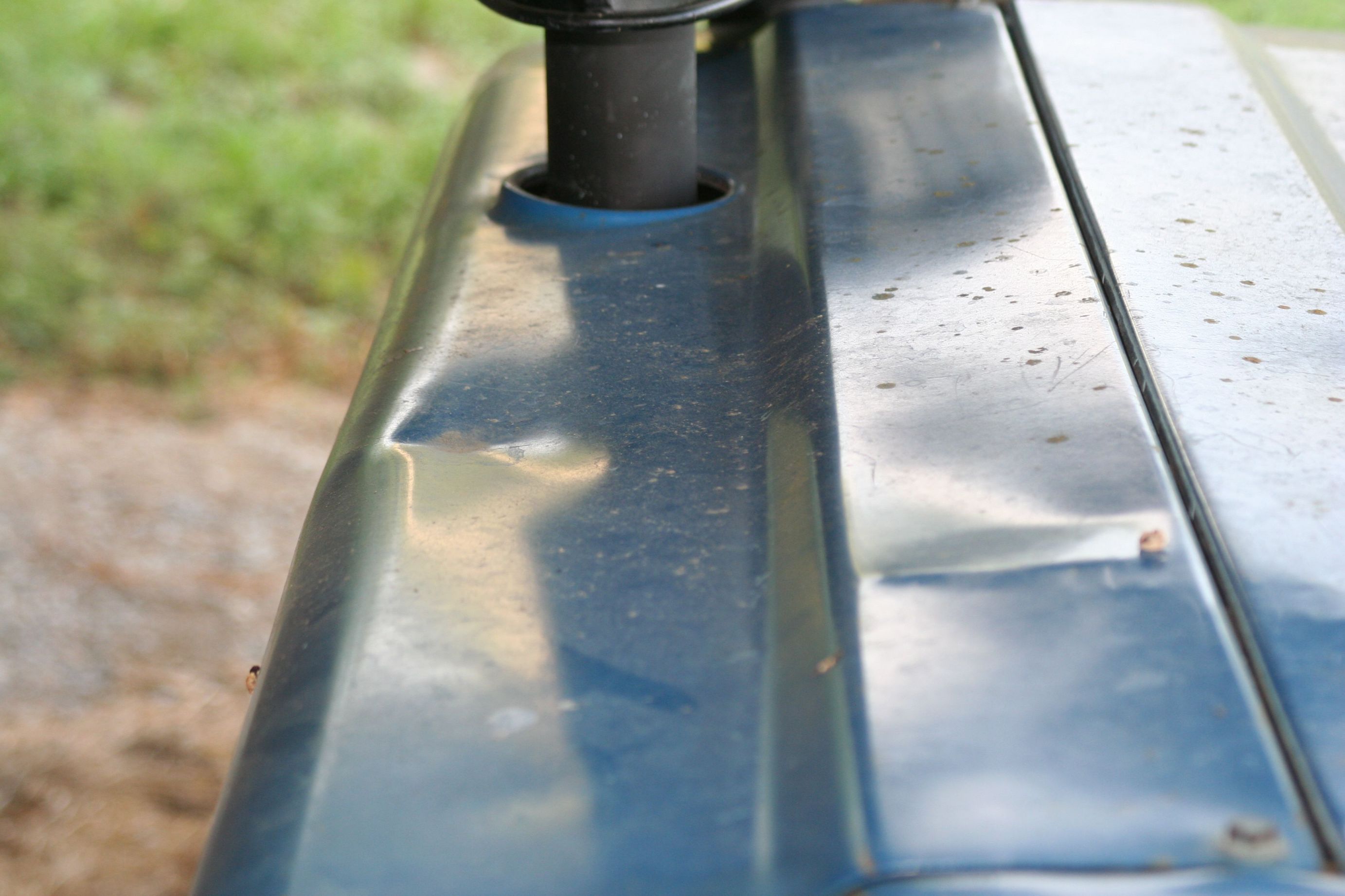

I don't have a dent hammer, and don't even know what a rubbing block is, but I can probably figure it out. Like you said, it will be fun. Which by the way is half the point for those who still question my sanity. :D I get as much enjoyment from taking care of my stuff as I do from using it. I know what you mean about her not being a parade queen, but she's mine and I want her to look as good as I can get her to look.:
Google body work.. and you can improvise tools.. everything from a simple as a hand sized piece of 2x4 and a small hammer with a large flattened head can do some pretty superior body work with patience. Just don't overwork the metal.. you can actually stretch it.. though tractor tin is a wee bit thicker than car body panels.. so you have more 'meat' to work with.
When yuo re-glass the nose.. don't be afraid to use a stiffener made from hardware cloth or tin flashing on the underside as a form for the cloth/resin till it sets. I've used that 1/4 and 1/2" hardware cloth as a template or framework for many a filler/resin/cloth project.. it's a good crutch or cheat for those of us that lack the real skill of a seasoned body profesional..

Funny thing happened. After i painted my 5000 ( really needed it.. ) My wife see's me out there hooking it up tot he mower one day and runs over and says.." You aren't going to use it now that it's all pretty are you".. and she said it with genuine angst in her voice.
I had to break it to her gently that I couldn't let a 7500$ /70 hp piece of iron set there while the grass gre just because it was shiny... It really took her some time to come to terms with that. i think she really thought i sunk that much cash into a hay ride puller...
Incedentally.. that paint job had a tragic point. I had just painted it and had rolle dit out from under the barn... went inside to get a soda.. walke dback out and it was full out raining.. Went from clear blue to thunderstorm in? 30 seconds..
After the nice 'texturized' paint cured.. i wetsanded it with 400 then 800 then 1000 and re-shot it. in the end it turne dout better as i had that additional coat of paint on top o fthe 2+primer it already had.. but still... My throat choke dup when i walked outside that day and say the dark sky and rain where there had been sun only seconds ago...!!

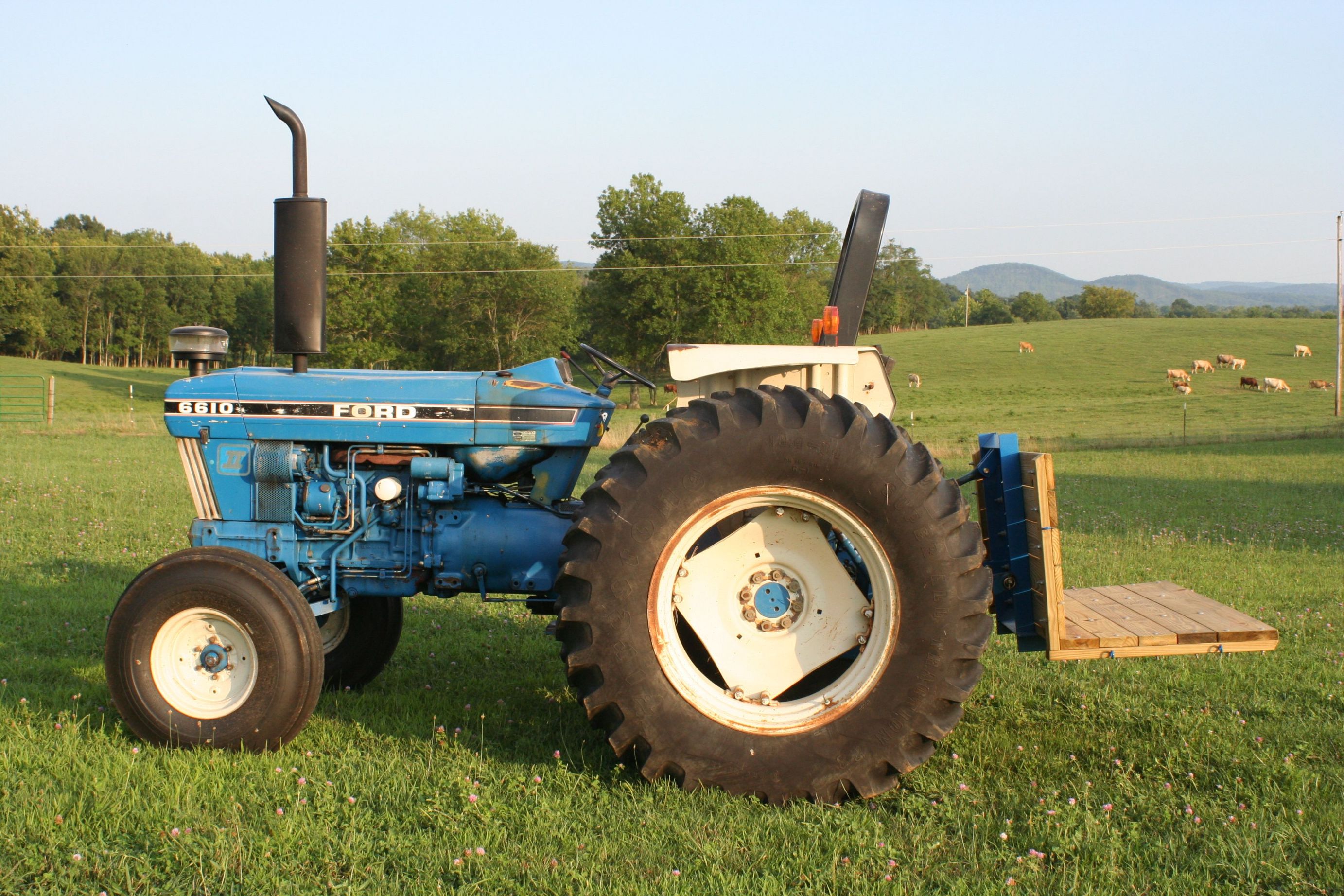

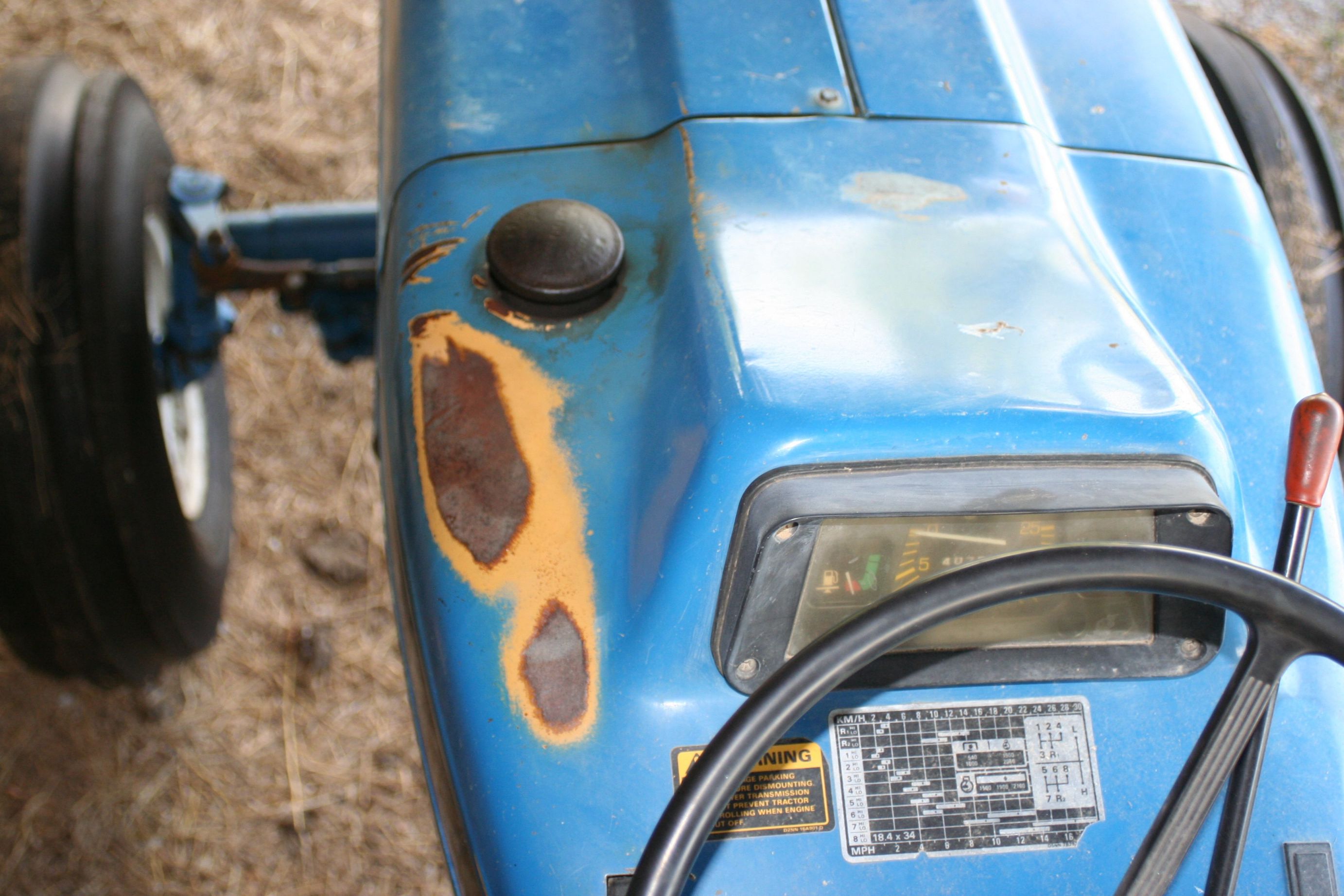

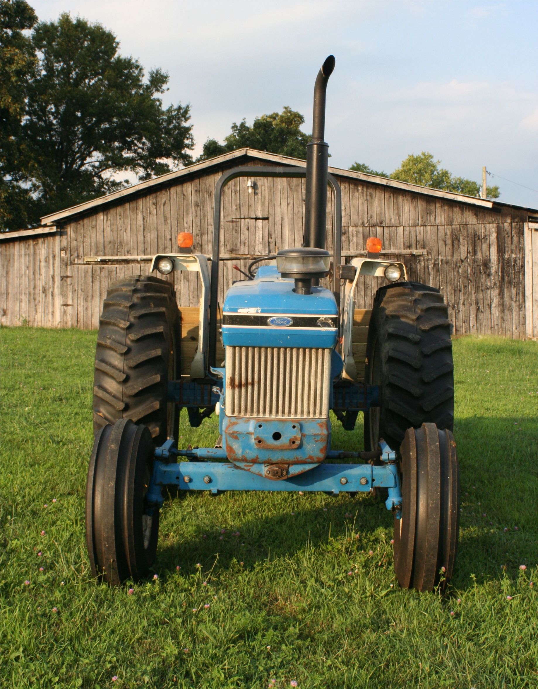

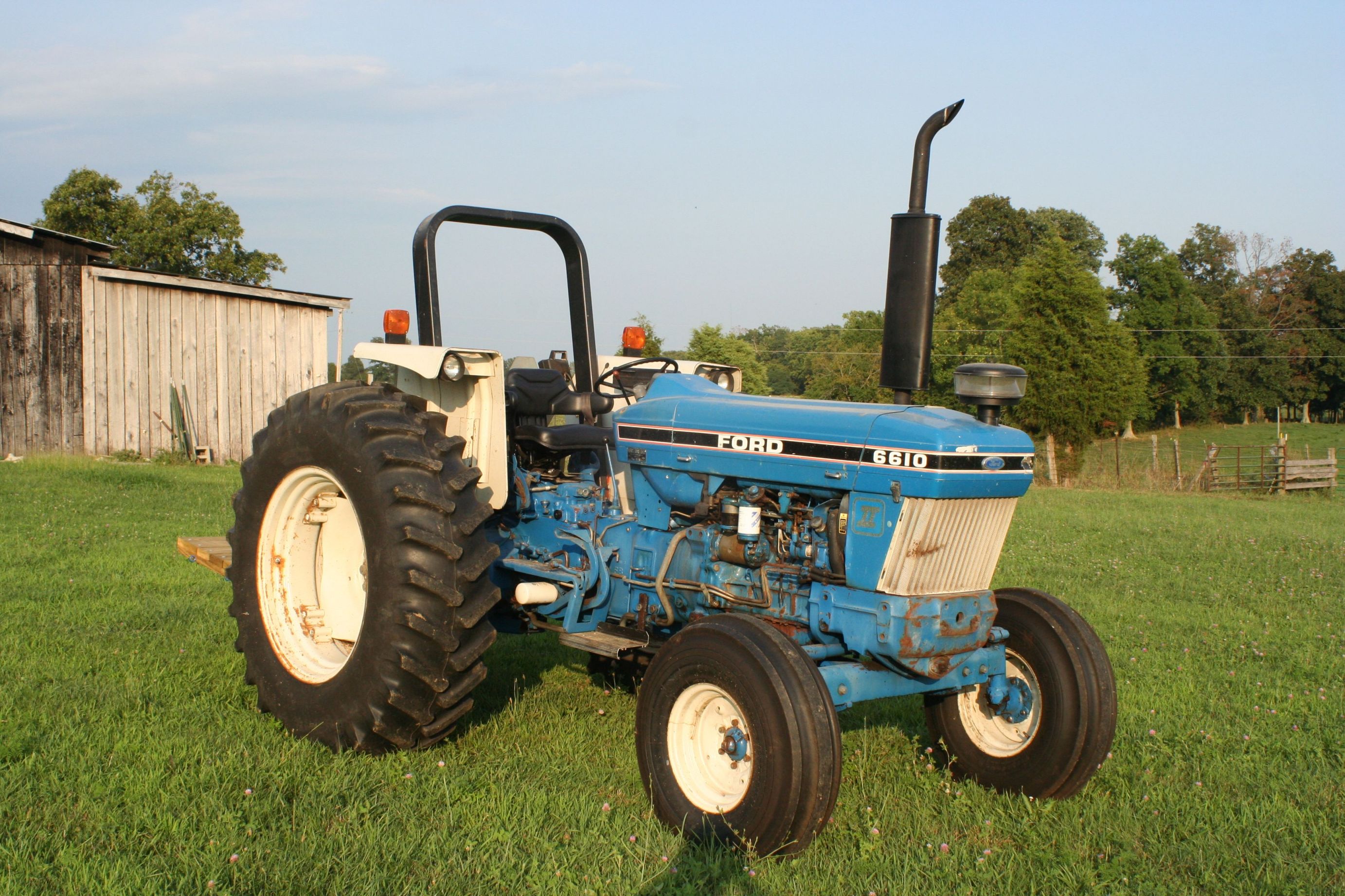

I took a break from working on fixing the doors and ran out to take some better pictures of my tractor. Here's a couple shots showing the whole thing with the completed carry all on the back, and some shots of the areas that I'd really like to do something about, the FG dent, the creased hood, and the places that are rubbed through the paint, primer, and down to the bare metal. It seems that I should do something at least to those spots to keep it from rusting out. Although I do keep it in the barn now, so it's not in the elements all the time.
I can see my wife asking the same question about actually using this thing if I had it back in near perfect shape. For a working tractor there is something liberating about having some "character" because you don't freak everytime something happens to it. The other thing that just kind of dawned on me, I'm getting a FEL mounted next week. You won't hardly be able to see the tractor once that thing is on it! :rolleyes:
