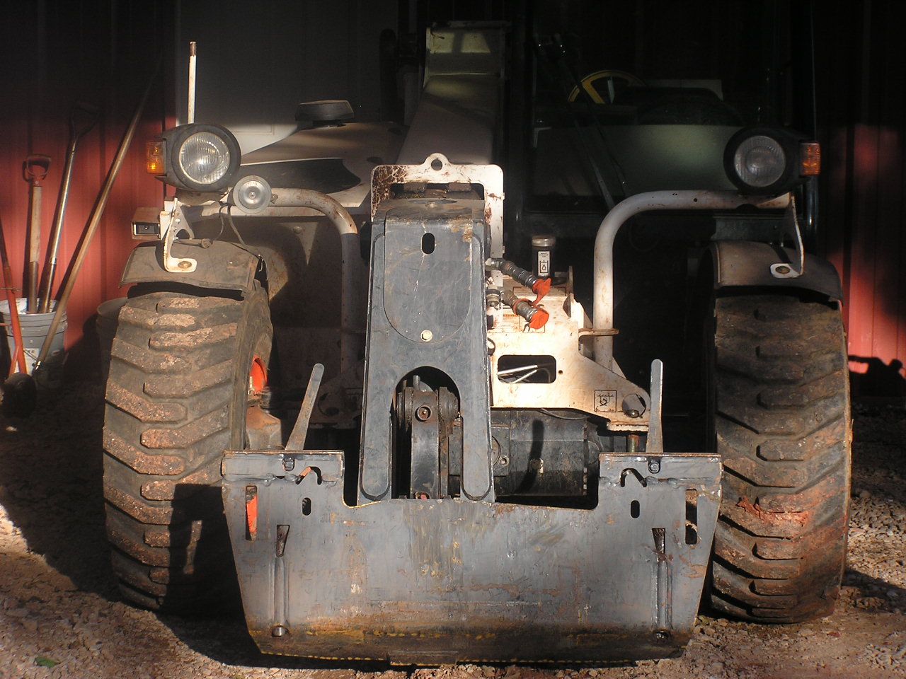

I realized it immediately and I moved the chain to center on the subsequent pulls. I plan on bringing home pallet forks when I bring the tractor in for the 50 hr service. I already have the hooks for the bucket, they will be welded then as well.
I agree with Gary and I think it is more likely to bend pulling at the center of the bar. I looked at your pictures first, and said "not good" when I saw the chain in the middle of the bar.
It looks like there is room on the back of the attachment plate for hooks. You can use a short chain to each side, and hook your pull chain in the middle of it. That way you can remove the bucket and get maximum lifting force.
My attachment plate has slots in it that I can hook a chain in.

You usually have about twice the lifting capacity with the 3PT than the FEL, just not the height. Drop the chain over the top down to the base of the pole with a lark's head knot or a clove hitch and hook it tight to the center of the blade. Pull at just a slight angle, helps the chain bite, instead of straight up and the post should pop out. Pull all the posts out and then use the FEL to finish the job moving them where you want. This will prevent torqueing the FEL like the video shows. If you use the FEL you must be dead center with the load. Even with the 3PT you want to center the load to avoid torque.

great way to torque a FEL !!! use the 3 point to lift /break it out then use the fel to hoist it out. Not a good use of a FEL IMO
