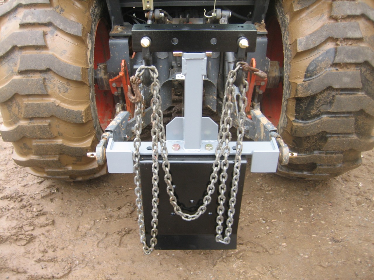

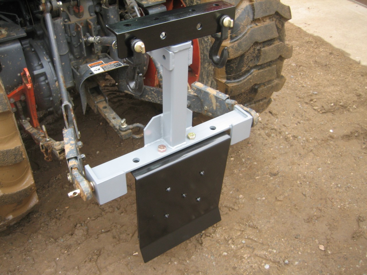

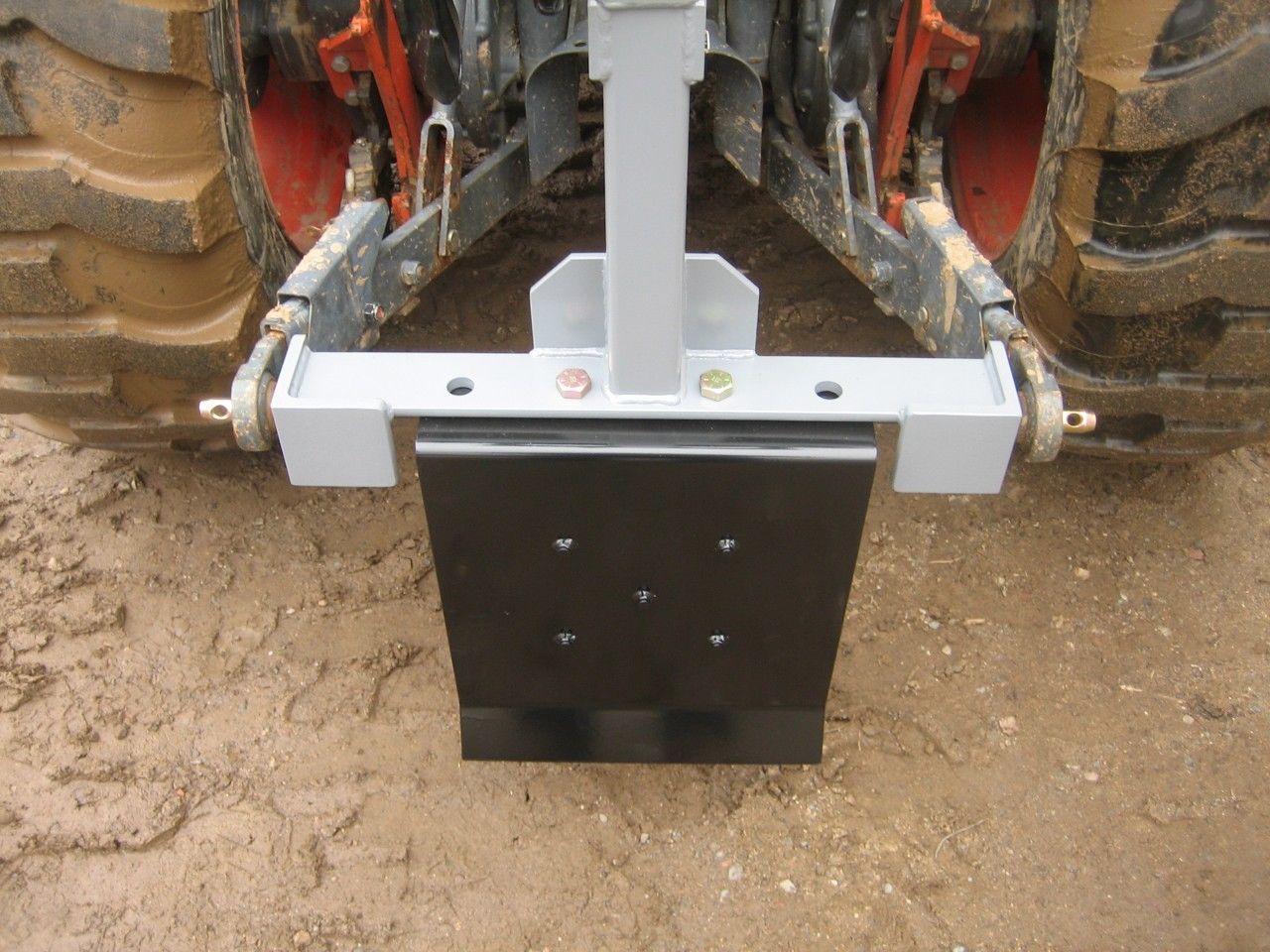

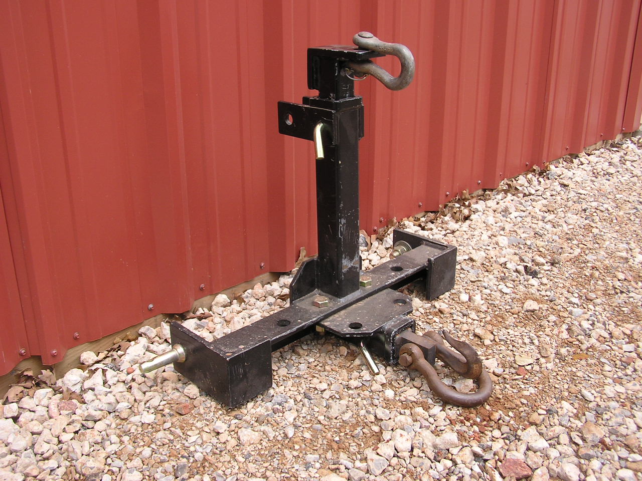

Sorry I missed this earlier. The skid/hitch attachment looks like this:
[ATTACH[/ATTACH]
I attach a chain to the hook on the skid/hitch attachment, and the other end goes to the brush grubber (short chain in that case). I can back over near posts, hook up the grubber jaws, and then use the 3-point to pop them up vertically out of the ground.
THANKS! I like that skid/hitch attachment. Did you make that?
Got it on eBay -- when I was looking around a couple years ago, it was the best option for skidding logs and acting as a trailer hitch. Looks like they are still selling this design:
Heavy Duty Three Point Tractor Trailer Hitch | eBay
At the time, I remember them shipping quickly and packing it real good. I would buy the same one again if I needed to!

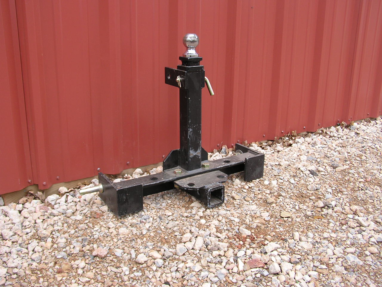

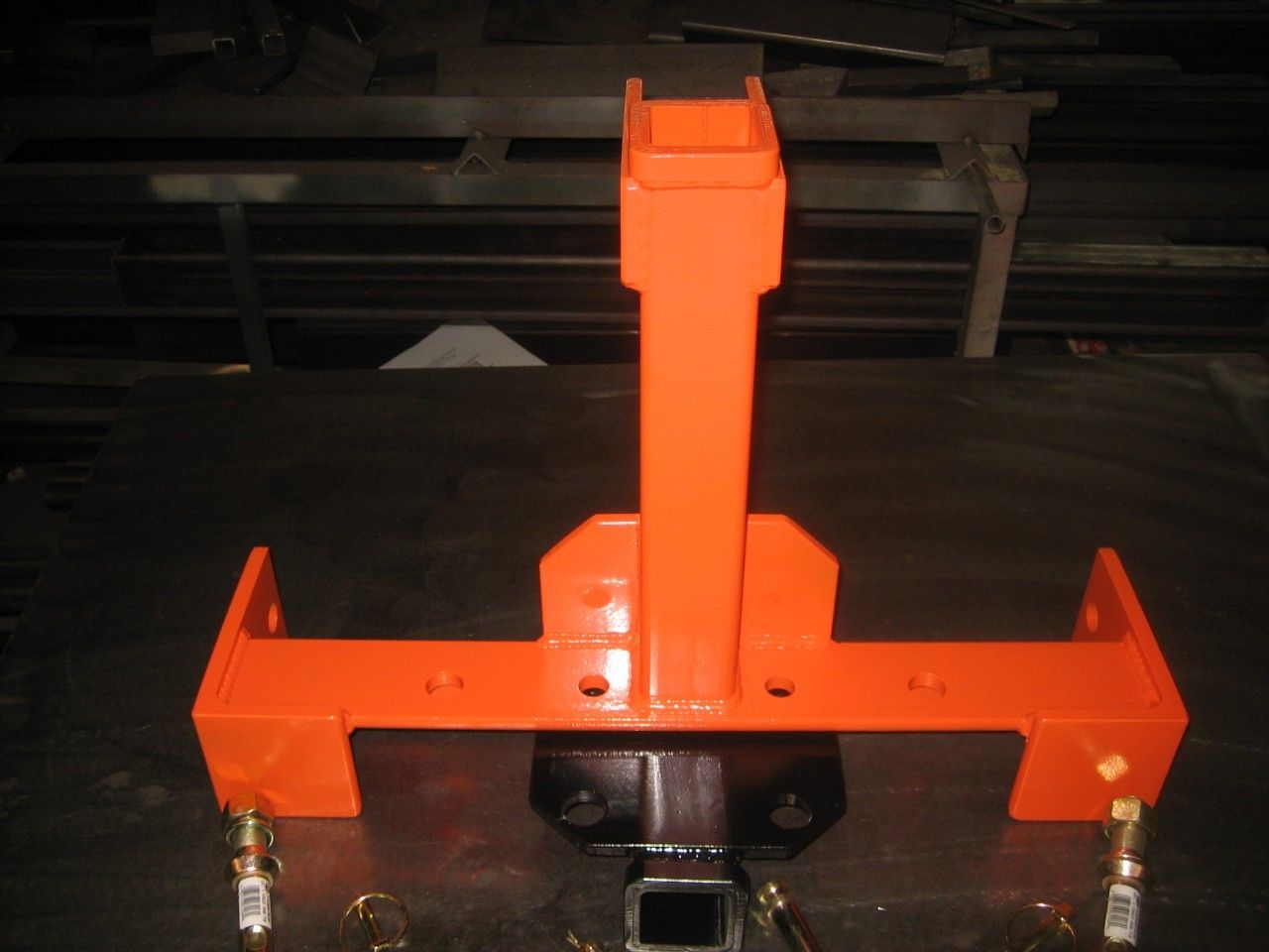

This one is more versatile: omni-mfg | eBay
That is the style that I posted earlier.

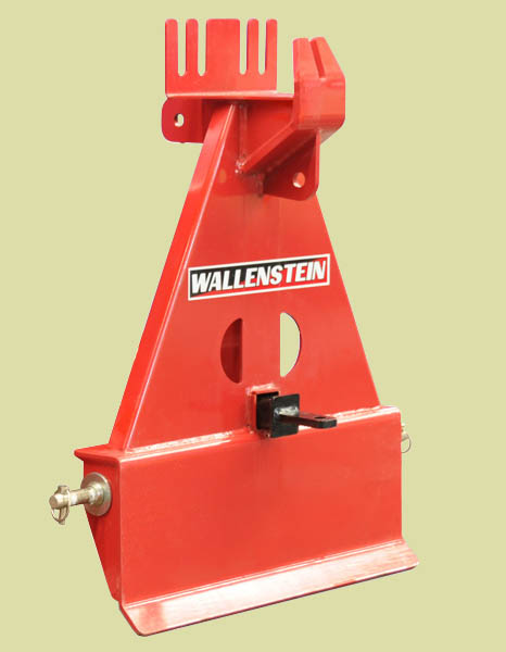

This is much better than the above types for logs, and will still pull a trailer.
Log Skidding Plates
