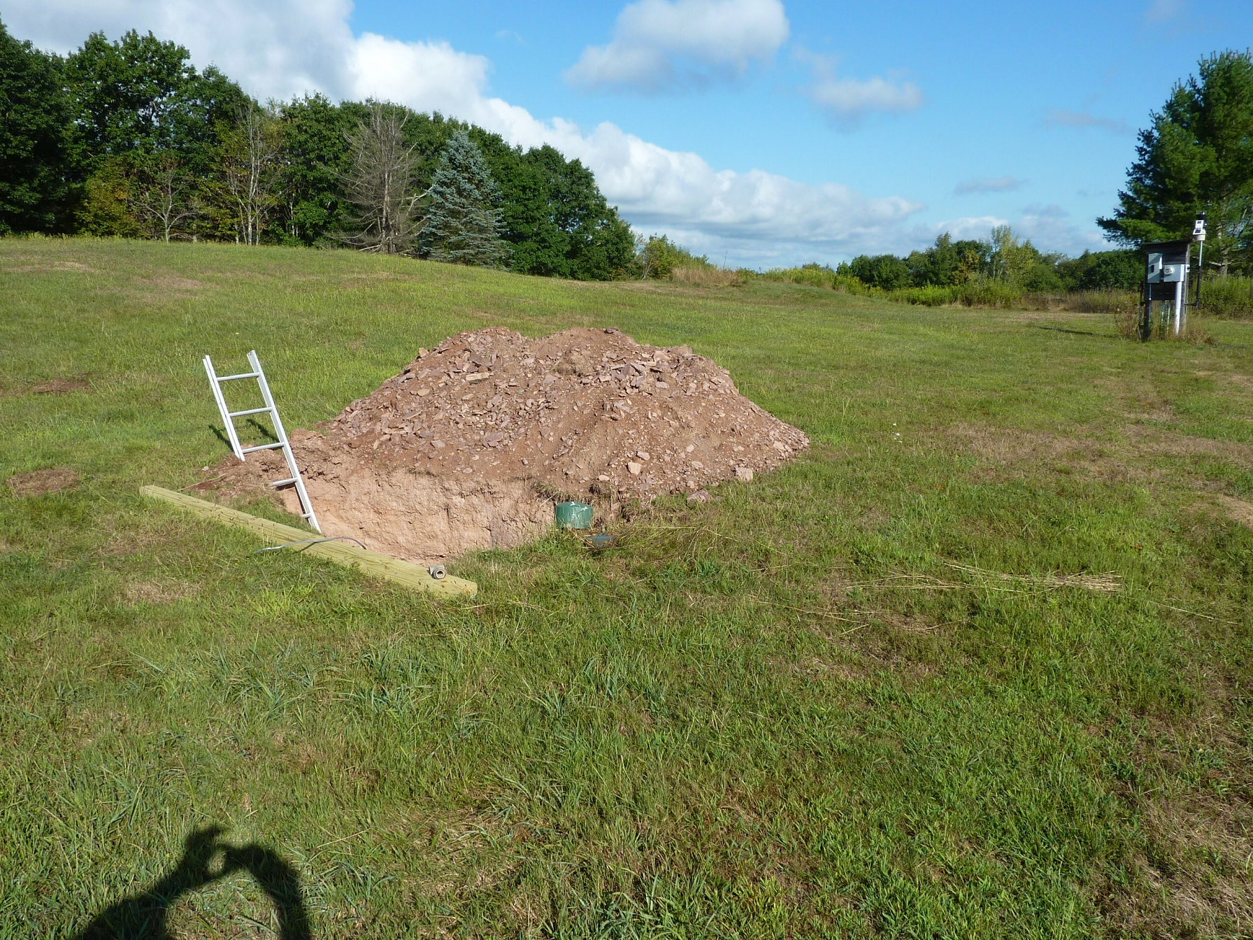

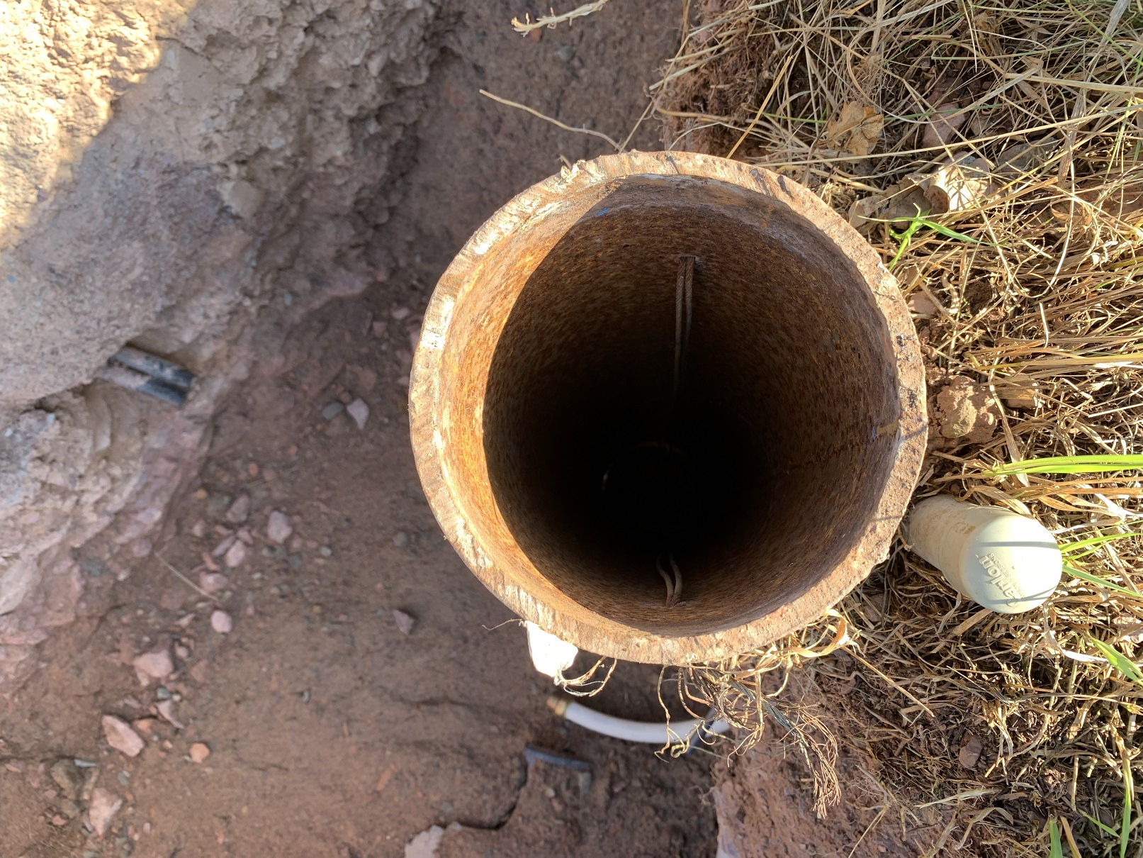

I didn't think this thread would generate so much interest. Since it has, here are a few pics which might better explain the situation and answer a few questions.
Location:

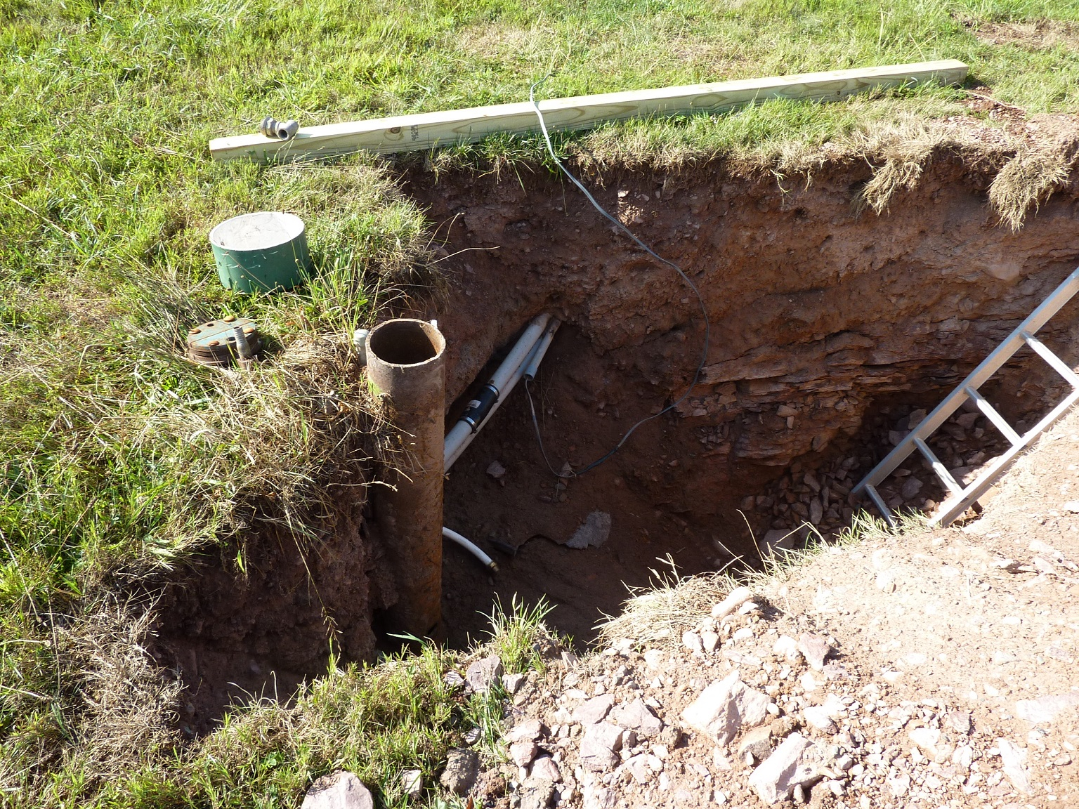

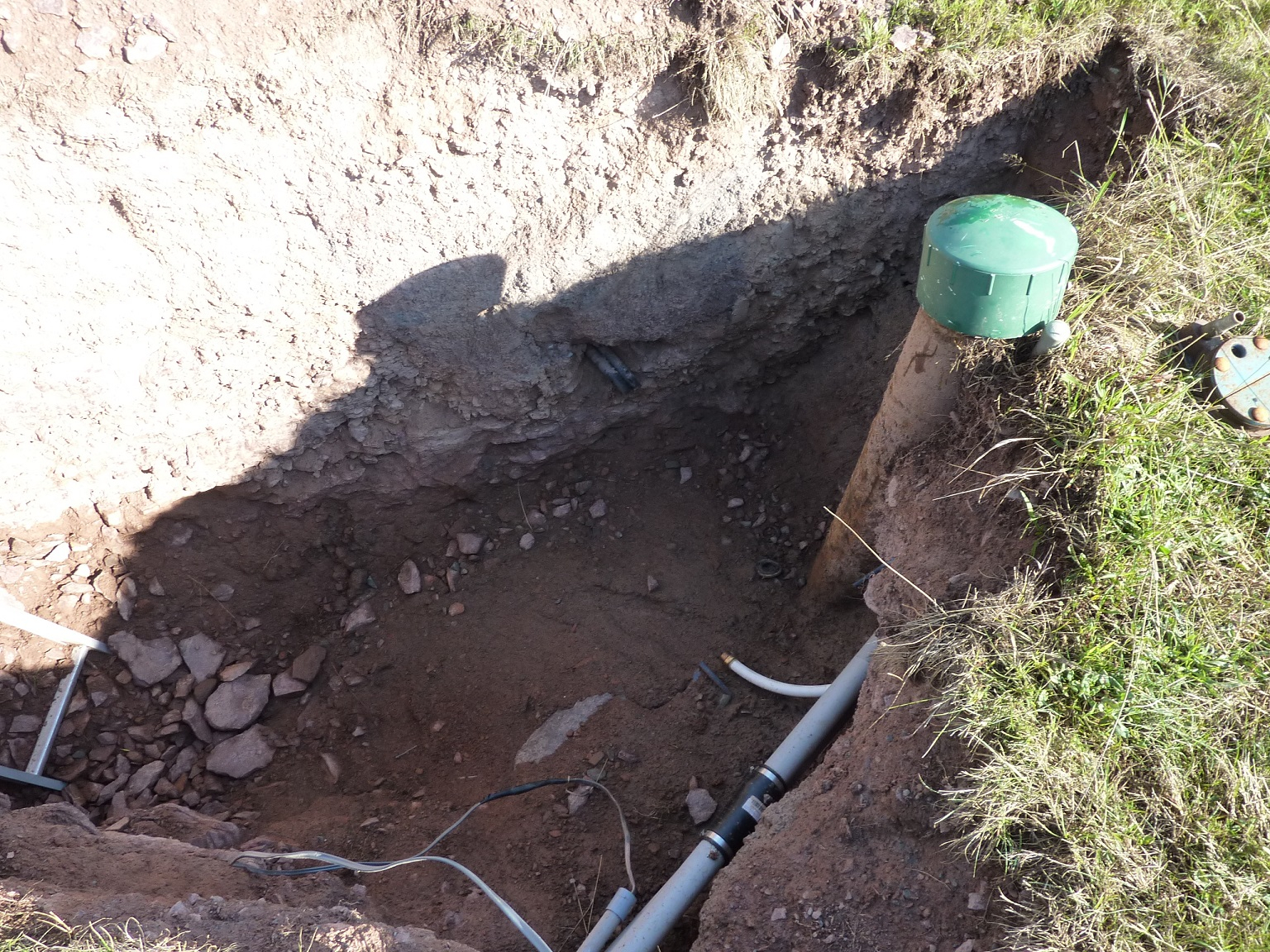

Excavation:

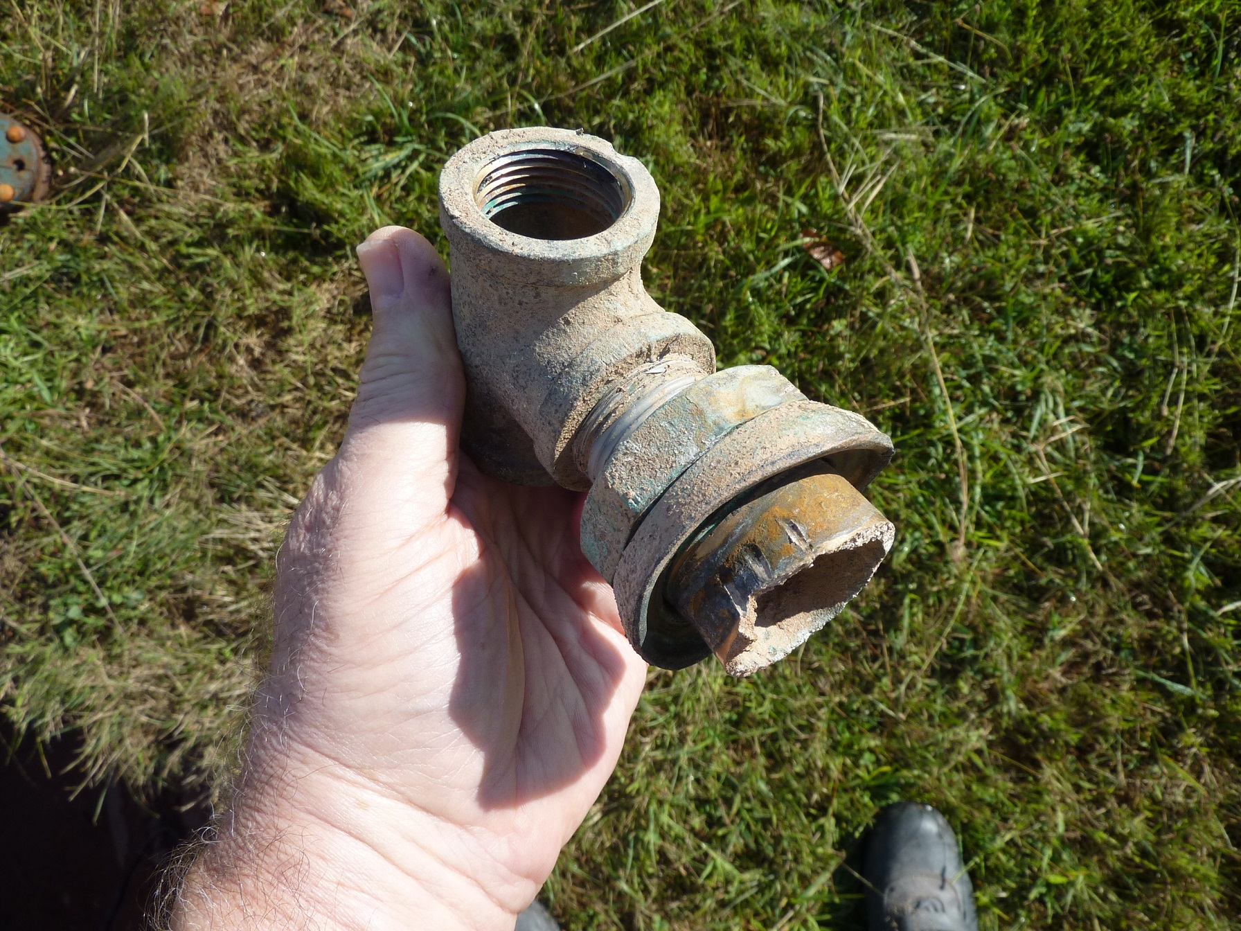

Broken pitless adapter and hole where it entered the casing:

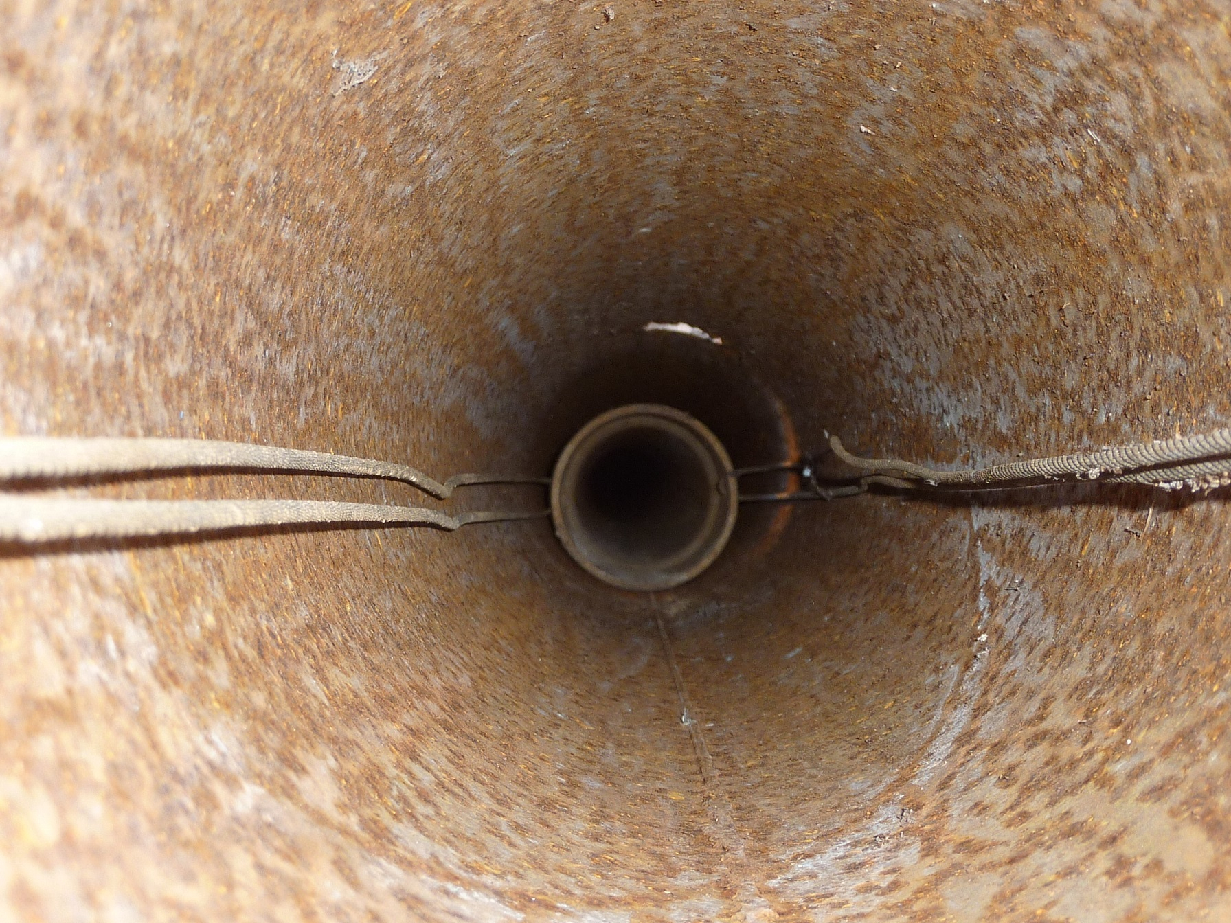

A view inside casing showing the packer.

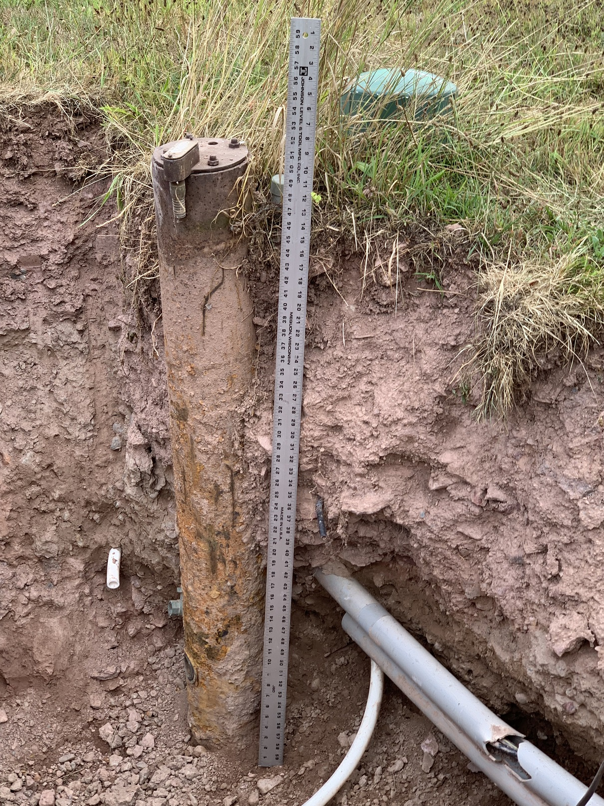

It appears to be a foot or so below the hole for the pitless adapter and 4 - 5 feet below the well head. The support cables were hanging loose in the casing. I was able to grab them to get them out of the way. They are slack and not holding any weight. I pulled hard by hand but wasn't able to move the packer. There appears to be clearance between the packer and casing but it's wedged in place. Pulling hard on the cables will just break off the PVC collar. I might be able to lower a grapple into the packer bore and grab the lower edge if the supply pipe isn't in the way. The casing could be damaged if I do get it out though. You can see from the above pics how corroded the casing is. I'll have to ask the well guys when they come back next week.

Good pics, not the reason for, I mean the quality :).
Explain to me what the purpose of the packer is? My apologies if it's already been explained and I missed it......Mike
   / How to Recover a Lost Submersible Well Pump #100
Thank you so much for the pix. Explains a lot.
