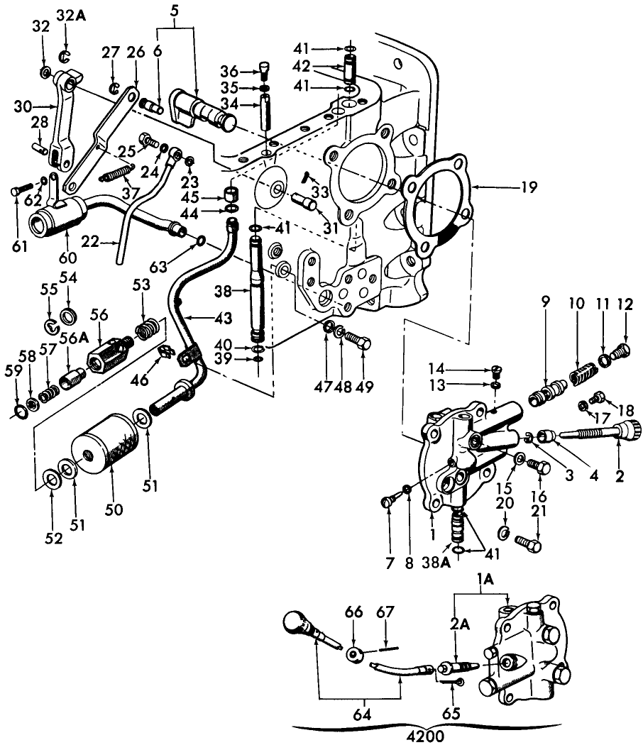

Can someone tell me where to purchase the suction filter with the metal mesh.

TydeFarm//
C5NNN832B is the return filter (#50) in diagram. The suction filter is #60 in the attached diagram.
60 1 C5NNN994M FILTER Filter & Pipe Assy., Suction, 2000, 3000, Except 3550, Years: 01/01/1965-03/31/1968
60 1 C7NNN994B FILTER Filter & Pipe Assy., Intake, 2000, 3000, Except 3500, 3550, (Not Shown), Years: 04/01/1968-01/31/1975
60 1 C5NNN994S FILTER STRAINER Filter & Pipe Assy., Suction, L/Independent PTO, 3550, 4000, Replaces C5NNN995R, (Not Shown), No Longer Serviced NH-E., Years: 01/01/1965-03/31/1968
60 1 C7NNN994A FILTER Filter & Pipe Assy., Intake, L/Independent PTO, 3500, 3550, 4000, Replaces C7NNN994C, (Not Shown), Start Year: 04/01/1968
60 1 C5NNN994L FILTER Filter & Pipe Assy., Intake, W/Independent PTO, 3550, 4000, Replaces C5NNN994E, (Not Shown), See Service Bulletin 4T Jan. 1970 (North America)., Start Year: 01/01/1965
So, if your tractor is a 3000 and earlier than 03/31/1968 it is C5NNN994M. From 04/01/1968 it is C7NNN994B.
As said, try Messick's. You could also find dealers through an internet search for the numbers.
