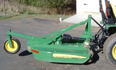

When my LX4 cutter (bush hog) was delivered, I couldn't raise it more than 1" higher than the set height for cutting. The problem was my top link was longer than the draft arms. Simple geometry then causes the top link to want to push the trail wheel back into the ground when the draft arms are raised, after the slip in the top assembly is taken up. The problem was caused by the dealer delivering the LX4 with the lift pins in their upper holes. I moved them to the lower holes. This caused the top link assemble to rotate closer to the tractor.
When I raise the LX4 with top link in place and properly adjusted for mowing height in the back, the draft arms raise both the front and the back. Here's a pic.
I find that the top link, even though it has about 4" of play in the LX4 top link assembly, is way too ridgid on my uneven ground. I have replaced with a chain. I use snap hooks at each end of the chain. The small end of the snap hooks let the 3/4" pins slide through.
Ralph
   / how to service and use a brush hog #17
NOTE. In the picture, this is with the top link adjusted approximately right for cutting height. If shortened (like when they delivered it and had to take it down the trailer's steep ramp), it'll raise quite high.
With the chain in place, the front raises about 3-4", and the tail wheel stays on the ground. This has been enough to go over rises in the ground without the cutter hanging up. I run back to idle and cut it off if there's any danger in the blades hitting something over really rough ground when I have to move from one area to another. Otherwise, I can just raise it and leave it rotating.
