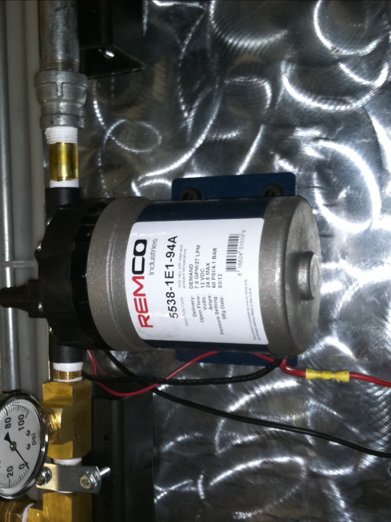

I have a sprayer that I made from a 275 gallon tote. It has this 12 volt pump. It will be on my 3 point hitch, have a deep cycle battery. I want to be able to switch it on/off from my tractor seat. Do they make a switch pre-made that would work or be adapted or guess I can make one from scratch. The Fimco switch Northern sells is a little too small gauge. It heats up too much.
And advice on how to wire this, what’s switch and wire to use? Thanks.

Your problem is the pump draws 25 amps. You need 10 gauge wire and a switch rated at 30 amps at 12 volts. As a simple solution. A higher voltage switch will work too, but will cost more. Relay and less rated switch might be cheaper but at the cost of complexity.
If cost is an issue... use 10 gauge wire and a standard household light switch mounted in a box. It will last a few seasons or longer. The switches are at Home depot for $0.39 :2cents:

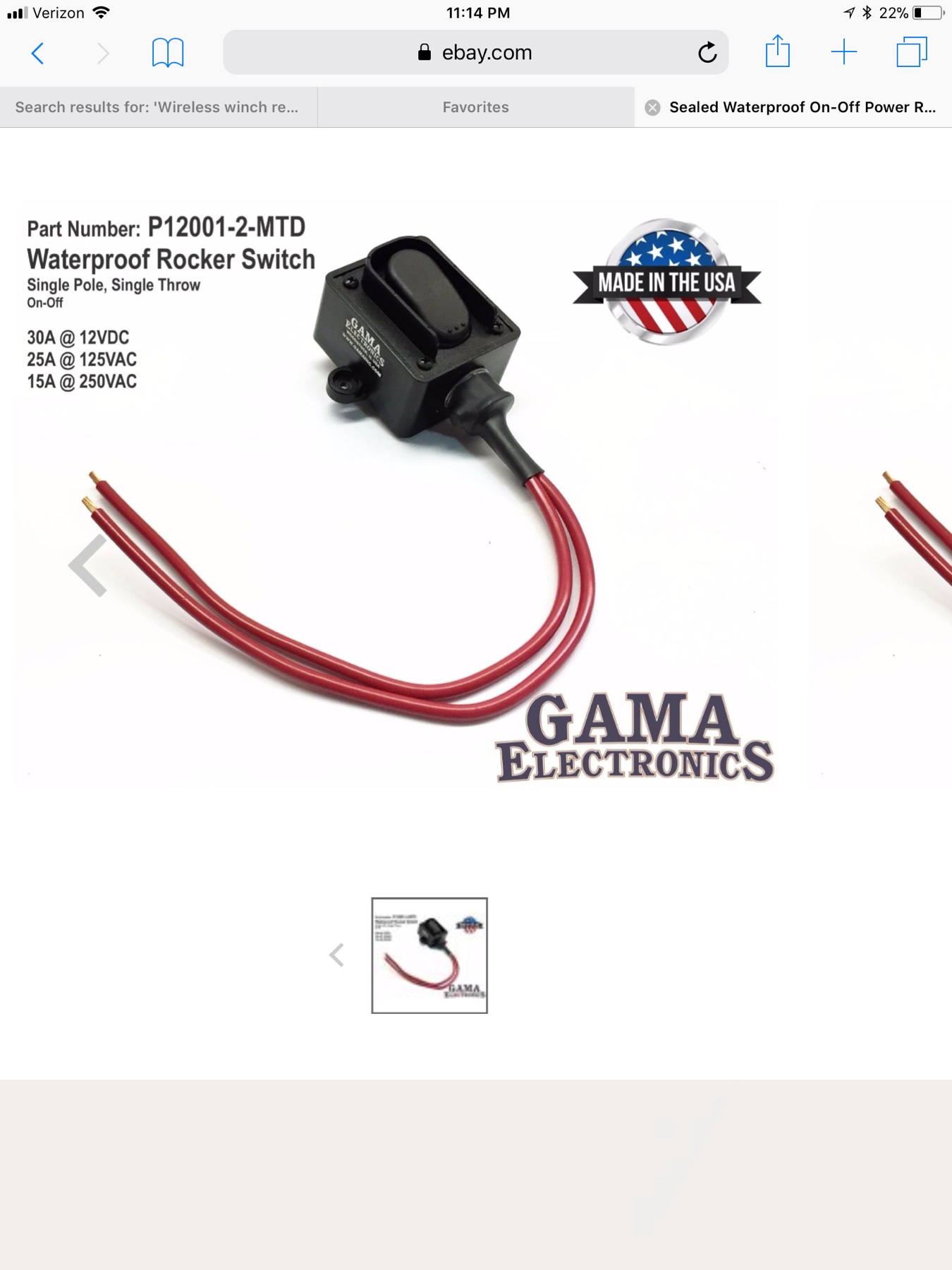

If I don’t use a relay, guess this switch would work, with an inline 30A fuse?View attachment 567642
Yes, that one should work. You would probably need to make an extension cord for it so you could reach the switch. You could probably get away with 12/2 wire.

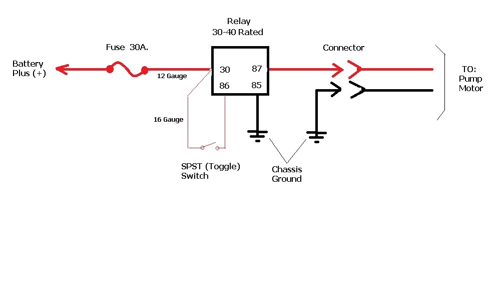

No. The longer the wire, the more voltage drop you get. Keeping the wire short means more power gets where its suppose to be & less lost heating up the wire. It's also slightly safer as you have a small fuse protecting small wire for the switch. So if that small wire gets broken there isnt much arcing before the fuse blows.
Probably not relevant here, but a relay can be cheaper than the cost difference between a long big power wire & a small wire to run the switch & relay. Copper isnt cheap. Save weight too, which really isnt a tractor issue, but is for other vehicle types.

Go with DL's solution, or similar, he's on the money. If your battery is mounted on the sprayer and you charge it up separately, you mount the fuse and relay at the battery /pump unit and run a light gauge cable to a switch on the tractor. If you spend a bit of time up front, you'll reap the rewards in time. So wire it through a plug and socket of some type, install your switch somewhere you like, then all you have to do is drive up, hook up 3pt, plug cable from sprayer onto tractor and drive off, when you get to where you need to spray, you flip the switch you have mounted on the dash or guard etc. If you want to charge the battery as well while you are driving, or run the sprayer directly from the tractor, you need to add a heavier fused supply through the same plug/socket that goes to your battery or to supply the relay. Do it right once........YMMV
