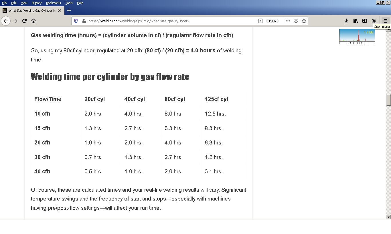

I'm about to get my first gas bottle. Size and budget are pretty loose. Wouldn't a 125 cu ft bottle of C25 is as good a starting place as any?
I plan nothing but farm repairs and mild steel fabrcation.
   / How to transition to MIG? #124
125 is good IMO
I use mostly 80’s only because I have bottles on multiple carts and consumption is low. 80 cu ft bottles are so easy to handle also.
   / How to transition to MIG? #125
How long do those 80 cf bottles last? (In hours, or ft of bead). My projects are generally repairs rather than fabrication so 80 might be sufficient.

I found this page a few days ago. Hope it helps.

What I remember is it costs about the same to fill a 125 or an 80 bottle. So I bought the 125 bottle. They are getting heavier as I get older. But I am getting more creative on having to move them.
   / How to transition to MIG? #128
Thanks! That's just what I needed.
Four hours from an 80 cf tank sounds like enough for practice and minor repairs in the first year. Then the next fill should be multiple years after I know what I'm doing.
