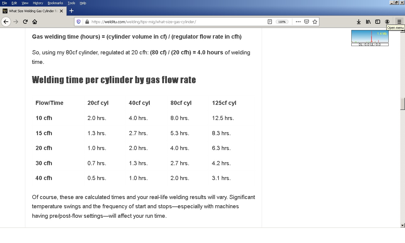

I found this page a few days ago. Hope it helps.
Interesting, now I know how much I really weld per year! Not so much. :ashamed:
What I remember is it costs about the same to fill a 125 or an 80 bottle. So I bought the 125 bottle. They are getting heavier as I get older. But I am getting more creative on having to move them.
Did the same... bought the 125 knowing it was more capacity than I really needed but the LWS had a better price on it vs. the 80 so it was sort of a no brainer.
Yea, I weld in spurts. I usually don't weld when it's real cold or real hot. I just put a new bottom on a friend's shredder. It took about 3 hours of gas and about 2 hours of beer. When I was in MIG class I only welded at class. They let me come in and weld as much as I wanted so I was there almost 4 days a week. I am retired with nothing to do so I was getting my money's worth at school. Plus all the supplies were paid for and I got to use a new Lincoln 350 MIG welder.

I can weld for several hours but gas used could be measured in minutes if not seconds. So much is in the prep and set up. The actual welding time in a hobby shop is quite low compared to the hours spent making whatever.
   / How to transition to MIG? #138
Then add the time to try various settings on scrap to get dialed in. After fabrication and setup then actual production 'hours' is only minutes. I could never earn a living at my production pace. :laughing:
But really, getting something repaired and back in service in hours instead of taking it to town to get welded, makes it all worthwhile. Plus its interesting.
