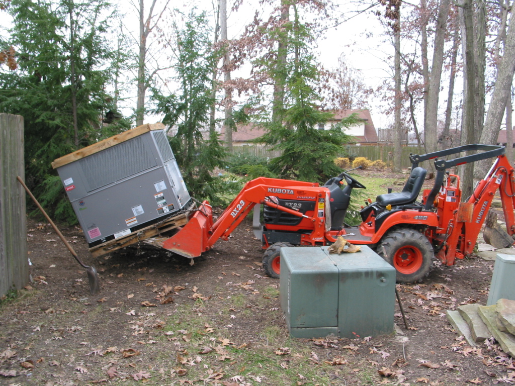

This is how I moved a 500 lb HVAC unit about 75 ft. Pulled it part way off of the trailer, lifted the end and then rolled the bucket back to lift it. I didn't realize how precarious it was setting in the bucket until after I took the picture. Couldn't get it in place fast enough then.

Thanks to all for all the advice and thoughts. I think the plan will be to first attempt to hook the 3PH and backup the driveway to keep the tractor from tipping, I will still have the FEL to counter balance anyhow. Second plan if the first fails is to wrap few straps around it and drag/pull up the driveway. I'll make sure to take some pics and report back later this coming Friday.
