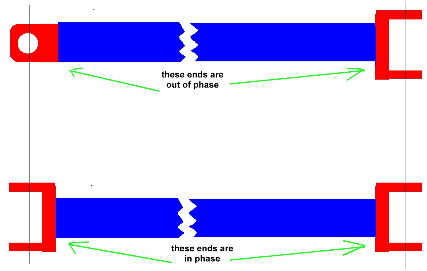

1) Make sure the universal joints on the PTO shaft are "in phase". I'm not sure if PTO shafts are keyed so they can only be put together one way - if they aren't, the U-joints might be 90 degrees off from each other. Best way to explain this is a picture (See attached.)
2) Adjust the top link so the input shaft of the chipper is parallel with the PTO shaft.
If the joints are in phase and the shafts are parallel, then it should be able to operate at 540 RPM through a wide range of angles.

Well, I checked and rechecked. The shaft has notches on it and it is definitly in the right position. The shaft when hooked to both ends is as solid as can be and is in phase.
The only thing is the angle as apposed to be completely parallel/horizontal.
Also, the length if the shaft is concerning where maybe it is beyond it's max length and not enough overlap is left. I will try to remove the Quick Hitch and test it without it to see if it changes things.

Well, solved. It definitly was the shaft is over extended.
I removed the Quick Hitch and re-attached and run as designed. :)
I'll and see if I can get a longer shaft or an exchange so I can use the Quick Hitch or it will be for sale very soon at a really good price. :)
