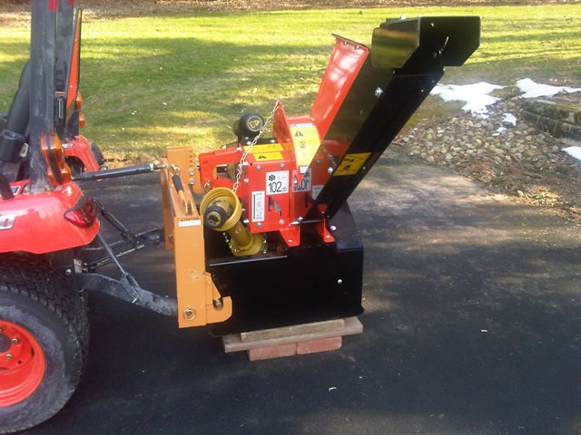

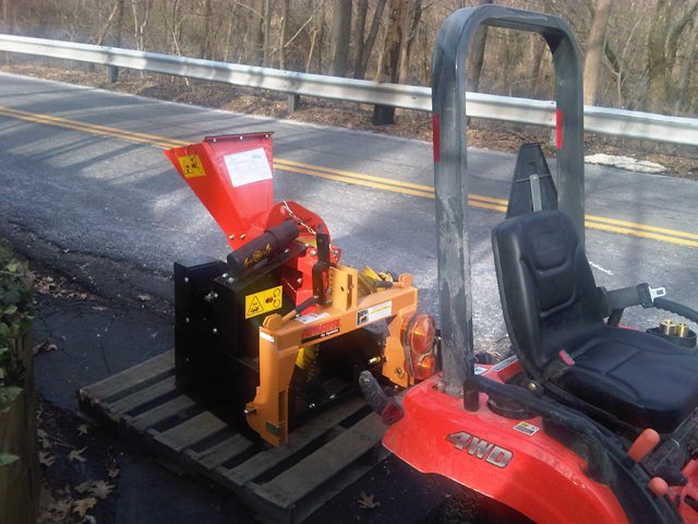

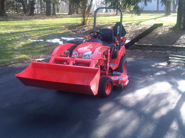

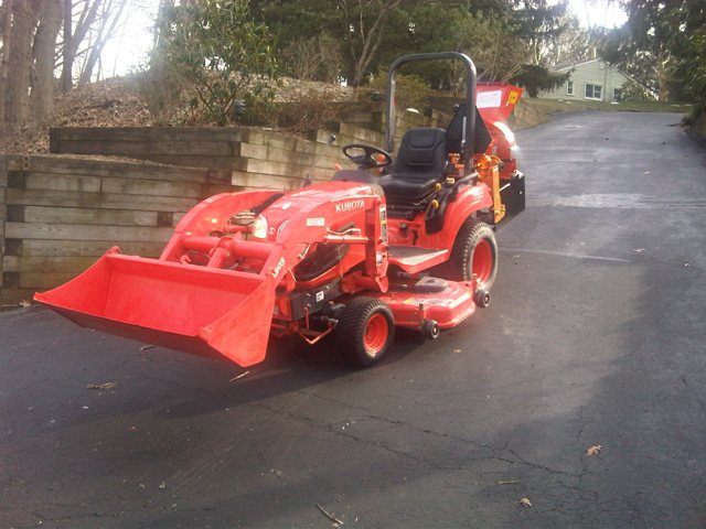

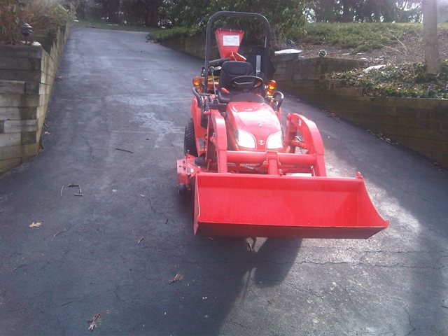

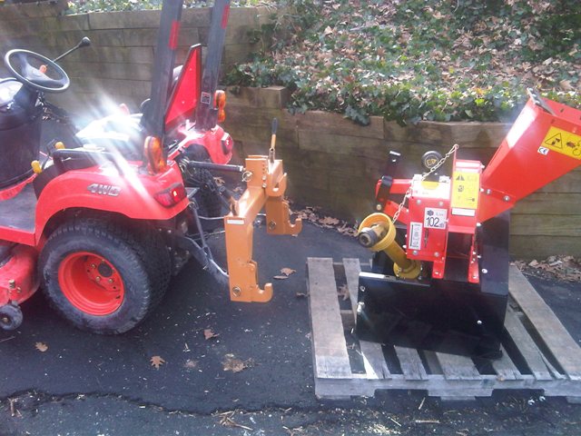

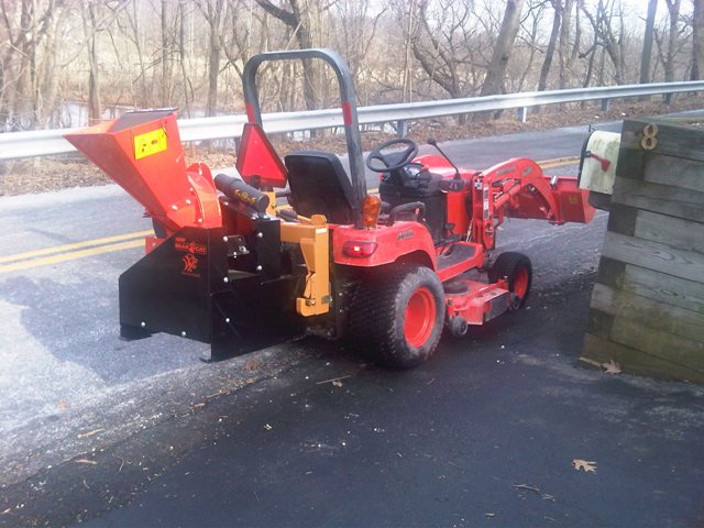

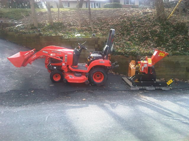

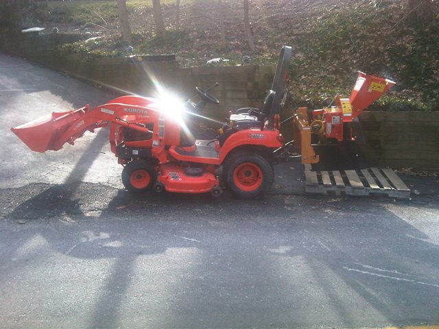

Ok, it's here.
A lot easier than I originally expected, thanks to all for the advice. The BX1860 is some tractor, it did not seem to be bothered at all with the chipper on the back.

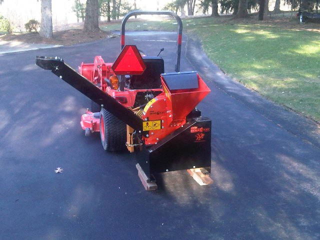

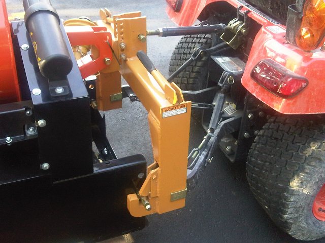

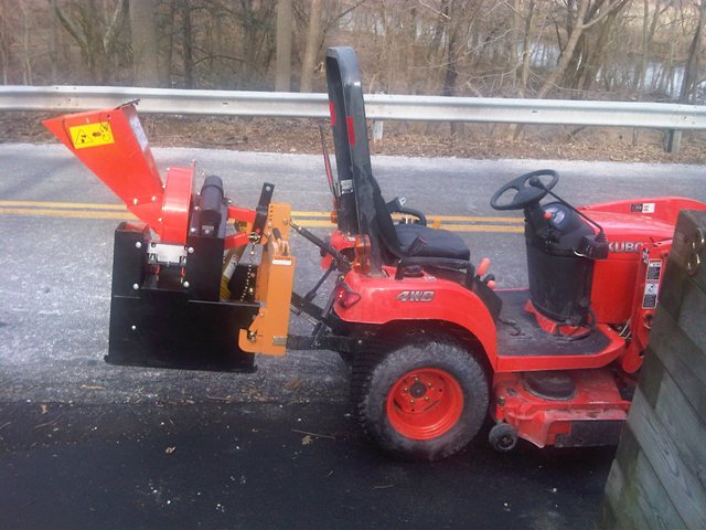

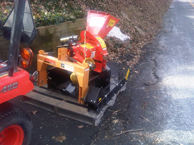

Two questions:
The 3Pt Hitch does not seem to go low enough to rest the chipper on the ground and I have to have bricks below it in order to settle it or take it of the hitch. Is there an adjustment I am missing?
Also the Quick Hitch seems to be too wide for my RB, maybe about 2 inches. The Quick Hitch came with 2 adapters but it did not add enough length to reach the Quich Hitch hooks. Thoughts?
   / How to use FEL to carry 500lbs up driveway? #46
Congrats on your new toy! easier then you thought? thats good.
You should be able to lower it all the way to the ground, how low does yours go? my lower link is a few inches off the ground when I drop the 3pt all the way, doesnt yours do the same ? maybe you need to open the draft control a little more?
I would bolt in a 4 by 4 post on the bottom of the chipper to keep metal off the ground from rusting. this should help a little for your gap issue.

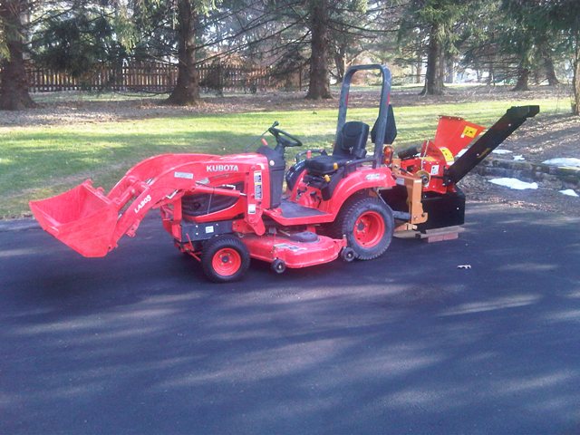

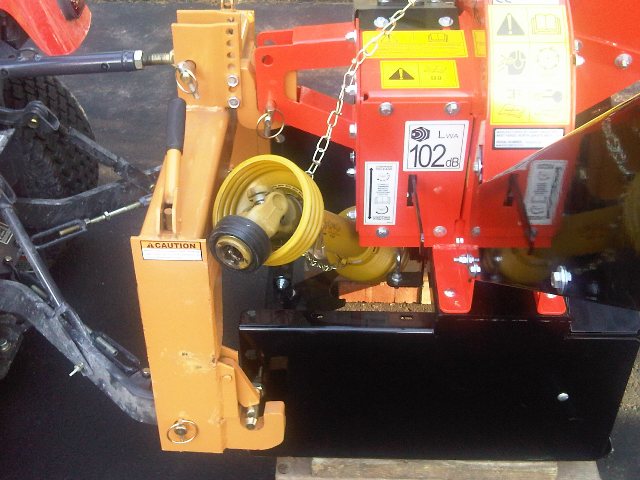

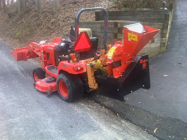

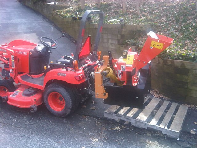

So, I measured the PTO shaft and there was no need to cut it. I hooked it up, raised and lowered the chipper and no evidence of binding. So, I started the PTO but I am getting a lot of shaking in the sleeve and PTO shaft. I took them apart again and re-installed and made sure it is nice and tight but still getting the shaking.
Is that normal?
   / How to use FEL to carry 500lbs up driveway? #48
Congratulations and thanks for all of the photos. I know it takes time and getting on and off of the tractor often for such a task.
The idea of attaching 4x4s on the skids is a good one both to raise it for hooking up the 3 PH and keep it from contacting the ground. Treated wood would be best.
Most chippers that I've seen, and own, have a metal frame underneath them for them to sit on for the "keep off the ground" function.
The PTO shaft will vibrate if the shaft is not almost perfectly straight. That is another reason for the frame on most chippers - to align the tractor's shaft and the chipper's shaft.
Try lifting the chipper with it running (at idle or low speed) to see if the vibration amount changes depending on the amount of the angle off of horizontal. At horizontal it should calm down to nearly nothing. From the pictures it appears that it is lined up correctly so there should not be the shaking. See if the looseness can be identified.
Some chippers need an adjustment to the flywheel to keep things in alignment. The instruction manual may have the adjustment procedures. A friend of mine had a Chinese chipper that we spent hours on trying to adjust this bolt and that one to align the darn thing. Finally got it done but it failed and was returned for other reasons.
The "Quick Hitch" frame is not the best for lifting pins that vary in width from implement to implement. Also they can be a pain if the top hook doesn't have a clear path to catch from underneath. I've owned two of them and sold them in favor of Pat's Quick Hitch arrangement. Too late now, I know. Just a comment for reference.
   / How to use FEL to carry 500lbs up driveway? #49
If you followed the unpacking and setup instructions, it should be ready to go. Try slowly increasing the rpm to 540 PTO speed, the vibration may go away. How much angle was on the PTO shaft when you tried running it? It should be as straight as practically possible for the smoothest operation.

It is at a slight angle from the tractor to chipper, maybe about 10 to 15 degrees. I did try to raise it at low RPM to different hight to be more horizontal and did quite a bit but not much.
The manual says that the max of length extension of the shaft should not be over 25" and I think I am very close to it. If I measure the full sleeve with boot then I am at 28" and from mid boot sleeve then I am at 25". It could be that I need a longer shaft??
