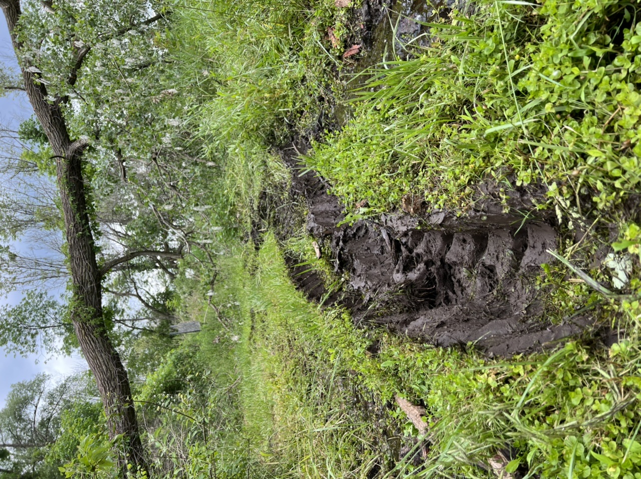

UPDATE : I aint doing NUTHIN for a bit - took a walk last night and that end of the field is standing water - no way am I hooking a chain on that monster and trying to pull it from the upper reaches sideways... I'd then be posting "can i use a winch to the partially down tree to pull my tractor out of the mud" threads...
It's a mess down there now - also - a top of a dead tree came down where I need to pull from as well - so - FIRST I need to clean that up... after things dry out. I will update this thread - but it won't be for a bit - as more rain expected tomorrow and Sunday.

Dunno why the forum turns this picture on its side. But ain’t no way I can do anything to pull on it for a while. This was a close call for sinking the tractor to its frame that I avoided because of experience!!!
Still raining today too.
As for pics of the base and the berm. I had work boots on. Not waders and there was maybe 4” standing water there.
Maybe I can get to this in July… (sigh)

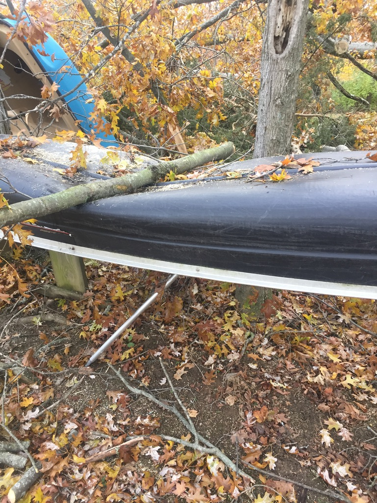

Been following this thread; finally found some pictures of a similar situation I had 5 years ago, maybe not as big as yours. I began by cutting off all the branches, working from small to big, eventually working down the trunk a small section at a time. There was obviously some stored energy there, but it was very anti-climatic, it eventually creaped up (very slowly) after each section i cut off, until the dirt ball settled back on the ground. Even then I was very leery, but by cutting off small chunks at a time, it turned out to be very easy cut it all up and haul it off with the fel. Hated losing my canoe, though.
