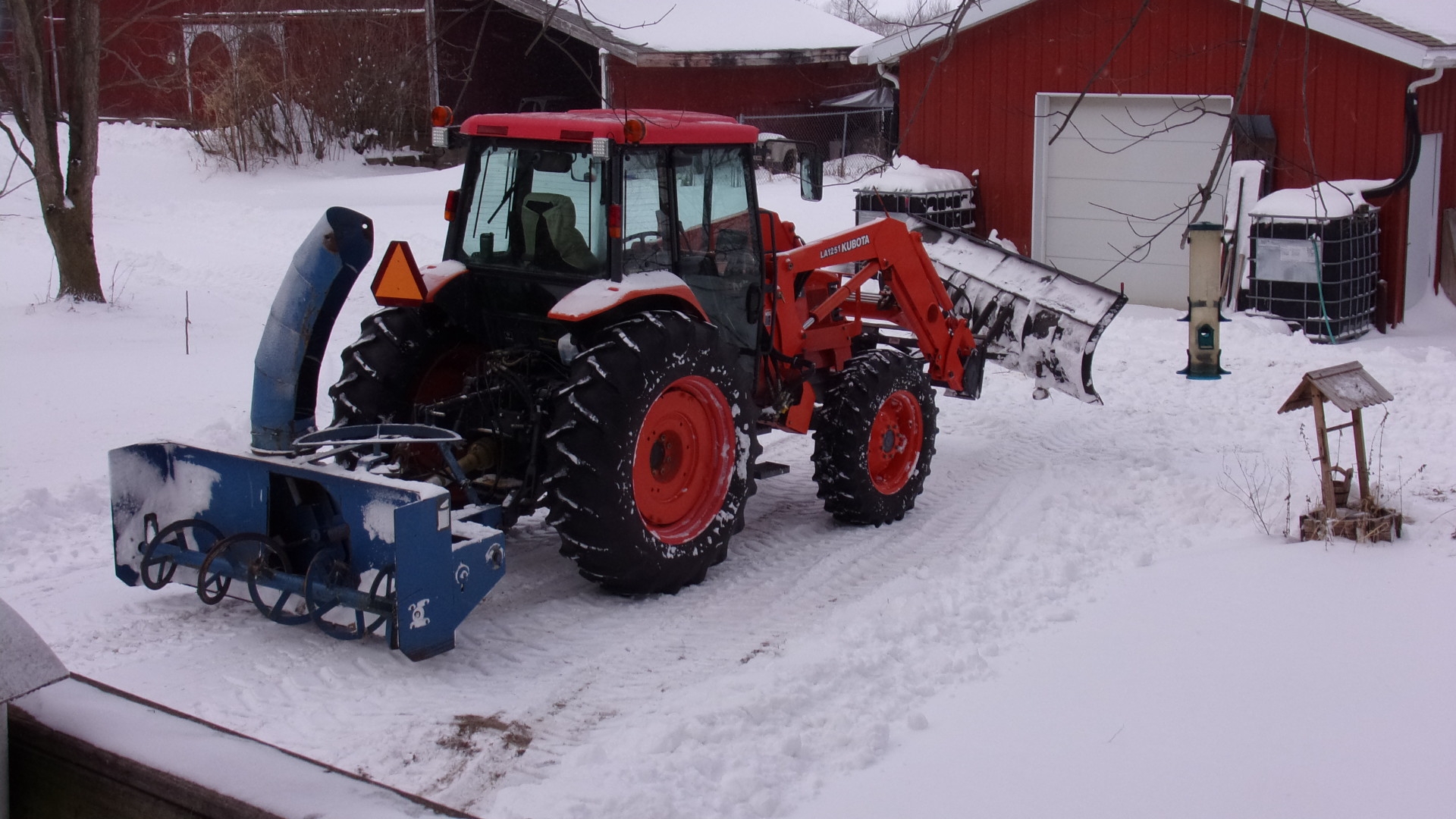

I have a Lucknow as well, but a lot bigger than yours is. Mine is 80" wide (with the wings on) and I've had it at least 20 years and it's a beast. Bought it new and only thing I've replaced on it was the 2 hydraulic hoses that actuate the cylinder that rotates the chute In heavy deep snow, it makes my 87 horsepower PTO M9 bark hard. Up on the turbo and blowing smoke. Mine eats anything including cinder blocks and bricks. Rule of thumb on any blower is... 5 pto horsepower for ever foot of width.
Looks familiar.
Mine has the hydraulic shoot "mouth" adjustment, but the second remote on my old tractor needed a new valve so ......
By spec sheets, my TYM will be lacking a little on the PTO, but like everything with a smaller machine, little bites.
I think I'll miss the 50hp, and hope to get it fixed at some point, but I will enjoy the smaller units maneuverability in my confined property.
