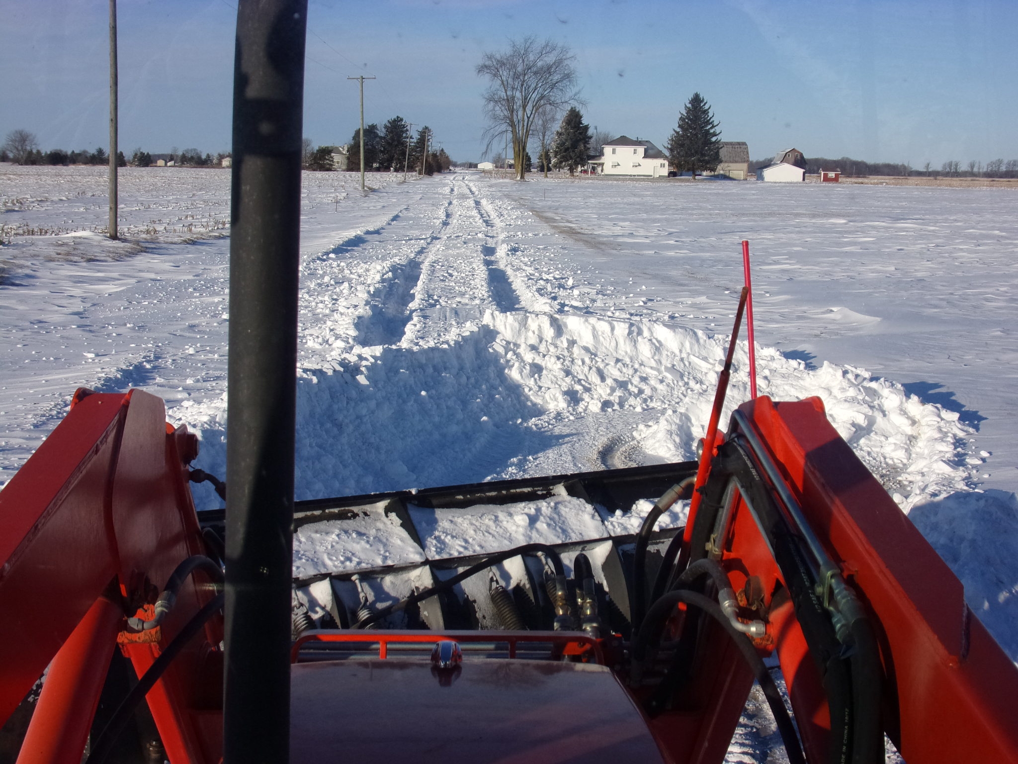

I might add that I ONLY run chains on the front and that is for the plow so it don't 'plow steer' the tractor when busting big snow. Nothing on the rear and no filled tires either. I'm a solid 2 miles from the pavement with a terrible road commish, so I plow myself (and the neighbors) out regularly.

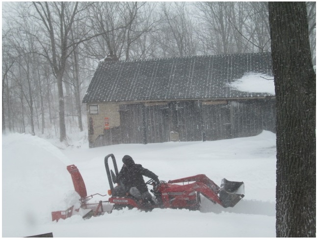

   / HP For Snow Blower #54
The TYM can handle the blower. I run an Agrotrend 48" with 19HP at the PTO without issue. Being a SCUT, the thing to look for are the size of the 3 point hitch pins, and the length of the PTO shaft when the blower is raised. Mine had to be cut down as it would bottom out when fully raised. Engaging the blower while raised produces a lot of sheared PTO shaft pins due to the angle.
The 500lbs sounds like an easy lift, but it extends quite far out from the tractor. You will lose a bit of traction and steering control on the front wheels.

   / HP For Snow Blower #56
'View attachment 826227
Another freeze your tush off experience in snow blowing. Candidly, I'd never do that with my open station. Cab with heat, am-fm and air ride seat is much better.

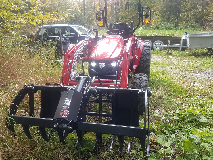

Had to travel a little to get the new machine.
Picked up this morning at the dealer. 2024 T25
Got it home.
Would probably be surprised what this set up costs in Canada, but other brands are even more (according to my
shopping before hand.) No, I'm not telling. :) It's embarrassing.
   / HP For Snow Blower #59
You'll miss the cab, but everything else about the TYM will be more user friendly; you're never going to regret the purchase from that perspective. On top of that, you're getting a Yanmar diesel without the premium that comes with joining club Yanmar. Great engine.
