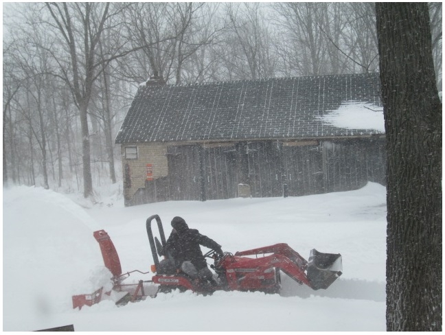

I run a 60" Braber on my Kubota BX2200. Never any issues with 3'+ snow.
I also run a 62" Woodmaxx Flailmower on my BX2200. Mowed 3'+ grasses without issue.
Would I like a bigger machine? Of course, but my BX2200 hasn't complained about lifting or turning those two heavy implements.

I modified a 50" Front JD blower to be a three point rear for my new JD1025R. It works just fine, though sometimes I will go extra slowly, or make two passes, as said before, first a little high, then a second to clean things to the surface. If the tractor you're using is hydrostatic, a larger than normal 3 point blower is fine, as you can regulate the speed infinitely. It's the three point blower on a manual transmission tractor which can offer you little choice in blowing speed.
I would not bother loading tires, use ballast weight instead, or better yet, a blade on the front, and blower on the back. My first tractor had loaded tires when I bought it, and the rims rusted out really badly.

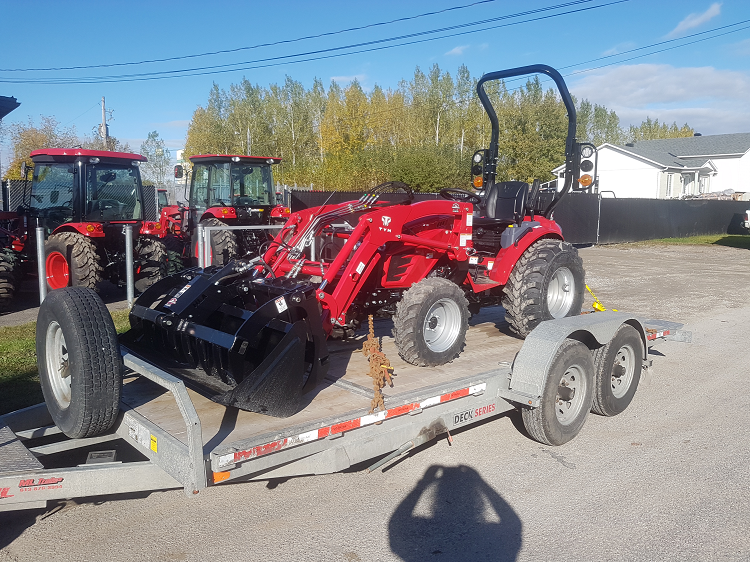

Had to travel a little to get the new machine.
Picked up this morning at the dealer. 2024 T25
Got it home.
Would probably be surprised what this set up costs in Canada, but other brands are even more (according to my
shopping before hand.) No, I'm not telling. :) It's embarrassing.
