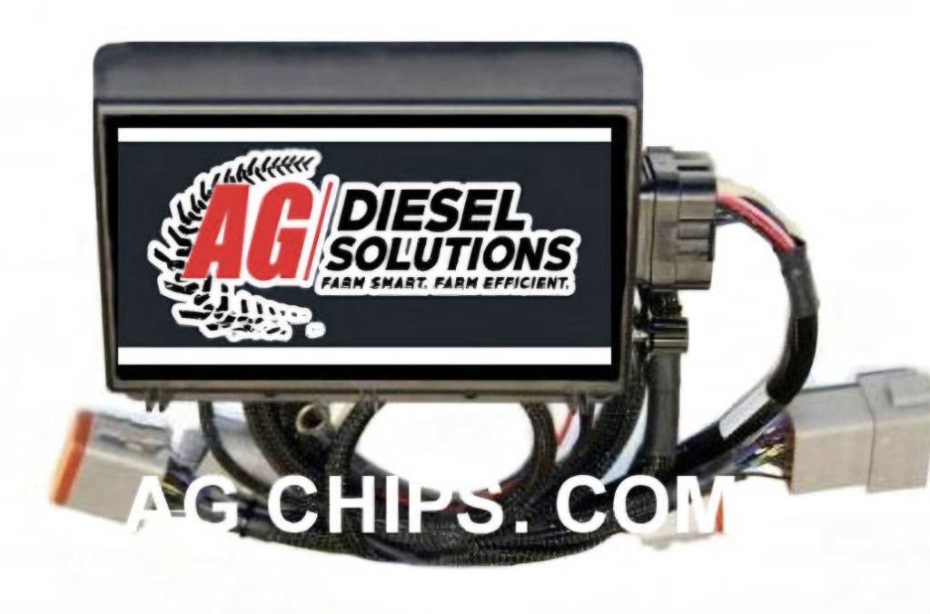

I believe this was discussed before, but for $595 AG makes this performance module that's supposed to add 30% HP & improved fuel use. Anyone with experience, is it worth it, increase power, any other modifications needed, etc.?
Thanks
I have a 2018 JD 3038e.

If it's a mechanical injection pump, no, you need to mess with the pump, not electronics. If it's an electronically controlled pump, sure you can spray more fuel in for more power. As long as you have enough air & can keep it cool enough. No way you save fuel & increase power at the same time. Anybody that tries to sell you something that does both is selling snake oil & I wouldn't trust any of their claims

Sounds to me like you don't need any more engine power, you need to increase the hydraulic pressure slightly so you can pick up those bales. Much easier to do and much less expensive as well. All you need to do is locate the hydraulic check valve for the loader, remove the spring loaded check and add ONE shim. That will increase your lifting capacity enough without altering your fueling parameters at all and increasing engine power will do nothing for increasing lift capacity at all. All it will do is shorten the life of the engine and burn more fuel.

The device will do nothing to help you with your situation to get a little more lift out of your tractor. If you need some more PTO or drawbar HP it might work. On the green forum people claim they have seen noticeable performance increase in the 3025e.
If you need just a little bump in lift capacity. There's two options. 1. You can replace the loader cylinders with ones that have a larger bore or you can adjust the relief setting on the valve body. An increase of even 100 psi will give a noticeable difference.
Whats happening is your hydraulics are going into relief. Hp has nothing to do with it hence why the 3025E and the 3038E have the exact same lift capacity.
