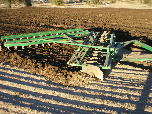

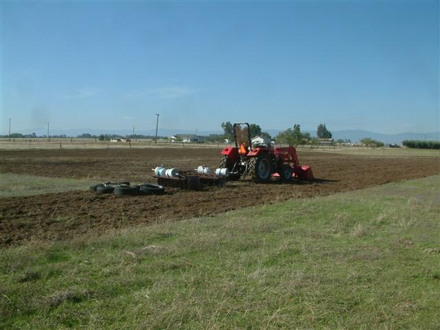

Ken, any pictures? I would say that most people here on TBN have no idea what exactly a John Deere 12 ft AW wheel disk is. I know that I don't.:ashamed: So some one reads your post and sees that your pulling a 12 foot disk with a 46 hp tractor, and thinks, hey here's a dealer and he pulls his 12 foot disk with a 46hp tractor, I'll find a 12' disk and I'll do the same thing.
I doubt that your 460 would pull our Kielfer 12' offset disk with 22" blades.

I know it won't pull it unless the wheels are all the way down. Matter of fact our 460 wouldn't pull a 6' Amco offset disk but our older less powerful Case SC would but it couldn't pull it fast enough.:laughing:
About that time I made the major purchase of a 3020 diesel and our problems were over. My dad bought a 4020 and we were in business.:thumbsup:
