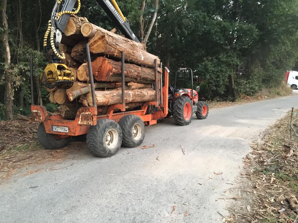

Along with the commentators on the Youtube, I think most of you missed the point.
He was only showing the HST puts indeed less power to the ground. The fact that the Geared tractor can spin the wheels in High Range and the HST can't, says it all. It just sits there and whines. What's the point for putting both tractors on Low range? Just so see wheels spinning? And yes, Neil said in the comments that he'll do the same test on a hard surface and similar tractors.
For the those that say that you don't do any tractor work in High Range, quite often fields are plowed in 1st gear High Range, where a HST would fall on its face with a lot of noise behind. Another one is the picture I'll add, would an HST tractor pull this trailer on a hilly road without having to fully stop and messing with ranges? Definitely not. The Gear tractor just downshifts on the move a gear or two.
