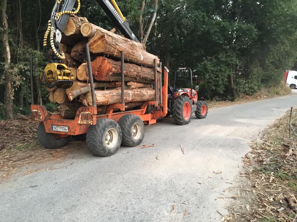

For the those that say that you don't do any tractor work in High Range, quite often fields are plowed in 1st gear High Range, where a HST would fall on its face with a lot of noise behind. Another one is the picture I'll add, would an HST tractor pull this trailer on a hilly road without having to fully stop and messing with ranges? Definitely not. The Gear tractor just downshifts on the move a gear or two.
That load of logs isn’t something I would pull with my tractor on hilly terrain. Ever
Yeah, but it's something done quite frequently over here. Small loggers and firewood sellers use 40 to 50 HP tractors and have to road the tractors and trailer fully loaded a lot.
