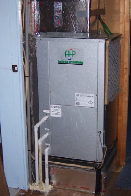

I'm on my second home with Geothermal Heat Pump. I have installed both myself including putting in the wells for them. I put the first in my last house in 1980 and sold the house in 1999 with it still working great.
I put my current one in two years ago. FHP Manufacturing - Water Source and Geo-Thermal Heat Pumps They are self contained, add water, electric and duct it to the current duct system.
This one, a 3 ton is rated at 21 amps with a 19.9 EER on cooling, 4.2 COP on heat with 65* water. I took out a 4 ton air to air rated at 60 amps.
I would not use the well for discharge, there would always be a chance for contamination. I can discharge to water my grass or put it into a drainage ditch.

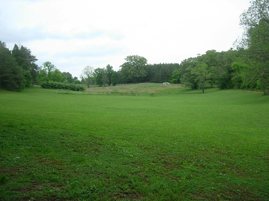

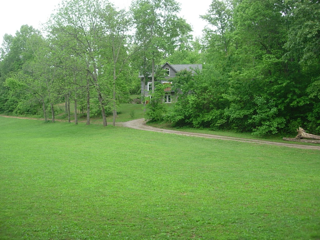

Here's a picture of the field in front of my house. View of field and house and then a turn to the left to see more of the field. I might add that my power line is buried right in the middle of the gravel road to the house. Furthermore, from the transformer (which you can't see but is a bit left of the driveway) to the house, the wire is buried and travels FURTHER to the left going all the way around my yard (around the septic field) and to the meter box.
Any water would have to travel out of my garage which is on the right side of the house, so there is no way I can get to the field without taking a water line over the power line.

You don't have to buy the field. You could get a written easement to use it to bury your lines and then have it state what can and can't be done on the field that might tear up your lines. However, the most certain way to control the use of the field is for you to buy it so you control its use.
Other option is to dig a deep well and run your lines vertically on your own site. But I think you'll run into the same question of contamination of your well water. I think you're going to have to research that more before deciding whether to use your existing well or dig another one or go out in the field. If the system just uses water with no additives, then that's one thing, but you don't want to discharge any additives into your well. Could you add a filtration system to your potable water lines and still discharge in your existing well?
I thought you had to take the line under an electric line, but I think there may be some code issues you'll want to sort out.
