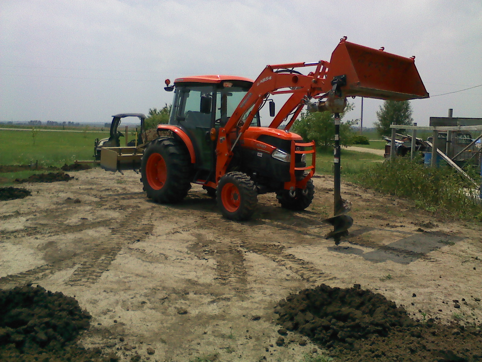

Had landpride HD25 a long time. works great

Hydraulic PHDs are sweet. Hard to go back to pto once you have one. However, you need enough flow and PSI to make them work the best. Lack of flow is the reason most smaller and mid sized CUTs don't handle them well. I also tend to turn my CUTs psi up to 2800 to get more torque.
/ Hyd post hole digger
This model is 5-12 gpm, works well on a almost 10 gpm tractor. have 9", 12" and 15" augers
