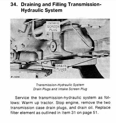

Be aware JD 830 utility tractor has open center hyd system. How many hrs of use since hyd filter was changed & hyd oil suction screen checked/cleaned? I suggest to check hyd system pressure which should be around 2000 psi.
