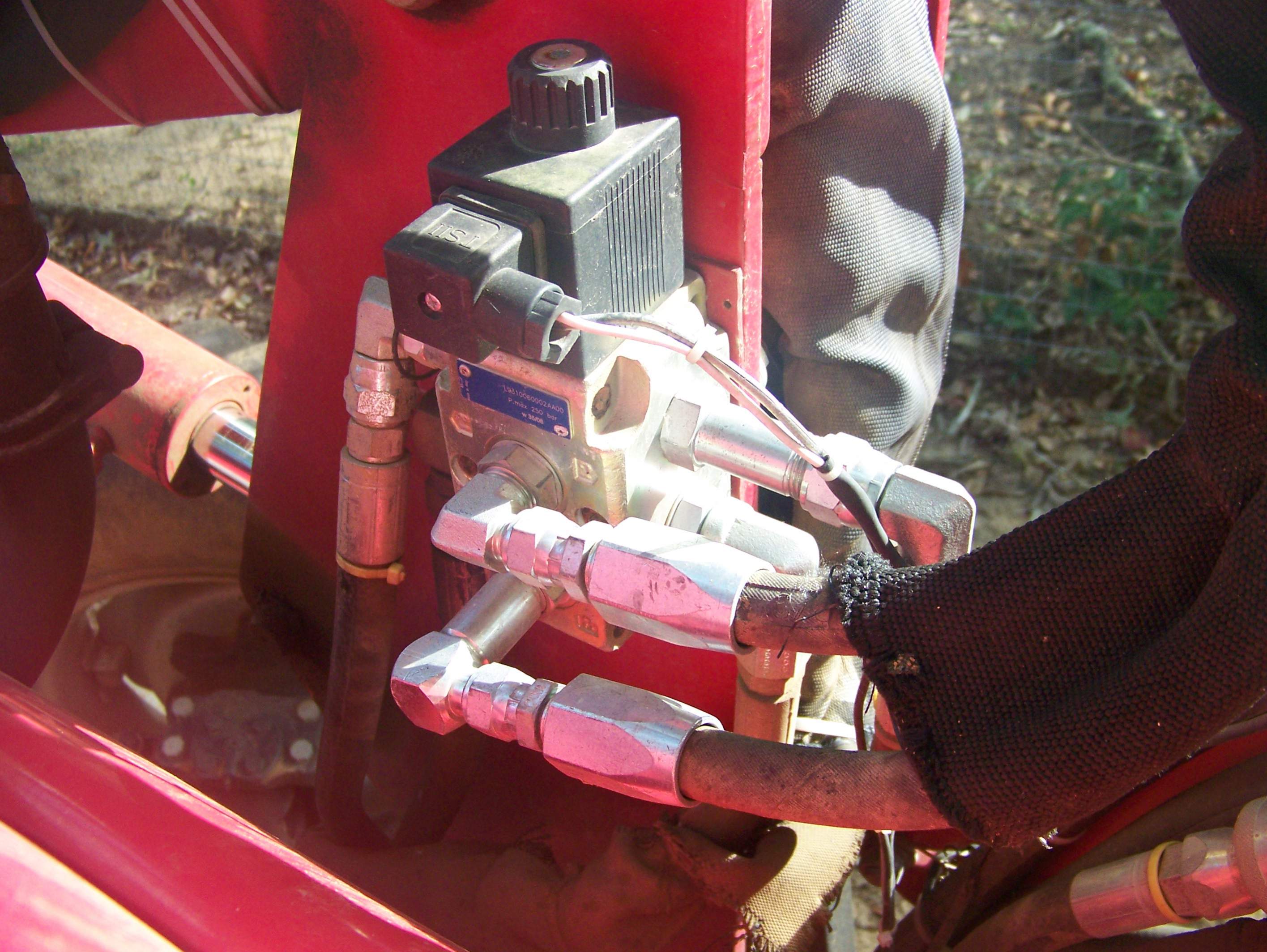

Thanks for the input and photos. I have plenty of room forward of my loader valve on the mast. So that is where I bolted the valve. I have plenty of clearance, even hood clearance. The knob switch is all finished and the wiring harness ready to install. I extended the threads on the shaft for a jam nut.
Just ordered fifty something dollars of SAE fittings for the valve installation. I ordered extra of different fittings to make sure I have what I want when I move lines.
Oh yeah, the white thing on the valve is a rubber glove I used to keep metal shavings out while marking holes. The blue fittings are aluminum AN fittings and caps, which are the Army Navy version of JIC. Those are there just to keep metal shavings out also.

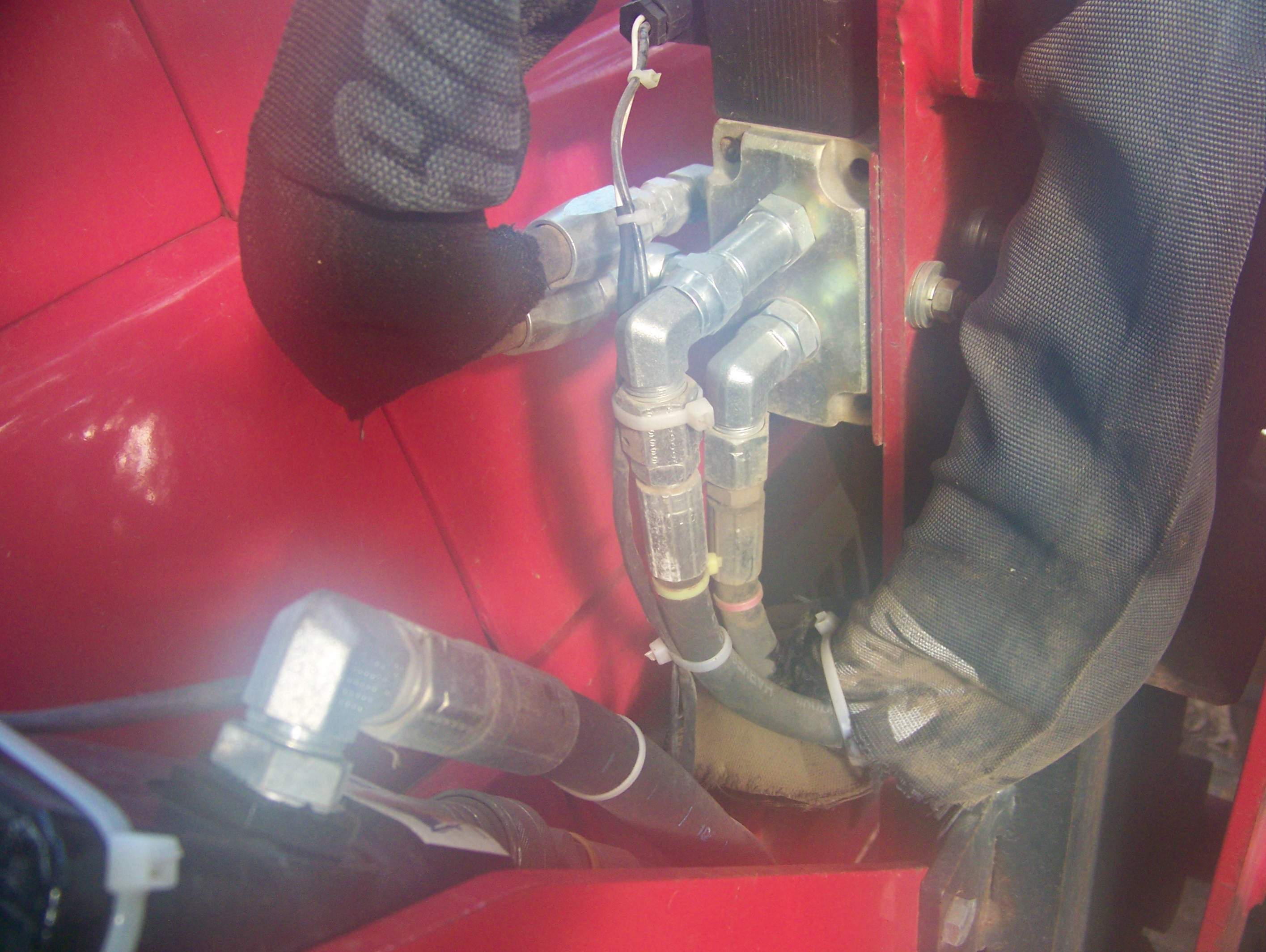

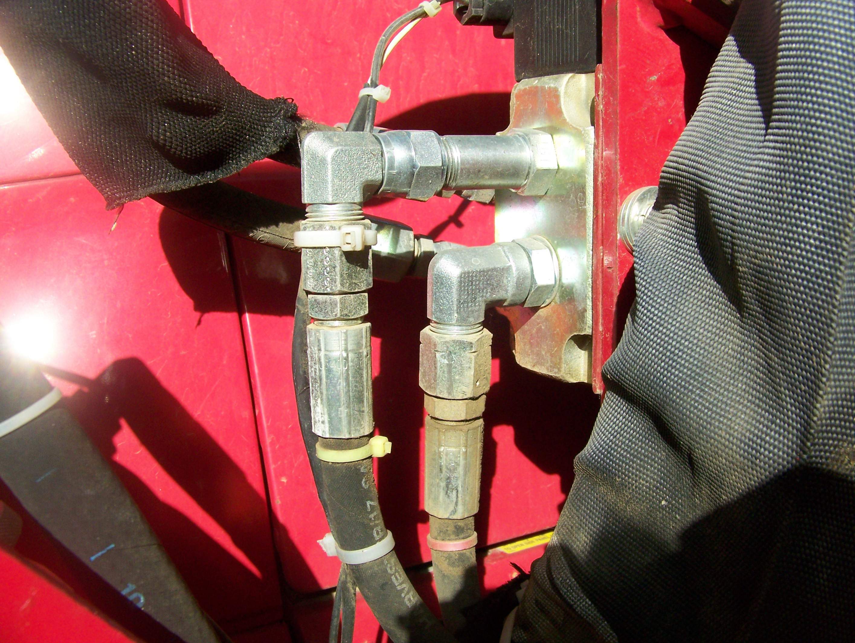

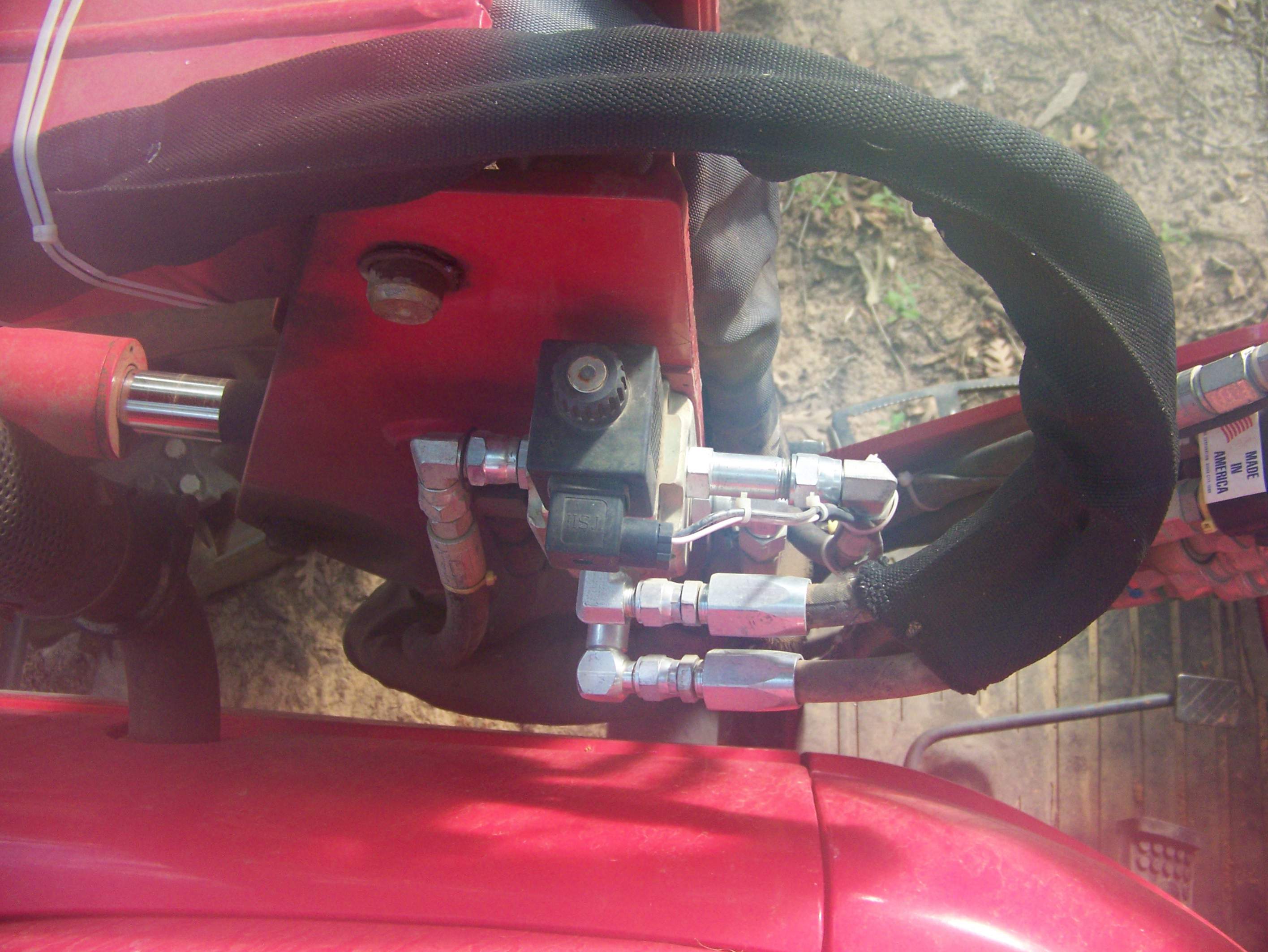

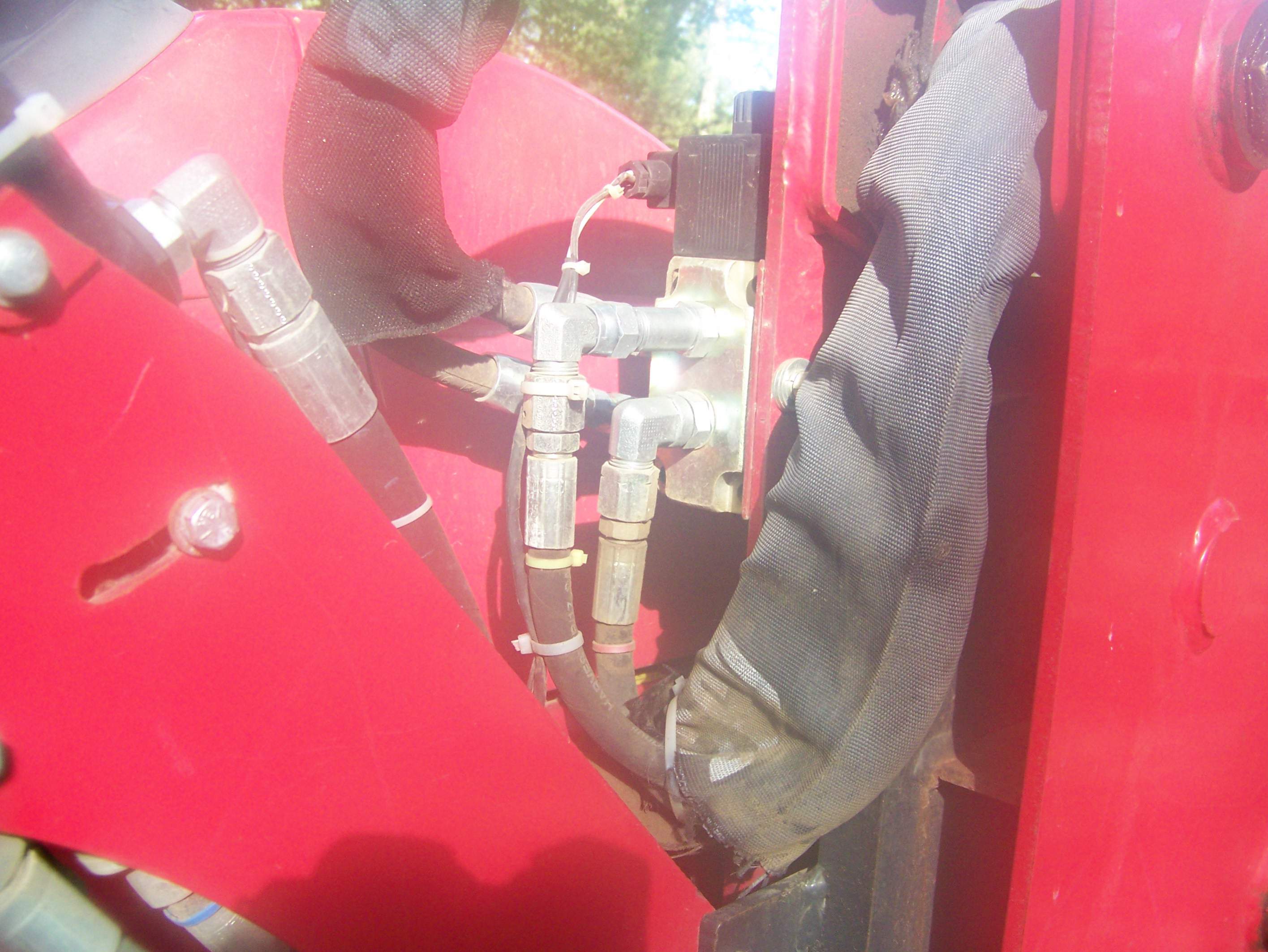

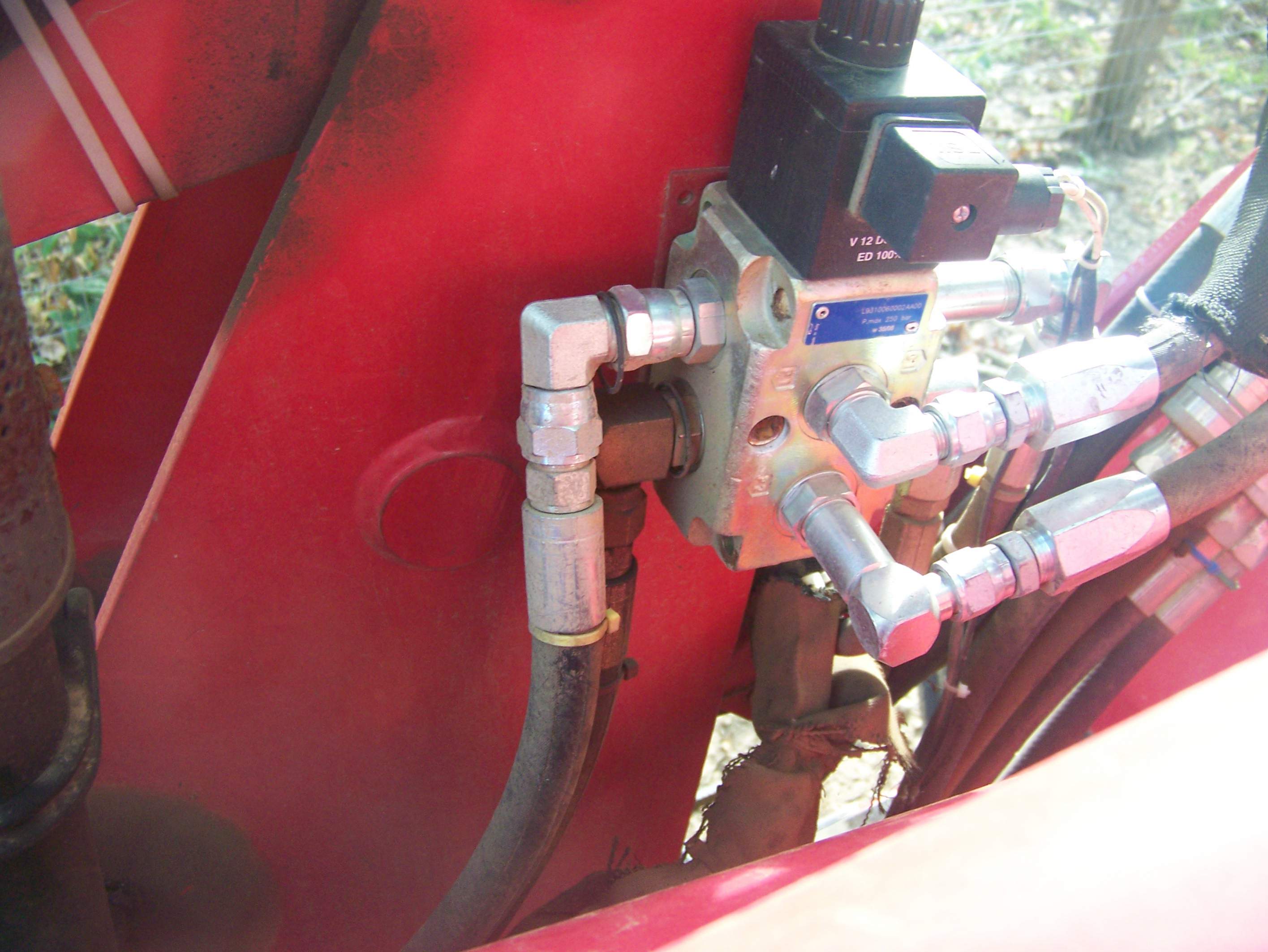

Sallyb,
Since I didn't have anything to do but take a bath and go to bed, I decided to snap some more photos of my valve installation. Here ya go......Diverter Valve 6.jpgDiverter Valve 5.jpgDiverter Valve 4.jpgDiverter Valve 3.jpgDiverter Valve 1.jpgDiverter Valve 2.jpg

Milky fluid means water. My tractor has a suction strainer screen down inside the transmission/read axle area and it can collespe. That might be your problem with no 3PH lift. Hyd. fluid level could have been low also.

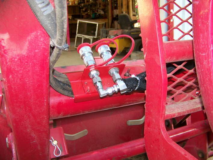

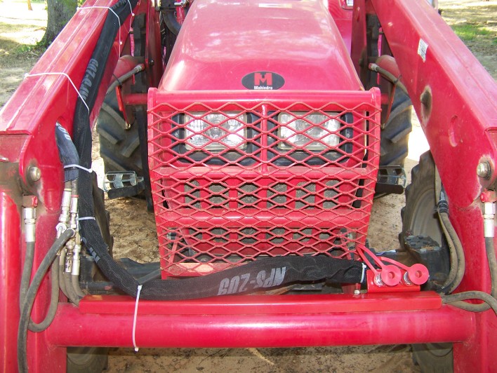

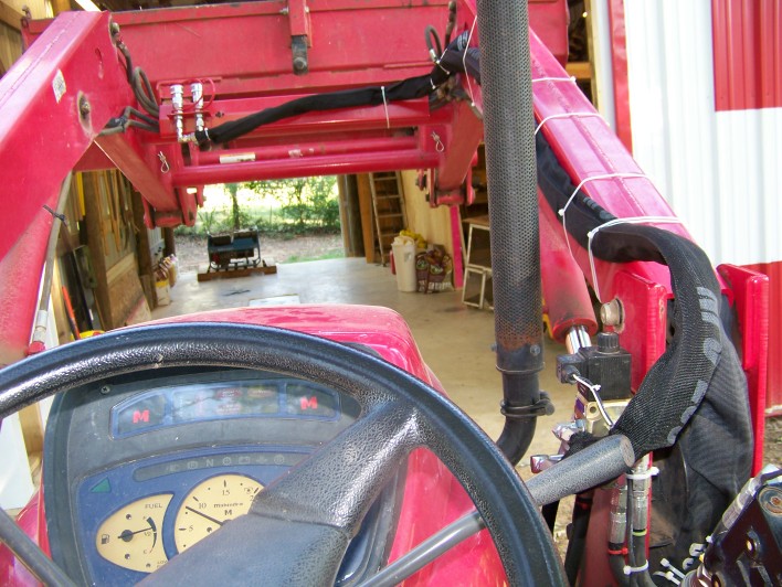

I first mounted the valve. Then I ran electrical. Then mfg. QD mount and installed it on the hose cover on the crosstube. Then I hooked up the lines and figured out fitting styles and locations. You can hang the grapple to see where the grapple lines reach and are out of the way to figure out where the QDs are to be installed.
I did not use power beyond. I ran the dump/curl hoses from the (joystick) loader valve to the diverter valve. Then ran the dump/curl lines from the diverter valve to the dump/curl cylinders. The grapple open/close lines were ran from the diverter valve to the QDs I installed on the loader's crosstube line cover. 5-26-12 Lines Running Up Loader Arm.jpg5-26-12 Lines Attached to QDs.jpg5-26-12 Diverter & Lines from Driver's Seat.jpg
