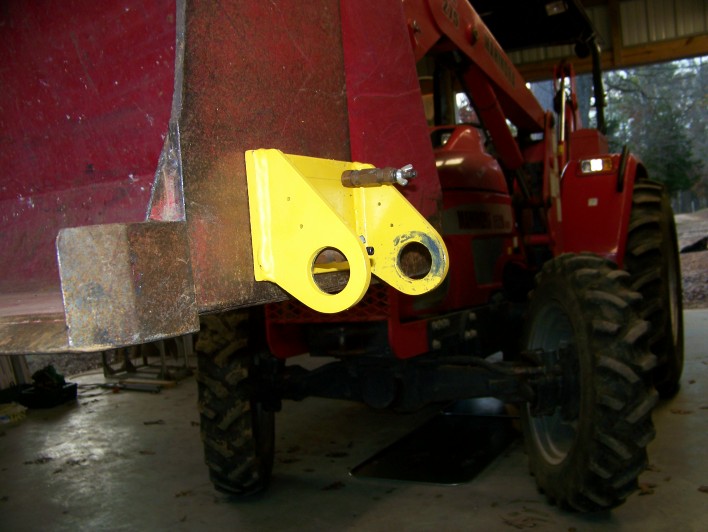

Back in 2007, when I bought my Mahindra 6520 and 511 Backhoe, I modified the backhoe to run the Danuser Hydraulic Auger. It has worked well on the backhoe since then. Now, I want to run some new fence lines and have decided to move the auger to the side of the loader bucket.

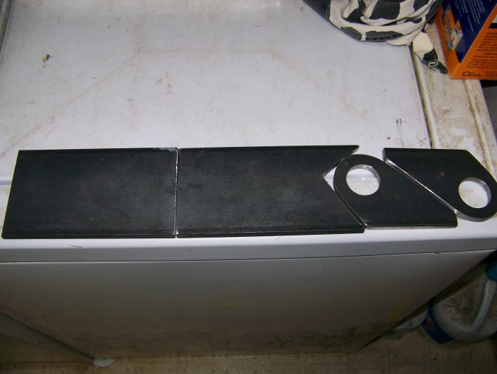

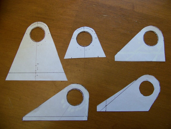

I drew out a lot of different paper designs until I finalized the design. I wanted it to hang a little low, but the bolts had to clear the bottom of the bucket. Thus the off set, low slung rake.

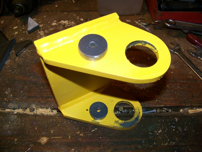

I decided to go with 3/8 inch 4 inch wide plate, as the bracket that will hang from it is 5/8 inch thick. I cut the pieces out with a 3 inch cutoff wheel on a high speed grinder. It took some time, but it took little grinding to get it cleaned up and looking production made. I drilled the 1 & 3/8 inch holes with a hole saw on the drill press at work. That took a while also.

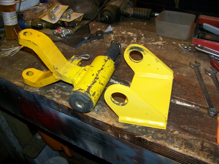

I had to go to my local welding shop, as I do not have a welder. Besides, 3/8 inch thick takes a bunch of welder. I showed the shop manager how it needed a washer inside the bracket for loose fit after welding. I didn't get to watch because of insurance. Anyway, I painted it at the shop while the mount was still warm. I got it home and tried the auger motor's adapter bracket. It barely fit after the paint was removed. Seems the welder took the washer out and now the fit is tight with paint. As you can see in the photos, the paint has been scraped by the adapter bracket, when I tried it out.
Hopefully next weekend I will get it mounted on the bucket. I need to figure out if I want to tap the bucket for threads, or just drill holes and use nuts on the bolts. I am leaning towards tapping the holes, but time will tell.

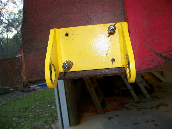

I located the mount on the bucket and drilled the holes out to 1/4 inch today. I am stumped on what diameter bolts to use. I was thinking 3/8 inch bolts, then though maybe bigger. The metal thickness is 1 & 1/8 inch. Do Y'all think I should go to 7/16 or 1/2 inch bolts?

I see you are using 4 bolts, I would use 1/2" grade 8 bolts (available from Tractor Supply) and lock nuts.
CJ222,
Grade 8 for sure. One vote for 1/2 inch. Thanks. I think it would be awesome to find a countersink and use plow bolts. The bucket sidewall was easy to drill. I have 8 of them for a grader blade project for the backhoe that came with the cutting blade I bought.

I think I misread your post above. The yoke is 5/8 inch thick and supplied with the Danuser Auger, so I am sure they engineered enough strength to resist twisting even in rocking ground.

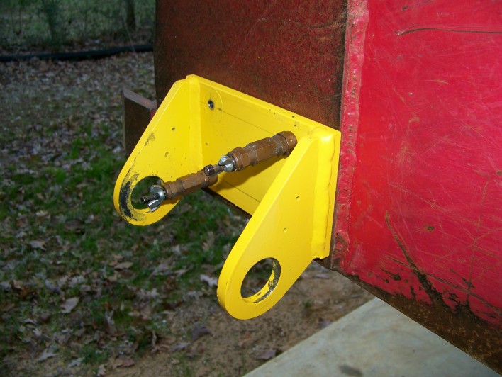

I bought the grade 8 hardware today at Lowes. TSC was out of all 1/2 inch bolts. I now realize that the welder did weld it up with the washer in. The fit problem comes from a very basic no-no from welding 101............Use equal heat on both sides of a flange. As it is, the flange leans in on the forward end. After drilling the bolt holes out to 1/2 inch, I took it all apart and put half of the hole of the forward flange on the bench grinder. Now it falls apart when I pull the pin. All this drilling went quick with my 18 volt Makita cordless drill and a good bit that was continually dipped in Boelube.
Saturday I will mount the motor and gearbox on the mounts.
