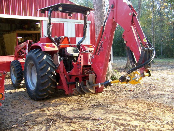

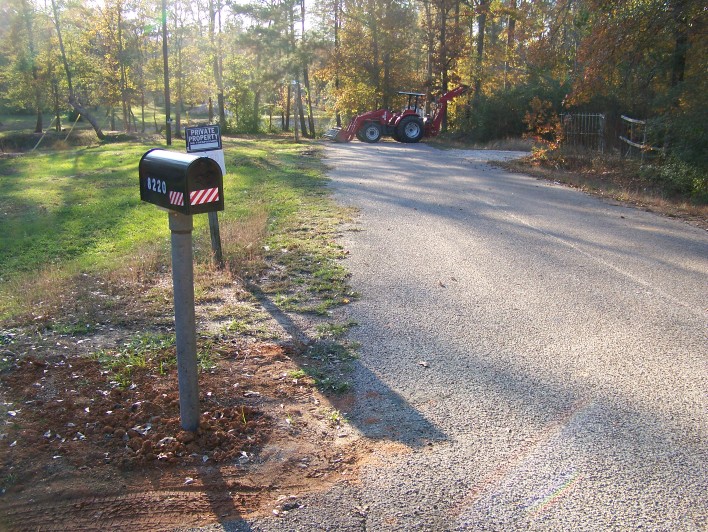

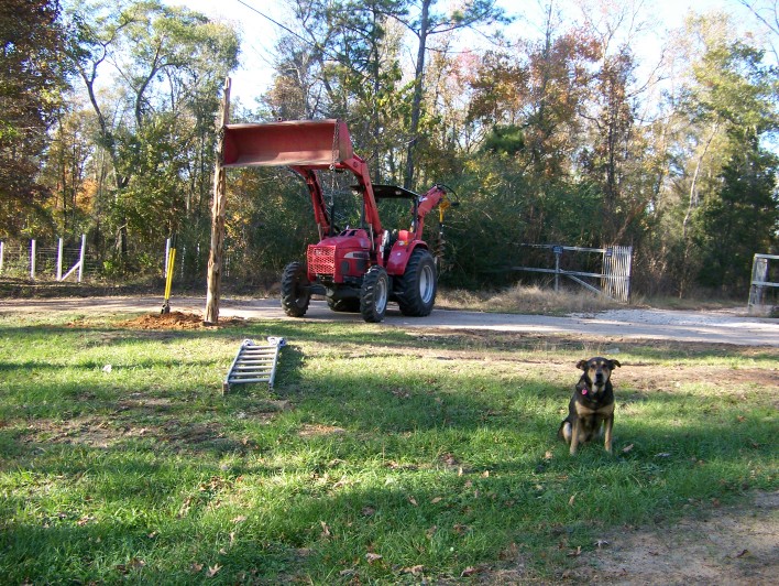

I augered the hole for this mailbox with the auger motor mounted on my front bucket a few weeks ago. I augered the post hole in the second photo with the auger mounted on my backhoe, yesterday. I used a 9 inch bit on the mailbox and a 12 inch bit for the cedar post. The backhoe position is so much easier in operation and the 12 inch bit worked better and faster there. The 9 inch bit on the front end loader did not work good and was really slow. I have 3/8 inch lines to the backhoe and on the loader up to the curl circuit lines. So my rear remotes and backhoe get more flow and/or pressure that the loader curl circuit. Now that I tried both in the same soil, I will use the auger in the future on the backhoe.
Oh yeah, the third photo show how I secured the auger to do some loader work grading the driveway.
hugs, Brandi
