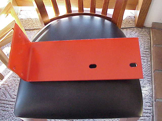

The only problem with 360 degree rotation is the chute deflector hydraulic hoses. You have to sacrifice some things for other converniences... /forums/images/graemlins/grin.gif /forums/images/graemlins/grin.gif /forums/images/graemlins/grin.gif Here is a picture of the bracket that mounts to the snowblower. I took it off last evening so I could paint it. If the temperature would get a little warmer, I would have more motivation to bolt everything back on. I have about 30 minutes work, but in a garage at 12 degrees, I just don't want to do it. I think that the wrenches are about -12 degrees when you put them in your hand. /forums/images/graemlins/grin.gif /forums/images/graemlins/grin.gif Besides, it will give the paint an extra day to dry... Junk....
